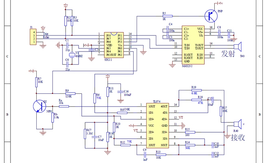

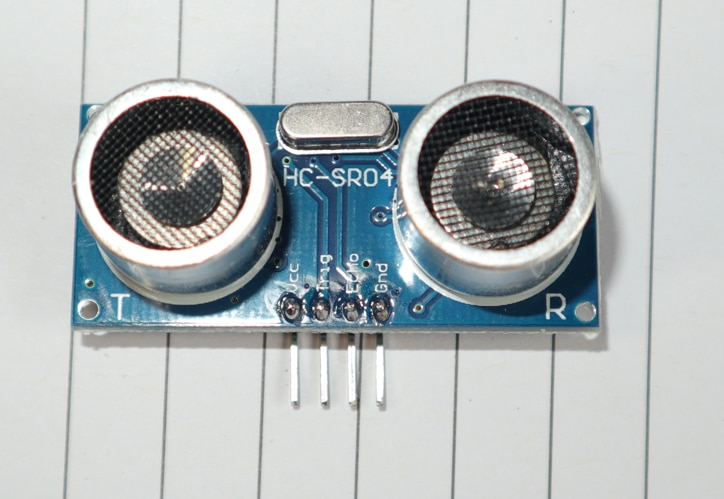

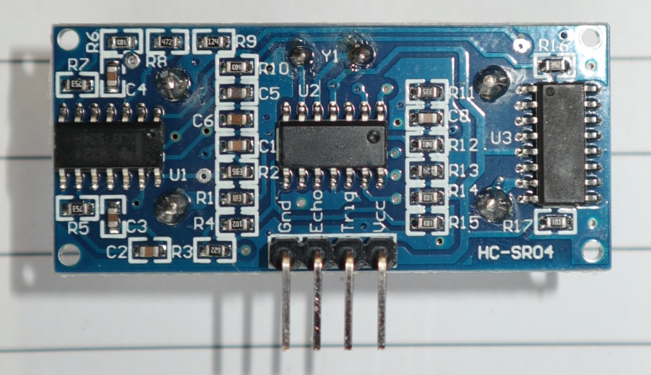

I have a few no-name 40khz ultrasonic distance sensor modules (HC-SR04) laying around.
I purchased them a few years ago, but they still seem to be for sale.
They appear visually similar to the original sensor module.
I thought I might scope some on board signals and maybe Frankenstein my own with a Pico, but I haven't gotten that far.

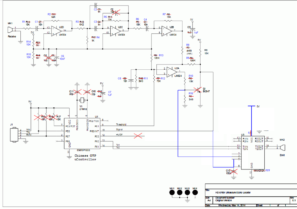

I searched for a schematic online, and came across the following
Schematic credit : https://www.researchgate.net/figure/Circuit-diagram-of-HC-SR04_fig2_334627562

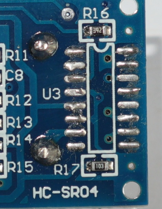

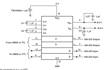

Only one of the chips on my module are marked, the leftmost chip is an lm324. The center chip is presumable the mcu and the rightmost a max232.
Looking around the "max232" there isn't a single capacitor, not even a decoupling cap, let alone the charge pump caps.
Hmmm. What is it?

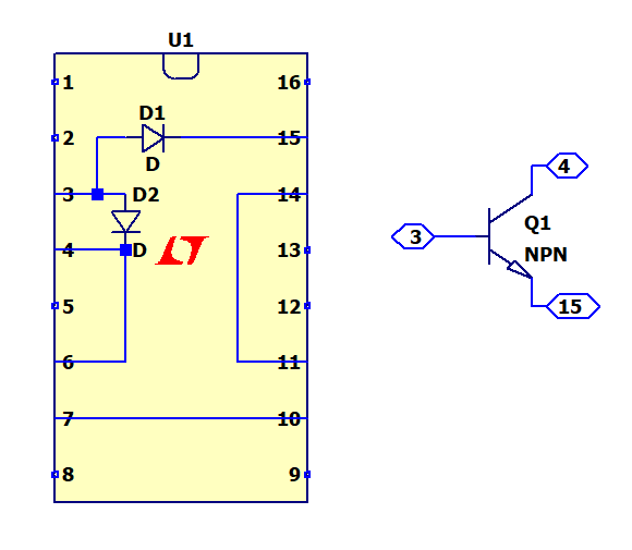

I pulled the chip off
Testing the chip out of circuit, I measure a zero ohm short between the input and output pins of the output driver (pins 10&7, 11&14)
No parasitic diodes from io pins to ground, resistance between vcc and ground measures open-circuit.
So far it looks like a pointless chip, just 2 jumper links in a 16-smd package.
I have nothing against simplifying or economizing a design, delete the max232 transceiver all together.
Don't put a bubble gum chip on the board.
Anything I should test before sanding the chip down to see what's inside?

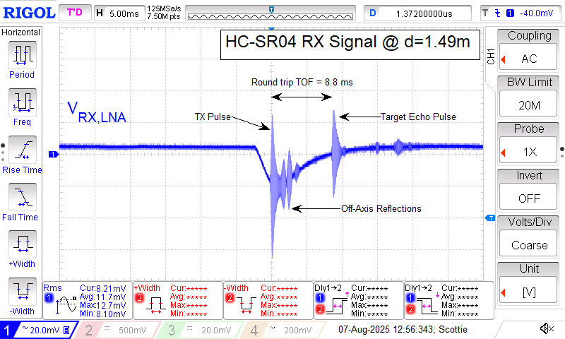

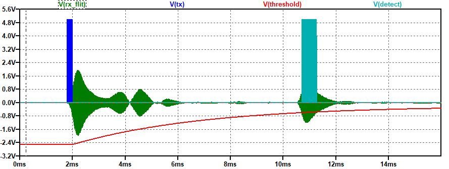

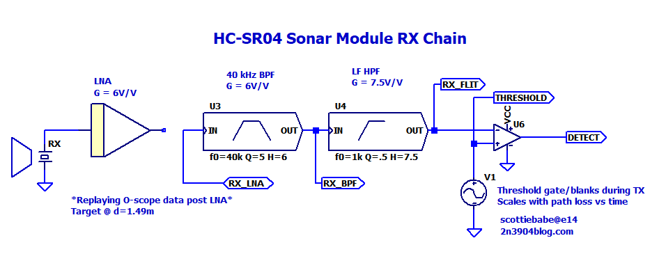

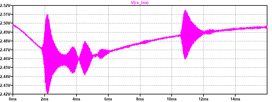

    From o-scope to simulation

    It is equivelant to Q2 on the first schematic.
    After some more searching I found a blog where someone else documented the schematic of this board
    https://hw-by-design.blogspot.com/2018/07/ultrasonic-module-reverse-engineering.html
    Addition discussion of the original module:
    web.archive.org/.../Making_a_better_HC_SR04_Echo_Locator.html
  • beacon_dave
    beacon_dave over 1 year ago in reply to anniel747
    Ah, is it Q2 on the left hand side of the schematic ?

    Looks like it is connected to the charge pump capacitor pins if it was a MAX232 pinout but looks like the PCB traces may suggest otherwise.
