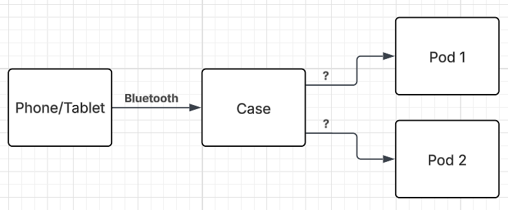

Hi all!  I was fortunate enough to have come across the Learning Circuit playlist, and have learned a lot over the past few weeks.
I am trying to build a project that has a wireless hub-and-spoke model. A hub will be connected to a phone/tablet via Bluetooth. The hub will control two "pods" wirelessly to control a motor, LEDs, simple speaker, etc. It would be a similar structure to wireless earbuds that are controlled by the case.
What would I need to do this? Would a Bluetooth connection be appropriate for connecting the pods to the hub? Is there another wireless technology that would be better suited for this?
Below is a diagram of the structure.
Thanks!

    You should also consider the SDK. There's little value having an MCU that you find is too difficult to program.
    For dev boards, you cannot go wrong with the SeeedStudio Xiao product range. Offer all of the above.

    You can't get a BLE module, whether it is a microcontroller or not, much cheaper or smaller than an ESP32.

    It looks like this could work for my project.  However, I wonder if having a full microcontroller in each pod.  Are there other "smaller" or simplified BLE microcontrollers that I could use in the pods?  In my novice optinion, a full ESP32 seems like it might be overkill.  It wouldn't require any memory or processing, other than activating pins based on the signals sent from the hub.
    I'd want to control a motor (possibly through a DRV2605L), RGB LED, and a speaker.

    A microcontroller can be both a Bluetooth client and Bluetooth host or server. (BLE)
