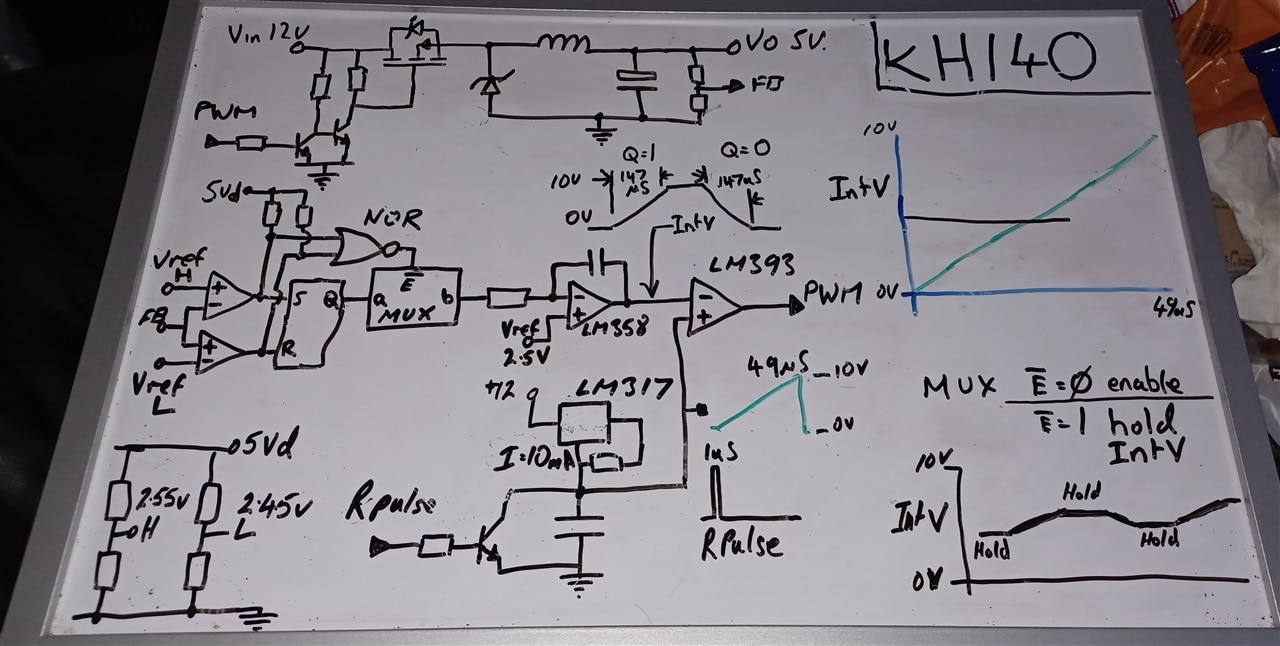

Any one attempted to build a simple descrite, switch mode power supply

    Nice.  The Set/Reset flip flop and surrounding circuit reminds me of the guts of a 555 timer.

    My weekend build, see how this does. 12V to 5V buck with an off the beaten path topology, none standard

    dang74 8 months ago in reply to Knighthawk_140
    Either way, it will be interesting to see what you come up with... if you allow yourself to use opamps and comparators the potential to build something cool will be there.

    Knighthawk_140 8 months ago in reply to dang74
    Lol, I have not quite decided on the Topology yet, just to correct you, my adc used a LM1117 adj in CC mode, and not a BJT.
    this is going to be another I was bored at home, so I made a descrete switch mode power supply.

    When you say discrete do you mean limiting yourself to transistors?  I seem to recall that your recent ADC project has a ramp generator built from a BJT.  I suppose you could use that to drive a MOSFET switch connected to an inductor.
