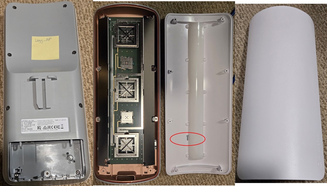

I recently purchased two Mikrotik mANTBox ax 15s outdoor wifi antennas, to expand the wireless coverage on the job site. One of the antenna, out of the box, came with a rattling noise.
I ordered the units before I went on holidays, believing when I returned in three weeks, I could start the install. Well add an additional two weeks after my return to the delivery and you soon discover why project schedules are rarely realized after first contact.
On hearing the rattling noise after unpacking the unit, I did a quick inspection to find no physical damage. With the project already behind schedule what to do? After some soul sucking solution thinking consternation, I chose to ignore the rattle and proceed with the project. Anyone worth their salt could argue my choice was wrong for a number of reasons.
Thinking I could ignore the issue didn't make for a restful nights sleep. The next morning, while forcing myself to suppress all the thoughts of why investigating the issue was a bad idea, I found a hex driver and broke the warranty void seal.
The manufacture had gifted a M3 sized "rattle" screw [red circle]. I didn't request the option. I found no hole missing such a screw. I did find one screw head larger than the other five. My speculation, the assembler discovered they were one screw short and found a replacement (i.e. larger screw head) to meet their quota, not knowing the missing screw was hidden somewhere inside the unit.

    I've heard of the free floating SMD component before. I would be curious in a manufacture facility is there a shake test done on PCB's to confirm mounting.

    In the UK rattlesnakes are not common so it's fairly safe to investigate most rattling noises. My last one was an SMD capacitor that had decided to escape from the board.

    If the screw had of lodged itself on the antenna assembly I suspect the BZZPT that Kmikemoo speaks of would have generated smoke. The RMA to return the unit would have added more delay to the project.
    I say I ignored the rattle but in fact it just took me a while to come to grips with what needed to be done.

    colporteur Good call on giving into your need to investigate.  One never knows when a slight bump turns that rattle into a BZZPT!! - and the magic smokes exits the enclosure. Thumbsup
