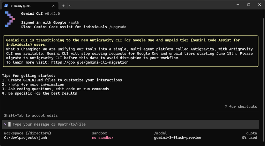

    Recently I found a magazine called Code, and got a subscription. It's not bad. The latest issue which I received a couple of days ago, has six main articles, of which three are AI-related. I tried one of the articles, which teaches how to use Gemini. I decided to try it for a MSPM0L1105 microcontroller project, which is to create an I2C-to-RS485 converter. Gemini is being used in a mode where it takes almost full control. It has access to a folder you choose, and it takes its instructions from a text prompt. Here are some screenshots.
    When started up, this is the text prompt:

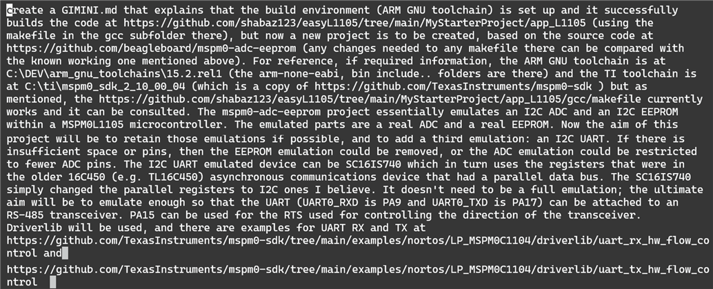

    According to the magazine article, it's suggested to create a GEMINI.md file containing all your preferences/desires/coding style etc. I decided to type in the text prompt for gemini to create that GEMINI.md file itself, to contain the detail regarding the project I wanted. This is what I typed:
    It went and did it, and then prompted me to accept that change.

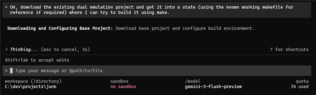

    Now I figured it would be good to get to a baseline, where I could compile at least something, before adding in the new functionality:

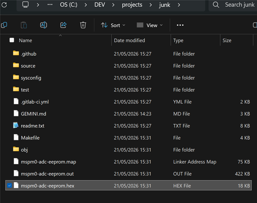

    Gemini went off and downloaded the appropriate code and made any necessary changes to the makefile, and it couldn't find my make.exe, so I then told it where that was in the text prompt, and then it built the code. Now the previously empty folder in which I had run Gemini originally, was full of this content:

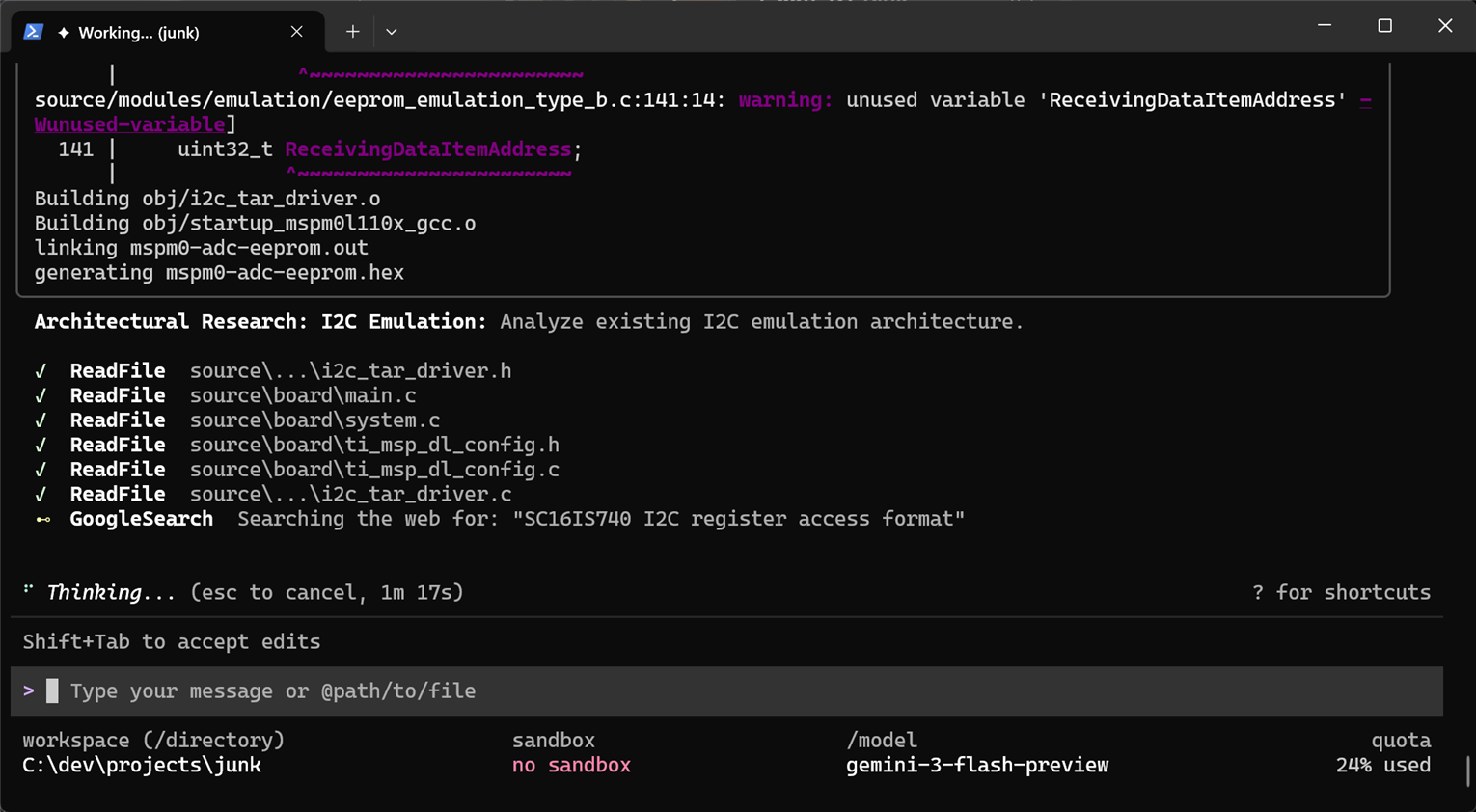

    Then I told it to make a change to the makefile to fix a 'make clean' issue (I pasted in the error I was seeing) and it fixed it, but it was quite trigger-happy, it went ahead and made the code changes to implement the new desired functionality.
    This screenshot shows some of the things it did by itself:
    It ended like this:
    I've no idea what bugs are in the code, but the files content looks plausible. I've confirmed I can build the code using make myself, and it does build. I'm sure I will need to troubleshoot and so on, but it's a start, and the volume of code isn't so much that I will get lost. At the end of all this, I've used 39% of my allowance quota (it's visible at the bottom-right of the screenshots), I'm using free Gemini for this test.

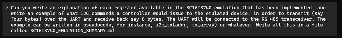

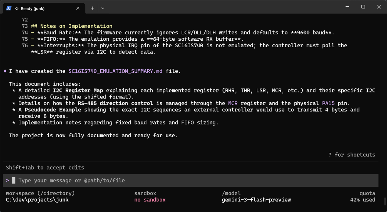

    Finally, to try to understand things, and for a couple more percent of quota:
    After it thought for a bit:

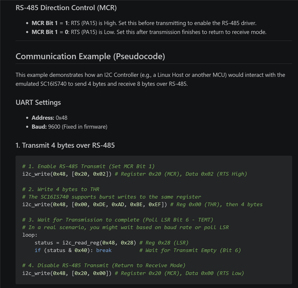

    The resulting documentation looks quite good, this is a snippet:
    I then asked Gemini to rename the project to i2c_uart_expander, and to create a README and upload it all to GitHub. All the documentation and housekeeping stuff took about 14% more quota, so I'm currently at 55%, I think this will reset to zero tomorrow (not sure). Anyway, if anyone is interested in browsing it, the project is here: shabaz123/i2c_uart_expander

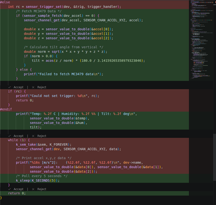

    Nice feedback shabaz I too mainly use Gemini for coding. It's what I've become used to, so I stick with it. However, I use the Gemini coding agent directly in VSCode. I prefer this to using the Gemini CLI because of the way Gemini presents the proposed changes inside the IDE. It is like a GitHub pull request. You can review each change section by section and accept or reject. You can even modify the proposed changes yourself, if you like.
    Then on the left hand panel (not shown in the pic) is the explanation and rationale.
    The only drawback I find with this approach is that the Gemini AI predictive code suggestions within the VSCode IDE is absolutely dreadful. Most of the time it hasn't a clue. So you have to reject a fair bit. But otherwise I find this a sound approach as you are the code reviewer. If it works for GitHub it works here too.

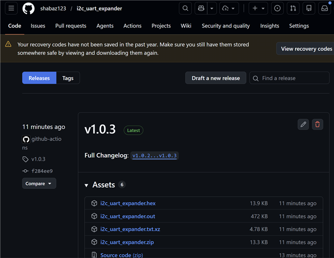

    I just learned GitHub Workflows works nicely when Gemini contributes to that too; I know Jan Cumps uses the Workflows feature, but I've only used it for one project, since it takes quite a while to create a decent workflow file. With Gemini, I just repeatedly pasted any errors into the text window, and it kept correcting things one by one.
    For anyone not familiar with GitHub workflows, it relies on a specific file that instructs GitHub how to (say) test the code, or to build it, and it can even package up or zip up the final binaries and place them in the Releases page so that users don't need to build the code themselves if they don't wish to.
    I'm now at up to 80% free Gemini quota usage, so realistically the (presumably daily) free quota is sufficient for perhaps half a day of work when working slowly, or a few hours of work when working intensively.
