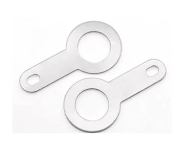

  • colporteur
    colporteur 2 days ago
    Cheapest is to find some old non-functional electronic, that contains printed circuit boards. Ready made cheap practice. Unsokder the parts.
    In college were we given a board with terminal strips mounted. The terminal were labeled A,B,C. We were to create point to point wiring using the terminals as solder binding posts.
    connect AB, CD & EF, CD & EF are in parallel and in series with AB. Putting wires on and taking them off is great practice. Doesn't require a whole lot of gear to make work.
