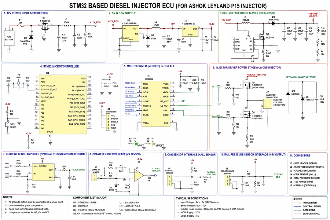

Hi there, I'm basically working in a project where we are building a dual fuel injection system. For prototyping we are tapping the injection pulse of a fuel injector of a running engine and reading it via optocoupler and actuating another injector by pulse read by a microcontroller. We used Arduino for first stage of prototype, where the Arduino gets digital input from the optocoupler and adjusts the pulse width and gives out as output in a digital pin, which is connected to a MOSFET's gate pin. The drain and source pin of the MOSFET are connected between the injector's control line.
But we need a more reliable approach, since the injector we are using is peak and hold diesel injector. Currently we referred few sources and built a circuit, which resembles something like in the image. But is there any better way to read the signal and controlling the injector pulses using a microcontroller?

    Okay, a lab experiment is fine; you can learn from it.
    One crucial point to consider is that the DC supply voltage must be clean, meaning free of RF interference and excessive voltage spikes.
    In the automotive sector, you must pay attention not only to personal safety (first and foremost!), but also to circuit safety – functional safety.
    This means that protective circuits must be implemented around the active components. This, in turn, means more component AND production effort (PCB routing, enclosure design, and much more).
    The circuit you posted here has practically no protection circuitry, apart from reverse polarity protection and an incorrectly dimensioned inductor filter.
    I previously posted the link to NXP. There you'll find application examples for the automotive sector. NXP is also a specialist in this area.
    The microcontroller you want to use is too small for your application. I would choose a more suitable microcontroller.
    This is where the circuit design begins. You don't just need to control the components; you also need to measure the voltages and currents. Therefore, you need a faster and larger microcontroller (the exact specifications depend on your precise definition).
    I'm explaining this in very simple terms, so first consider what functions and complexity are truly necessary. I'm speaking from experience, recalling my time as an electrical technician working on repairs and maintenance for the railway. Traction control was one of those tasks.
    So, my suggestion is to go back to the drawing board and redraw it.

    "referred few sources and built a circuit, which resembles something like in the image. "
    Hard to do any electronics design without using a CAD package to draw the circuit, unless you're exceptionally good at sketching manually, which is not feasible on large circuits unless you've got a lot of spare time. The circuit looks very weird and faulty as a result.

    Just had a quick look -  geralds is right, the schematic is  full of errors. !

    it seems that your circuit has massive mistakes.
    Look on the details - crank sensor, the µC to the interface, and some others. Please check it.
    https://www.nxp.com/products/MC33816

    Well your circuit.png is just a pretty picture at the moment. You haven't give us any details. I'm assuming, based on your 11. Connectors list, that J2 is output and J3, J4 and J5 are inputs. From the look of things J3 is the key one.
