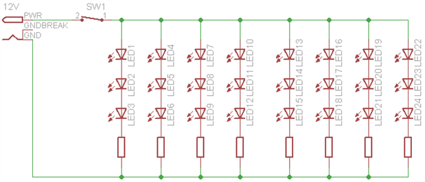

Hi sorry this is probably really basic stuff for you guys I have 3d printed a design and want to light it with some 3mm leds I have seen with a forward voltage of 3.3v , forward current 30MA , reverse voltage 5v, would like to use 24 of these but do not know how to carry this out power source , resistors needed , series or parrellel wiring ect ect

    Hi David, for my magnifier lamp I put 3 LEDs in series with a resistor and then had 8 of those in parallel using a simple regulated 12v supply. https://www.element14.com/community/message/154612/l/re-magnification#154612…
    Volt Drop across resistor (Vr) = Supply voltage - 3 x LED forward voltage
    R = V/I = Vr / 30mA
    Then round up to find the result that's closest to a standard value resistor.
    Here's a web page that does the calculation for you.
    Current limiting Resistor calculator for leds

    There's lots of ways to drive the LEDs and it depends on what type of supply voltage you have available. It also depends on the LED specs. The specs you gave look like perhaps Absolute Maximum Ratings and not the specs we need for design. In particular, the forward voltage and current seem a bit high perhaps, but it all depends on the type of LED you've picked and I didn't see a part number nor a manufacturer.
    Let's assume you're using 24 VDC for power. Make sure to get the polarity right or you could damage some or all of your LEDs. My cals are based on the specs you provided since I have nothing else to go by.
    --You can use 3 parallel strings of 8 series LEDs with no series resistor, or:
    --You can use 4 parallel strings of 6 series LEDs with a 140 ohm, 1/4W series resistor in each string, or,
    --You can use 6 parallel strings of 4 series LEDs with a 360 ohm, 1/2W series resistor in each string.
