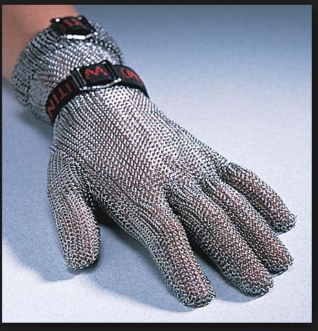

    Robert Peter Oakes over 9 years ago in reply to dougw
    Ohhhh, Static..... ZAP.

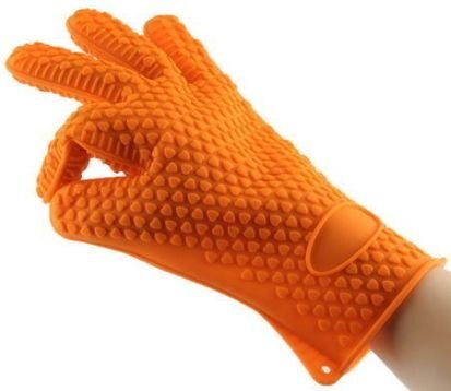

    dougw over 9 years ago
    I just ordered a silicone glove (~$4) which is sold as an oven mitt. They are excellent at insulating from heat and I have seen a review where it survived an open flame. I don't think they are good for dexterity, but they may work for you. I did not buy it for this - I am going to test it at rubbing cat fur out of carpet....
