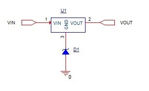

    Here's a tip on how to change a regulator's voltage:
    Put a zener diode on the regulator pin that is usually connected to ground.  This will raise the regulation voltage by the value of the zener.
    Vout = Vreg+Vzener

    jwatson over 8 years ago in reply to rsc
    Hi Scott
    Thank you! This is a great eBook Tip - just the sort of thing we are looking for and would include in the book.
