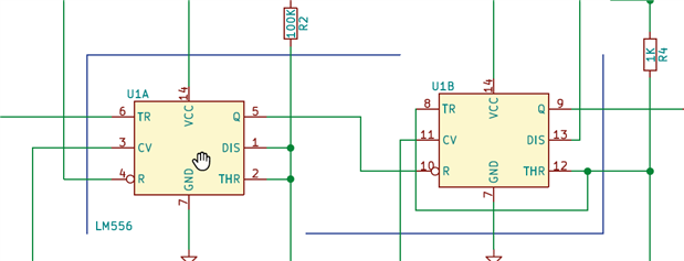

  • Workshopshed
    Workshopshed over 8 years ago in reply to shabaz
    Yes, that output is missing for me too. As are half the blue lines.
  • Workshopshed
    Actually those blue lines are intentional, they should form a box to show that both parts of the 555 are actually one chip i.e. a 556
    https://github.com/Workshopshed/HackSpace/blob/master/MusicBox/Schematic.png
    shabaz over 8 years ago
    I finally got round to reading them, very nice articles ipv1 and Workshopshed : )
    Writing a tutorial is definitely not easy, so your article Inderpreet will really help people get confidence to use OpenHAB.
    Also the electronics hardware/mechanics combination from Andy was fantastic, awesome idea for a hand-made gift at Xmas to be honest. They seem to have some graphics issue, or maybe it is my PC rendering causing it, but Andy your really nice schematic has some blue lines:

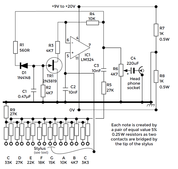

    Also noticed this diagram from page 84 is either missing an op-amp output, or my PC is really misbehaving during rendering:
    Not sure it is too readable with the gaps on signal wires near the bottom of the circuit. I can't figure out how those resistors are wired to R9 on the left. Maybe it is explained in the text, but the diagram is strange.
