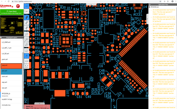

    shabaz over 6 years ago
    Hi Peter,
    I only briefly tried it, but I liked it, it could be useful. I had these couple of initial suggestions:
    1. Text on the right side is yellow on white, which is hard to read. Different color preferred.
    2. When selecting an object, I only see partial information about the D-code. I could not see the xy co-ordinates (there is co-ordinates of the mouse pointer at the bottom of the screen, but I couldn't see the co-ordinates of objects, unless I'm missing something).
    3. For 'measure between objects' feature to be more useful, it should also allow selection between left, right or center of object too. Currently it measures shortest distance from nearest edge or point. Also, as well as showing the length, it should show the X and Y distance. I'd find that handy for measuring between (say) board holes. Currently I have to manipulate with a calculator, if the holes are irregularly placed on a board. Perhaps a popup could appear with radio buttons to select the left, right, center or shortest distance, for each of the objects. As mentioned the output could display the distance as currently implemented, and the X and Y distances.
    Here is my screenshot of a FRDM board using the system:
    As mentioned, I've only tried it for a short while. I use other Gerber viewers, but may use this sometimes too.

    pvermeulen over 6 years ago in reply to shabaz
    Hi,
    thanks for your feedback.
    We strive to make our free online viewer the reference viewer for all Gerber files, so any feedback is greatly appreciated!
    We already made the text of the warnings more readable in the latest version.
    It is now also possible to upload a .zip file, containing a complete Gerber job.
    kind regards,

    shabaz over 5 years ago in reply to pvermeulen
    Hi Peter,
    It's becoming great for quickly checking out gerber files: )
    My favorite feature is the XY co-ords displayed of objects automatically when the mouse pointer is hovered over the object.
    The measurement X and Y distances is fantastic - if they could be in a slightly different color to the diagonal (or perhaps have the diagonal in Italic to make it clear) that would be nice, but it's a minor thing.
    One other feature (which you will probably hate me for asking, more difficult : ( would be to allow board rotation by 90 or 180, and also board flip. Maybe it could be a temporary visualization without all the measurement features, e.g. user has to go back to the normal orientation to get all the features. Sometimes it's just hard to mentally visualize things without the board flip or rotate. Anyway, even without this, it's a very good board viewer.
