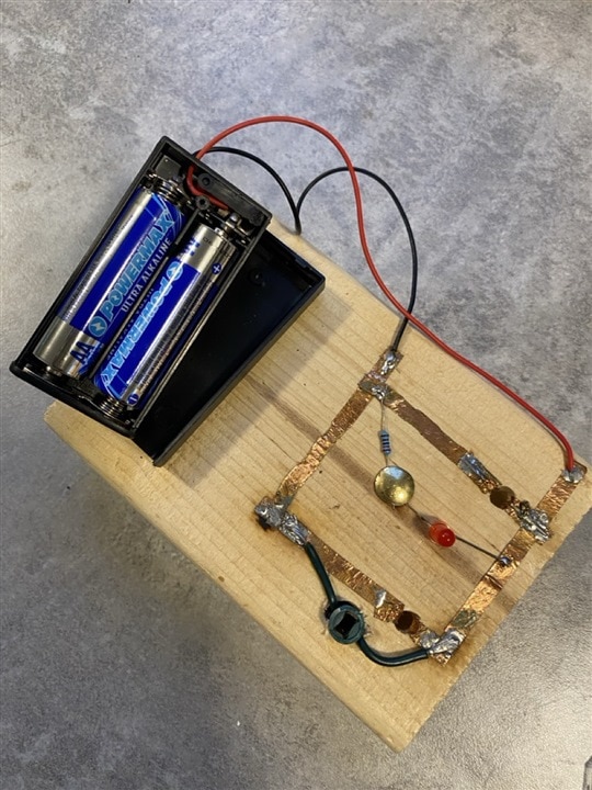

Christmas lights in the strings on trees tend to be either 2.5v or 3v, so using 2 AA batteries in series gives just the right voltage.
I have the old most-likely-to-burn-out incandescent type and mine were 2.5v according to the box.
I used a little 2-AA battery holder I already had, and just popped in some slightly-used AA batteries so that the voltage would be a bit lower, close to the 2.5v mark.
I stuck it onto a small block of wood with some double-sided tape. In my case I used a little piece of 2x4 construction lumber. This just needs to be deep enough to allow a hole to be drilled to fit a little light bulb. The extra thickness of the 2x4 makes it nice and sturdy though.
xmas lights tester 2AA
As you can see, I went through a few tries - my initial attempt was just to use copper tape to create a circuit, with holes drilled to fit the light bulb, and the copper tape runs into the edges of the holes so that a light bulb could just be touched to it to see if it was defective. That made it super easy - just run the tape and done! no soldering required... or so I thought.
However, I soon learned that setup did not work very well - it was hard to get good contact on the tape, plus the copper tape is thin and not very durable. And I really did need some soldering to get reliable connections between the pieces of copper tape.
I don't remember why I built it with 2 holes... not like I was able to test 2 at once... maybe I was hoping my wife would help?... maybe in case I broke one I'd have the backup? Or maybe because the first one was unreliable and I was testing another way - for that second hole I used the connecting bits from some broken female headers, hoping it would make a more solid connection... it did, but it was still not great.
I also ran into the issue of wondering whether the batteries were good, or if the battery box switch was turned on, so I added that little LED indicator light, with the required resistor, of courseSmiley
Fun fact: copper push-pins are great for connecting components Smiley I think I did solder the bits together in this case. it's also easy to solder things to the top of the push pin.

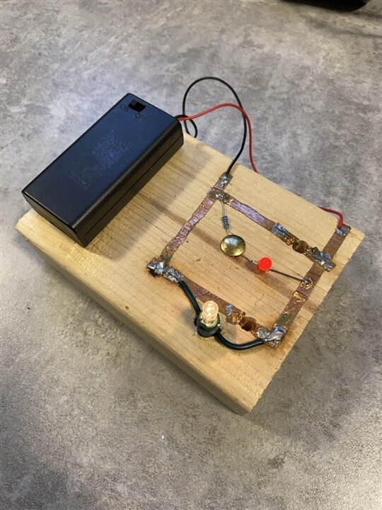

And then the final step was to upgrade from the holes-with-copper-tape to an actual light socket. I cut a socket with short wires from an old burnt-out light string, and hooked it up as you see in the picture - I drilled a hole to hold it properly, and I cut the top off the socket so that I could just push the light onto it without the extra effort required of seating it fully.
Finally, that worked great - easy, reliable testing.
xmas lights tester
Above it shows a light that works.
