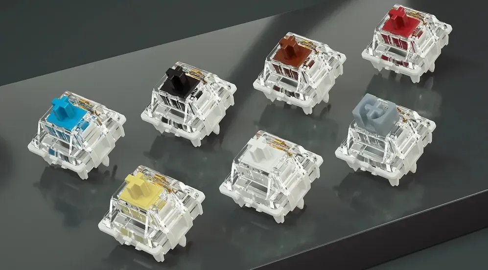

Based on the measurement of the switch, I carefully adjusted the pad placement to support hot-swappable sockets and added the required mechanical cutouts to ensure proper switch fitment. This step was critical, as the footprint directly affects both mechanical compatibility and electrical reliability. Once finalized, this custom footprint became the foundation for my entire key matrix.
The following image shows the mechanical measurement of a common Cherry MX switch.
Below is the available footprint for the mechanical key switch.
I modified the original footprint to match the design shown below.

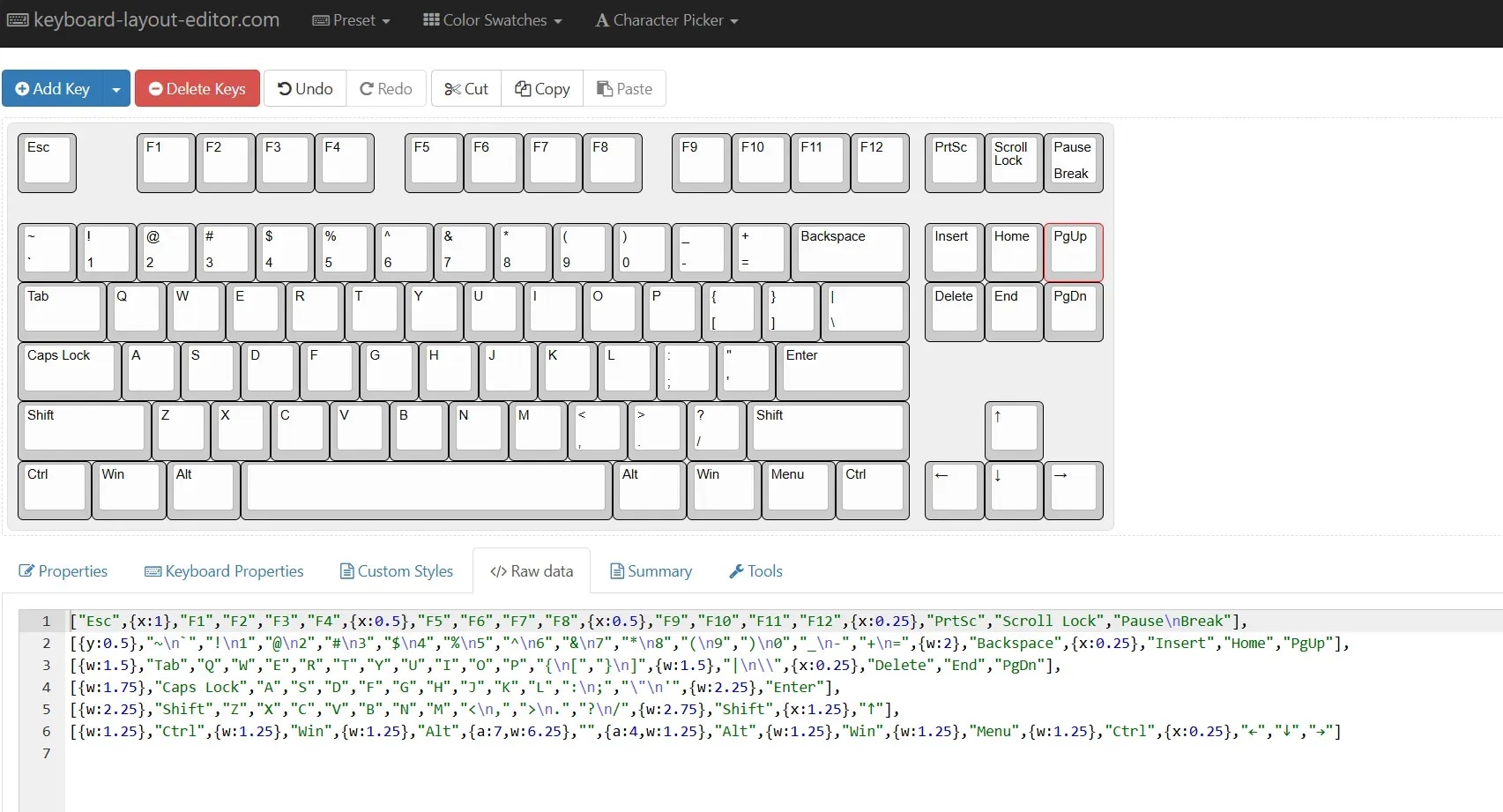

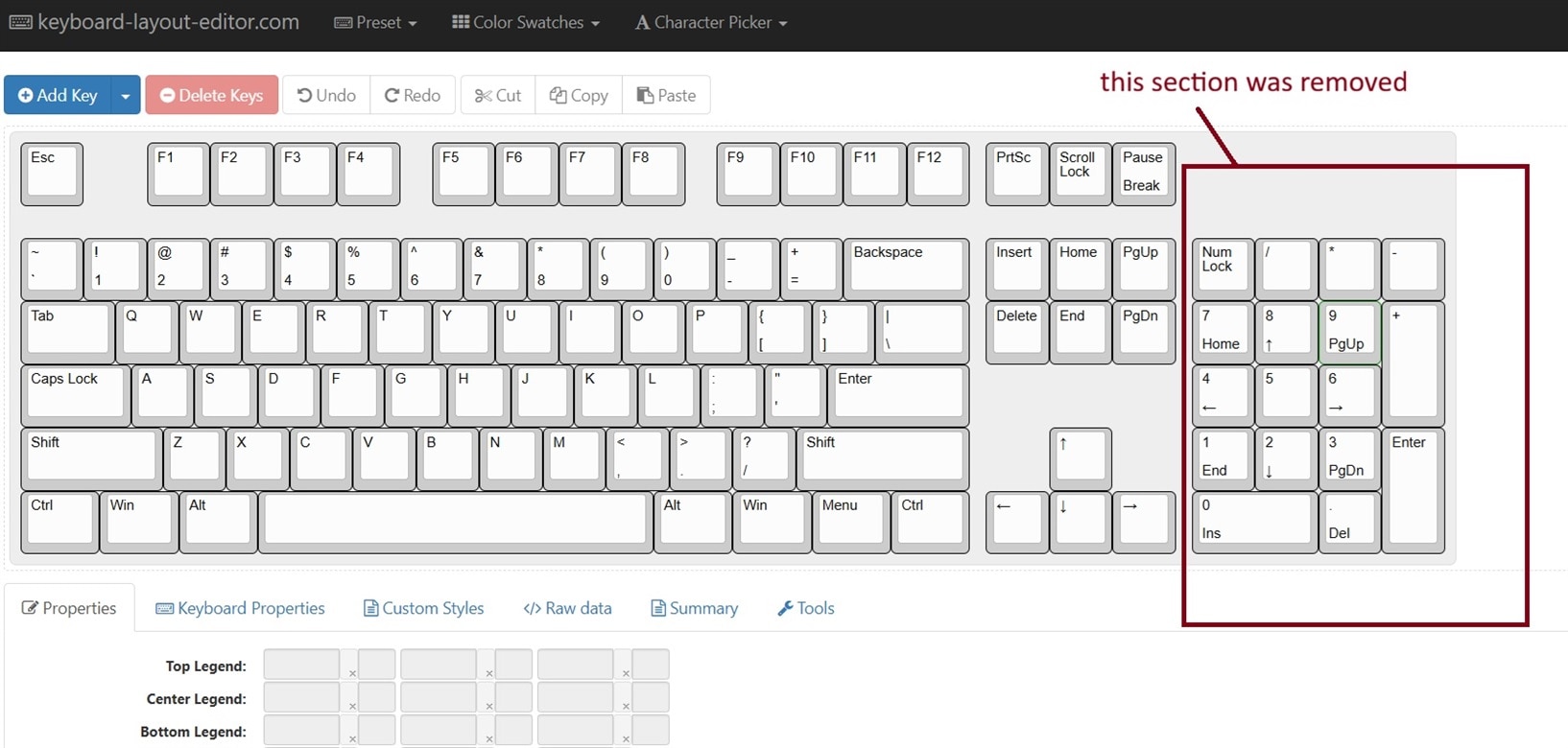

To design the complete schematic, a proper keyboard layout was essential. I used keyboard-layout-editor.com to explore different preset layouts, and the ANSI 104 layout immediately caught my attention. Although it is a full-sized 100% keyboard, I wanted something slightly more compact. Since I am not a heavy user of the numeric keypad, I decided to remove that section and convert the design into a Tenkeyless (TKL) layout, making the keyboard more practical and space-efficient while still retaining the essential keys.
The layout consists of 87 keys, I added all 87 switches to the schematic and organized them into a matrix configuration. As shown in the screenshot, the keys are arranged across six rows and fourteen columns, reflecting the logical structure of the key matrix used for scanning and firmware mapping.
The row–column structure was chosen not only to reduce pin usage but also to keep the matrix logically organized and easy to route on the PCB. Grouping keys in this way helped maintain clean schematic organization and later simplified both PCB routing and firmware configuration.

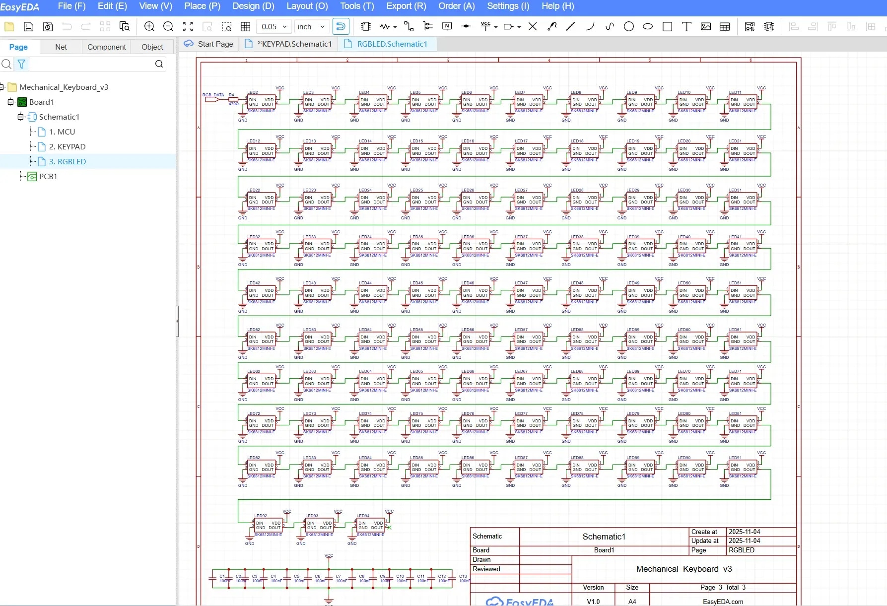

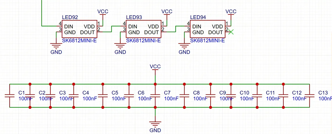

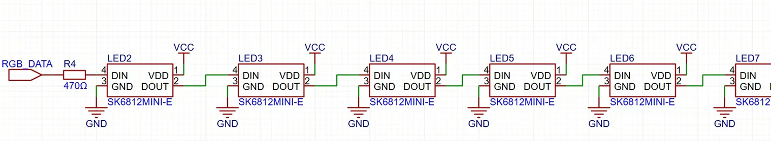

One of the key focuses of this keyboard is the RGB lighting, as it will be used to display the holiday-themed animations. To achieve this, I selected 87 RGB LEDs for the 87 keys, ensuring every key can participate in the lighting effects. In addition, I added 6 extra decorative LEDs to enhance the overall festive appearance and indicate the mode of the keyboard.
All RGB LEDs are controlled through a single daisy-chained data line, which simplifies both PCB routing and firmware implementation. As per the datasheet recommendation, a 470 Ω series resistor was added to the RGB data line. This resistor helps reduce signal ringing and current spikes, particularly at higher data rates, ensuring more reliable communication between the microcontroller and the LED chain.
Special attention was also given to power distribution and decoupling. Multiple decoupling capacitors were placed across the RGB power rail to stabilize the supply voltage when a large number of LEDs are active simultaneously. These capacitors help prevent voltage drops, flickering, and electrical noise that could otherwise affect LED performance or interfere with other parts of the system. Though it is recommended to use one capacitor with each LEDs, to keep it simple I used one for multiple LEDs. I used total 13 for 96 LEDs.

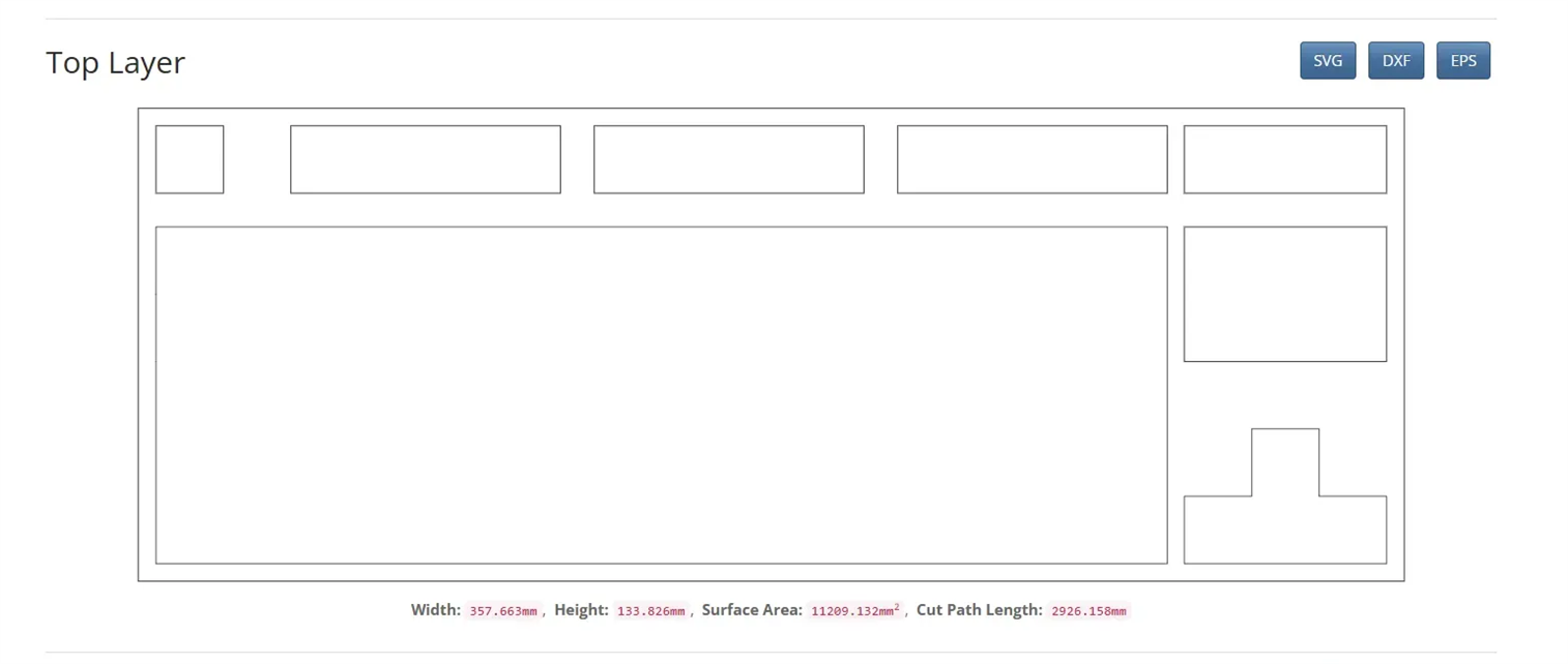

To ensure accurate and standard-compliant switch placement, I generated a DXF layout file from Swill’s Keyboard Plate Builder (http://builder.swillkb.com/). To do this, I copied Raw Data from Keyboard Layout Editor (KLE) (https://www.keyboard-layout-editor.com/) for my selected ANSI 104-key layout without the numeric keypad as showen the image below.
 Then I pasted the row data into Swill’s Keyboard Plate Builder (http://builder.swillkb.com/) for generating the DXF based on the layout as shown in the image below.
I also generated a top layer (top case) from the swillkb builder site.

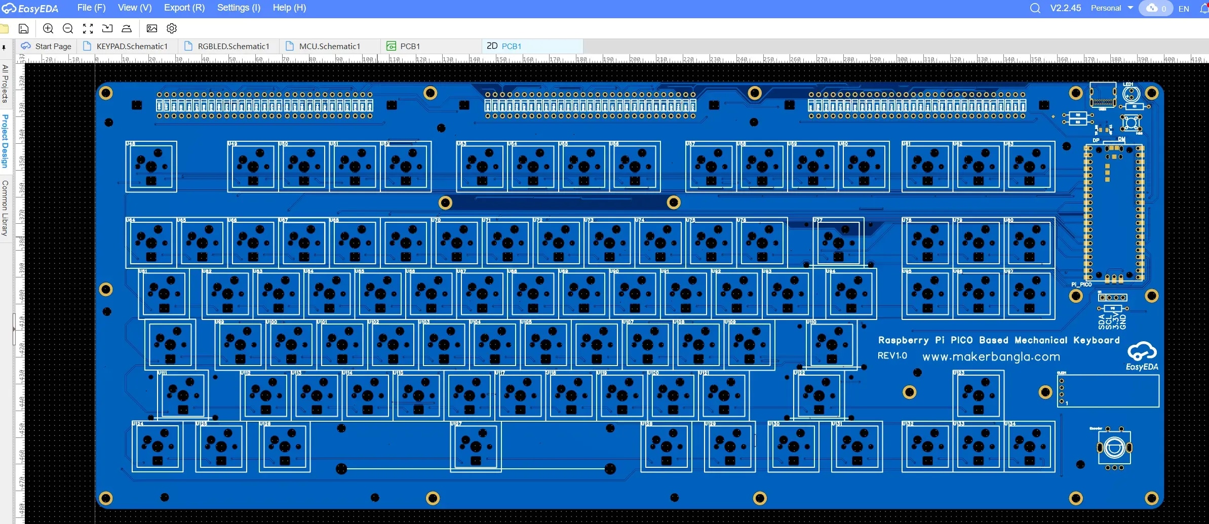

After placing the switches, I started working with other components. Every key in the keyboard uses a dedicated diode to prevent ghosting, but instead of placing the diodes close to individual switches as is commonly done, I intentionally treated them as a visual design feature. I placed all diodes parallel on the top side of the PCB, aligned them straight, and divided them into three distinct sections across the PCB. Without hiding them, I intentionally keep them visible purely for aesthetic reasons. Care was taken to ensure that this arrangement did not negatively impact routing or electrical performance. I placed six additional addressable RGB LEDs within these diode sections, one LED on each side of every diode group. When illuminated, these LEDs frame the diode lines with light, emphasizing symmetry and creating a striking visual contrast against the PCB surface.
I placed the Raspberry Pi Pico prominently on the right side of the PCB rather than being hidden to give a strong DIY look. A matching window was added to the plate layer, allowing the Pico to remain fully visible after assembly. A USB Type-C connector was placed in the top-right corner for modern connectivity and ease of access. Below the Pico, a 128×32 OLED display was positioned to present layer status and system information. Finally, the rotary encoder was placed in the bottom-right corner, providing intuitive physical control without interfering with the main typing area.
To maintain the PCB's cleanliness, accessibility, and aesthetic coherence, I positioned all components carefully, considering usability, routing simplicity, and visual balance. This PCB design reflects my belief that hardware does not need to be hidden to be beautiful.

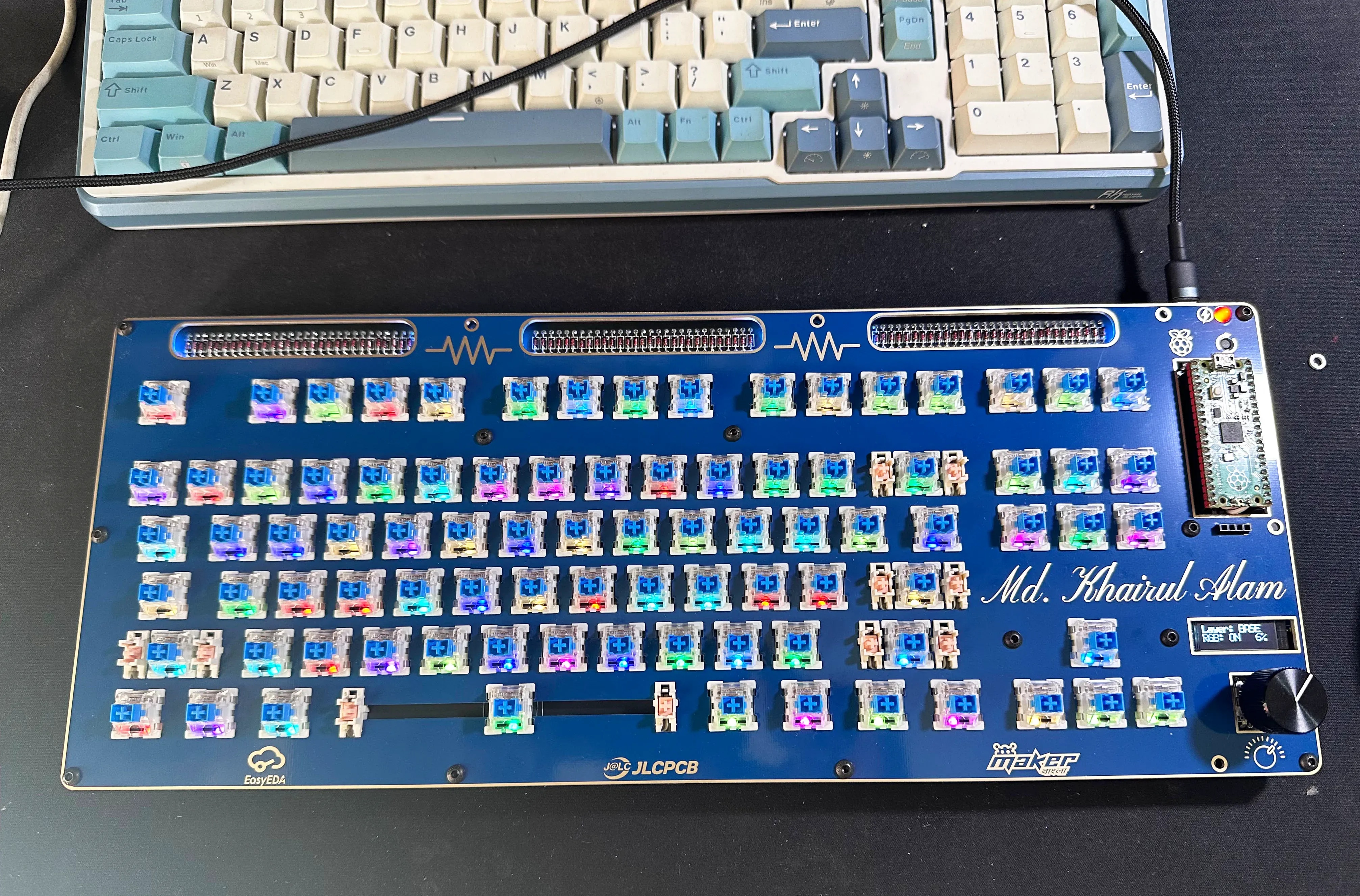

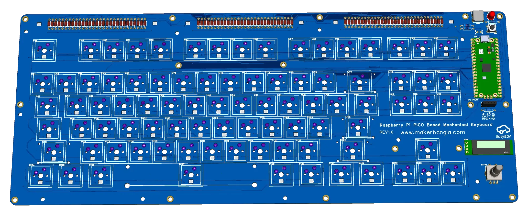

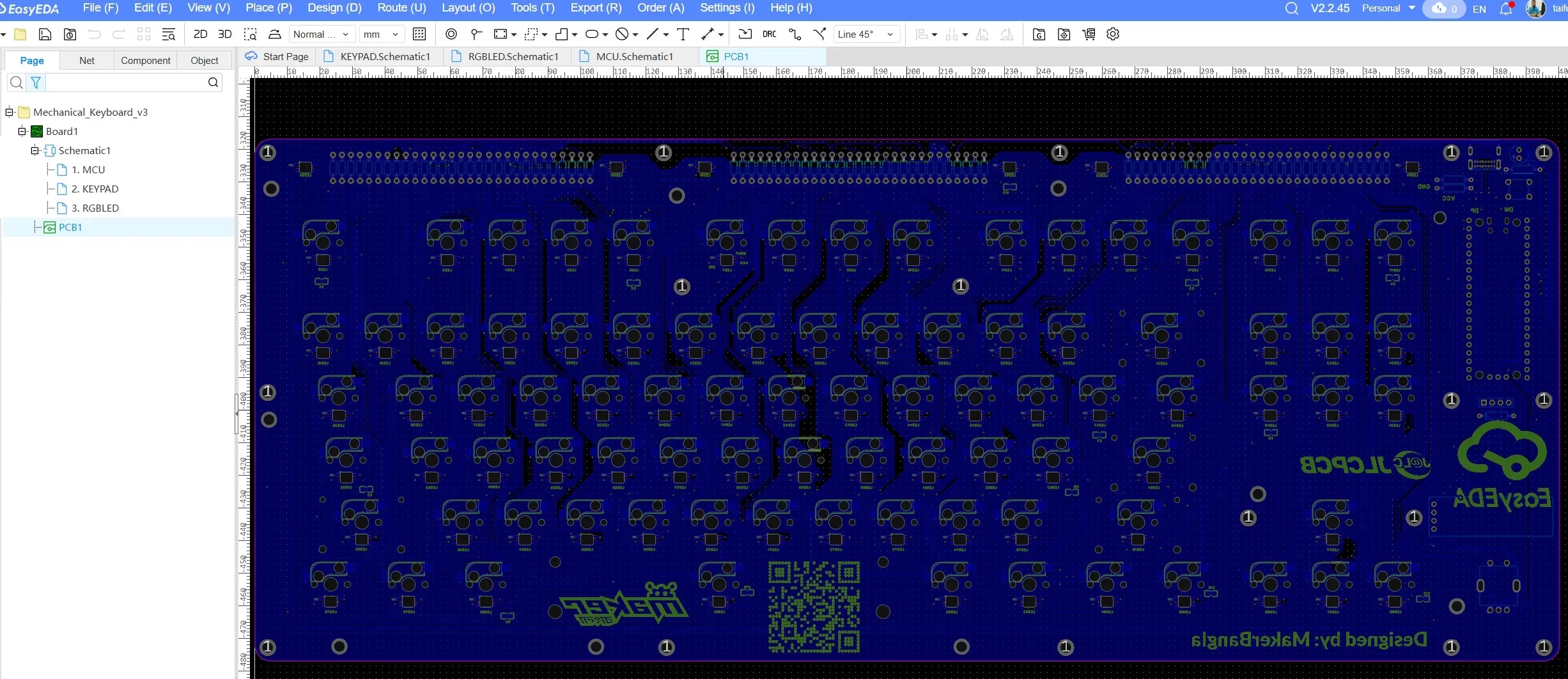

After finishing component placement and routing, the PCB layout appears as shown below.
Top layer of base PCB:
Bottom layer:
2D View of the layout:
3D View (top side):
3D View (bottom side):

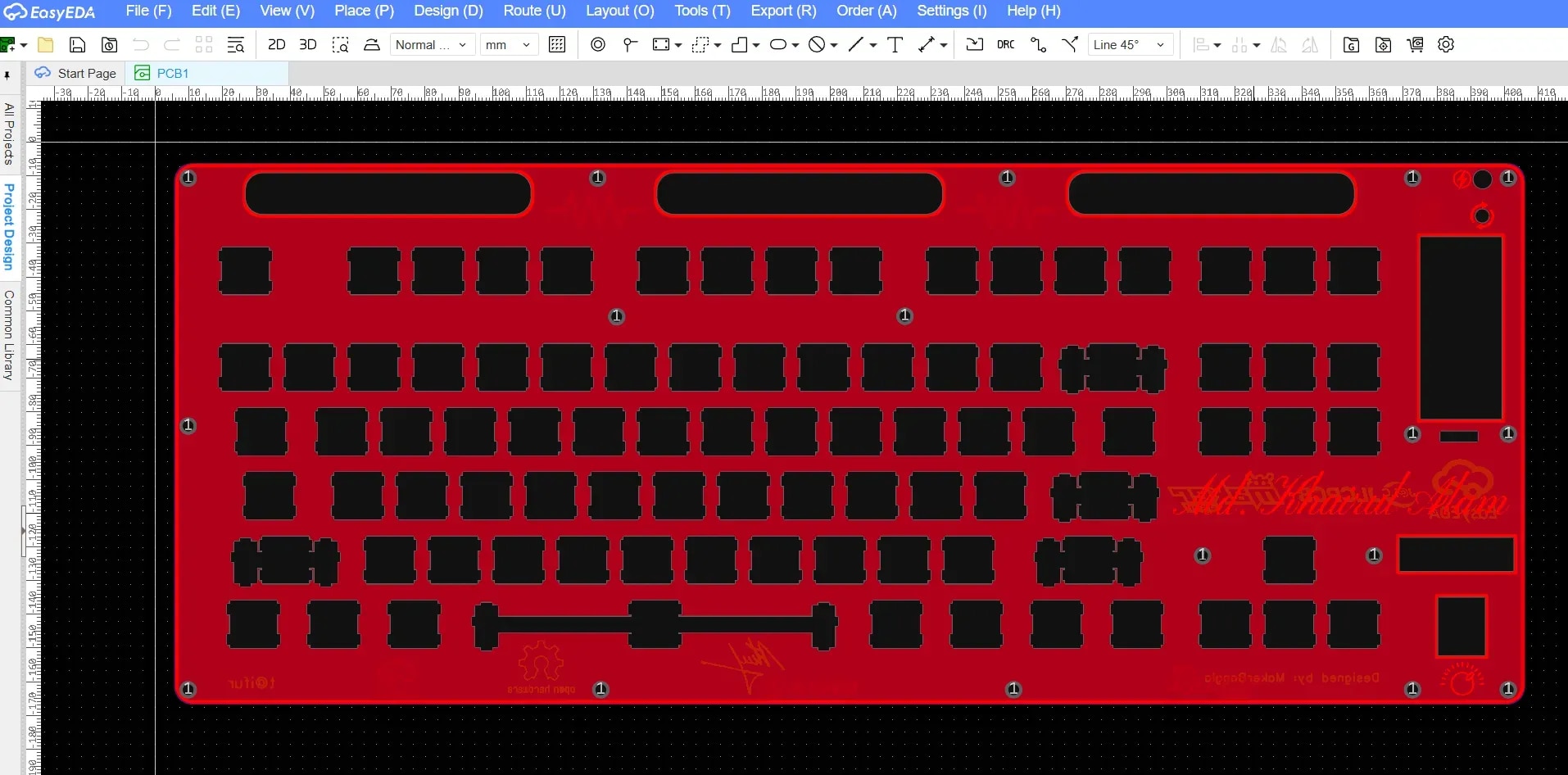

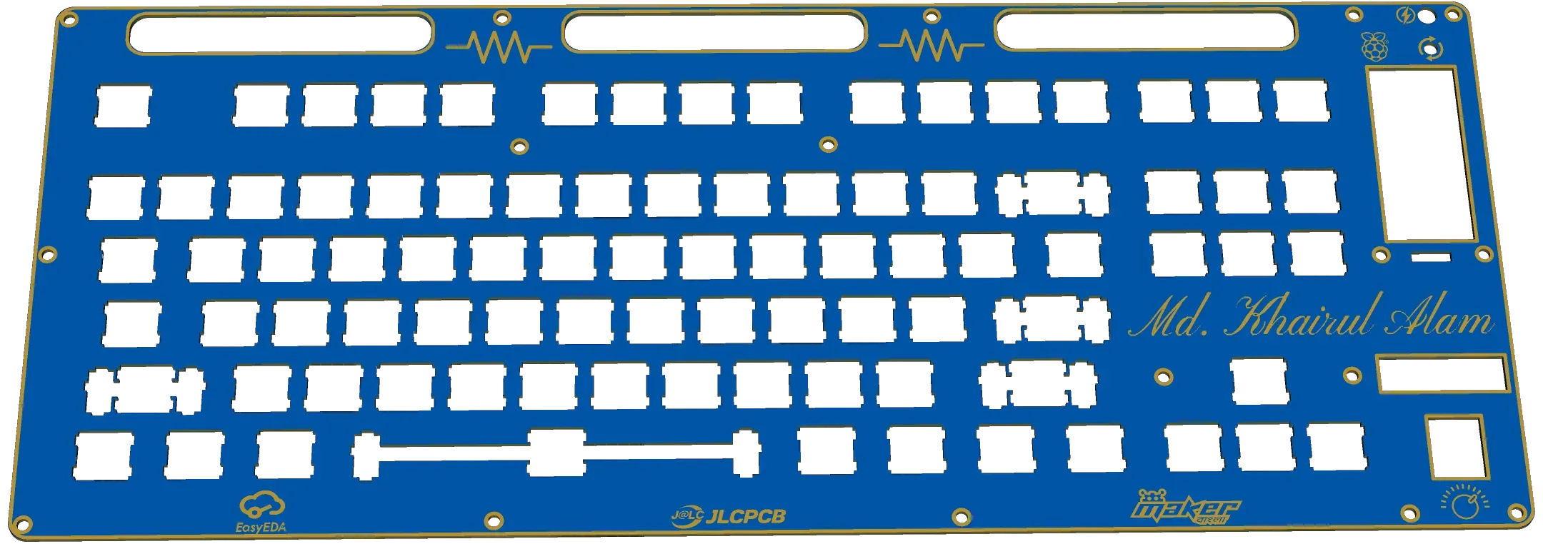

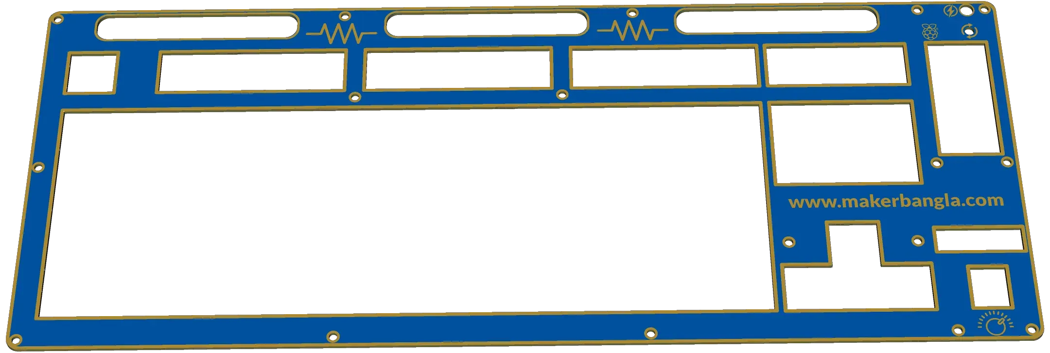

Plate and Frame Design
For the plate design, I imported the plate layout DXF and adjusted it to the size of my PCB. To make the three diode sections visible from the top, I placed three dedicated window cutouts positioned directly above the diode sections. Below is the plate layout after finalizing.
3D Layout:
The following is the 3D view of the frame layer of the keyboard.
All three layers of the design were initially integrated within a single EasyEDA project to ensure proper alignment and consistency across the PCB, plate, and frame layers. This approach made it easier to verify component placement, cutouts, and mechanical clearances during the design phase.
Before ordering the PCB, I separated each layer into an individual project and generated the Gerber files.

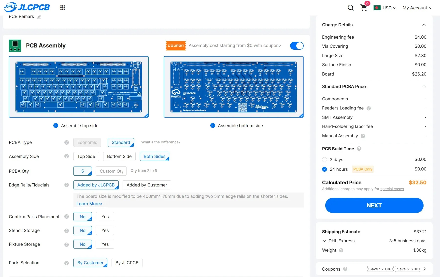

Ordering the PCB

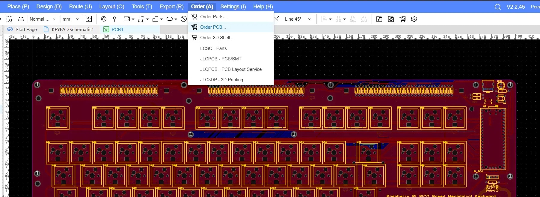

After completing all design steps and verifying the layout using Design Rule Check (DRC), I ordered the PCB directly from the EasyEDA design tool.
EasyEDA redirects the design directly to JLCPCB, where fabrication parameters such as PCB quantity, board color, thickness, and surface finish can be selected before placing the order.
In addition to PCB fabrication, JLCPCB also offers PCB assembly services, which can significantly reduce the effort required to source components from multiple suppliers and manually solder them. I ordered the PCB with the assembly service enabling component assembly on both sides.

1. GATERON G Pro V3 3.0 Pro Switch (you can choose Clicky or Tacktile, or Linear as your preference)

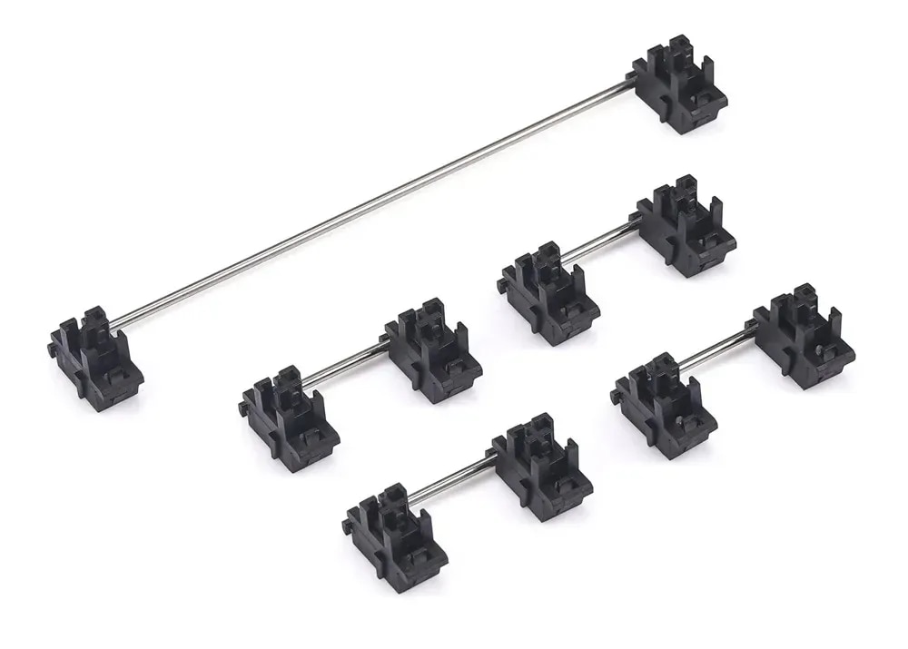

3. Stabilizer for Mechanical Keyboards (you can choose PCB-mounted or plate-mounted; I used plate-mounted)

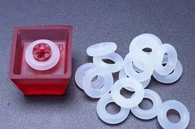

4. Rubber O Ring Keyboard Switch Dampeners (Optional)

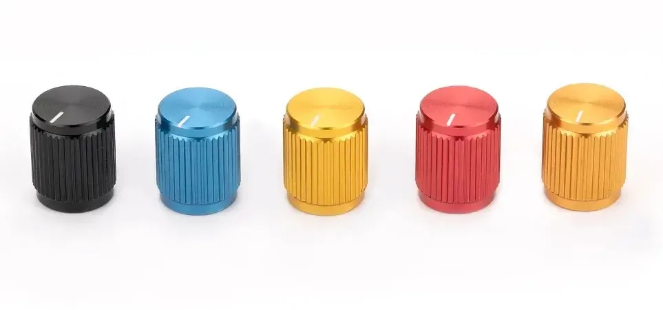

6. Aluminum Knobs for Rotary Encoder

Rotary Knob

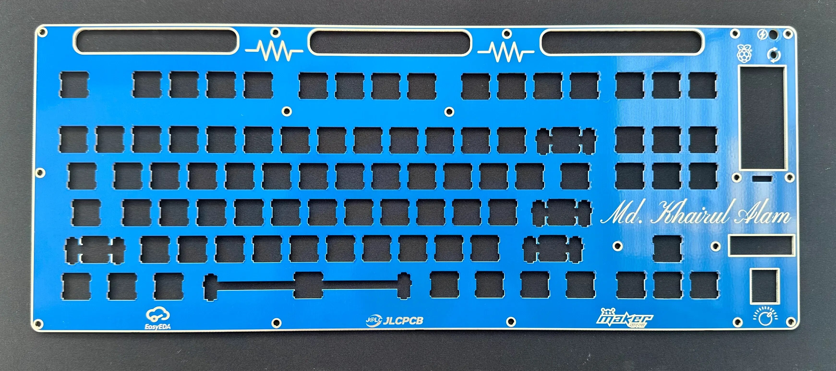

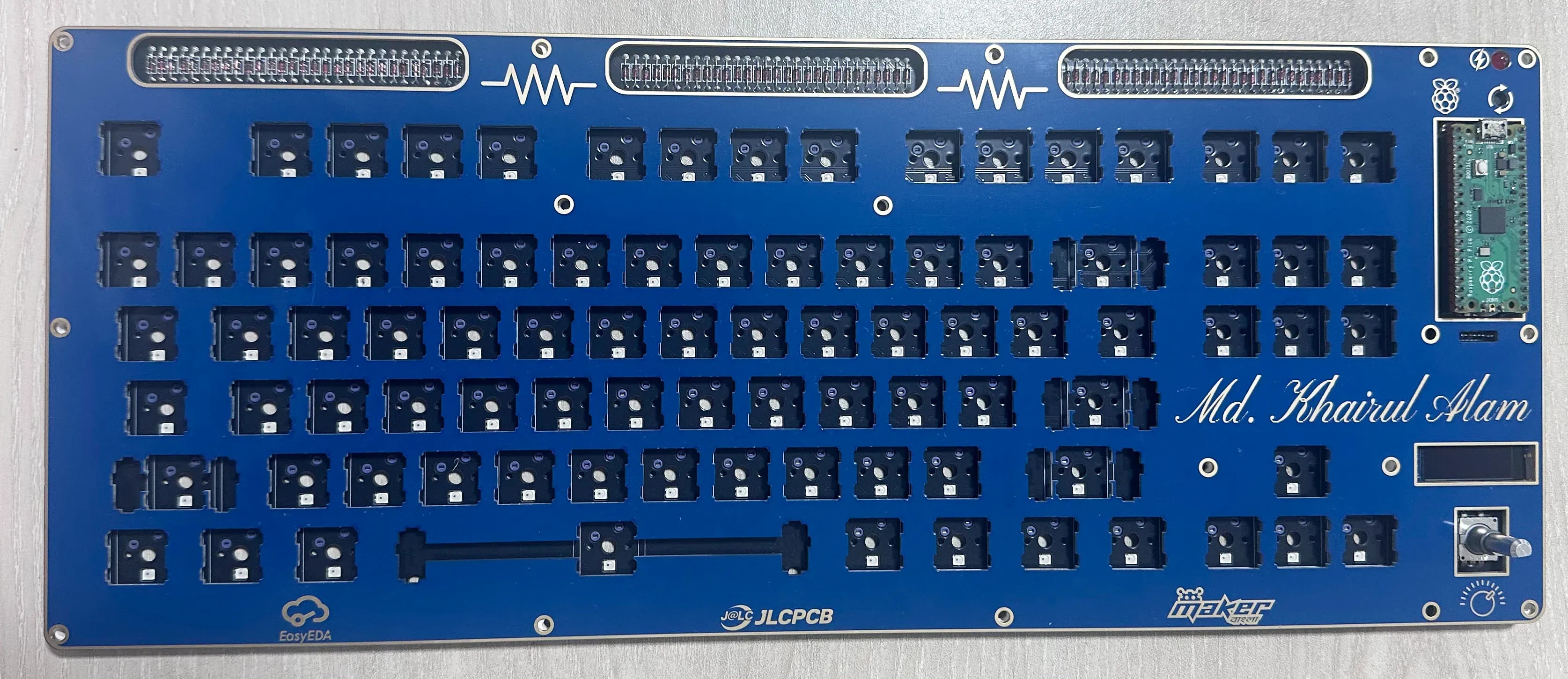

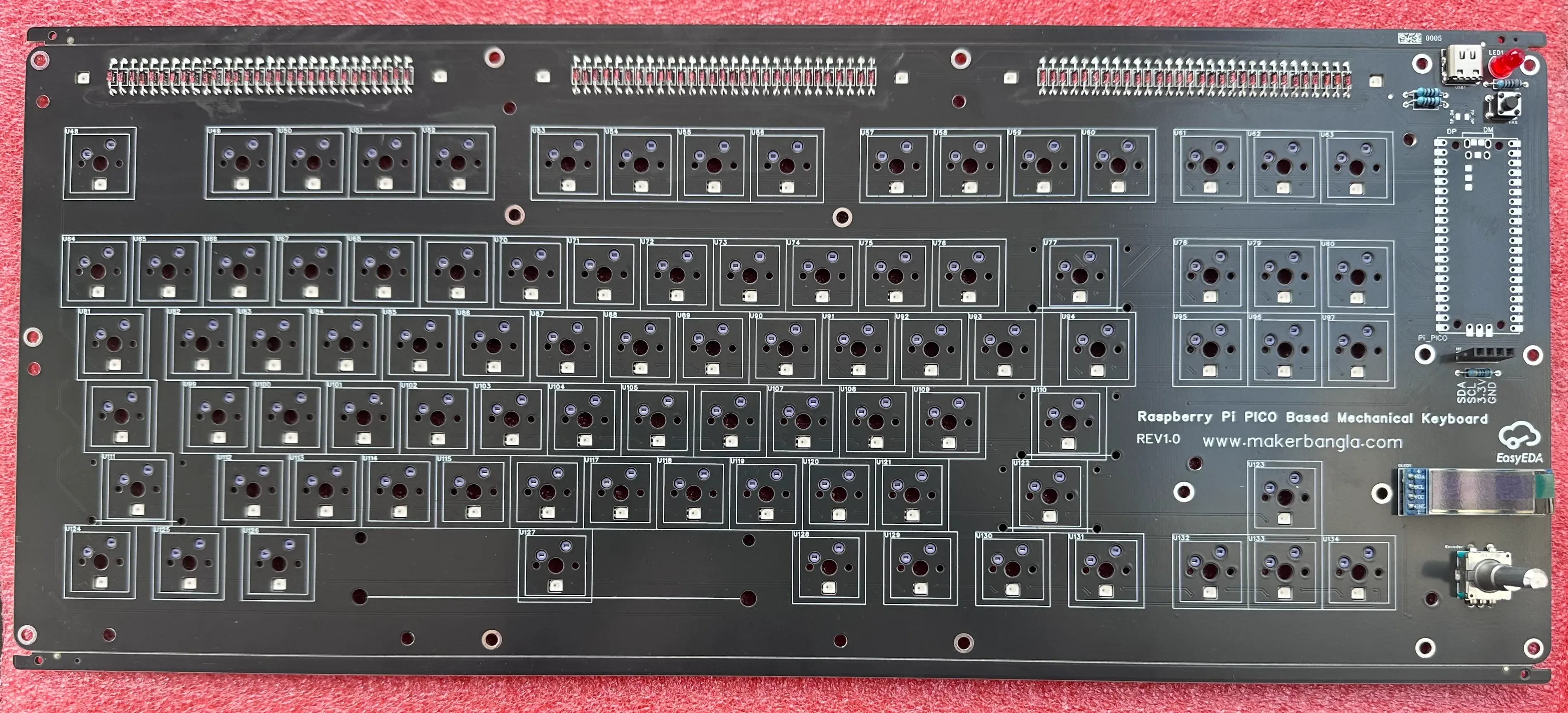

After waiting for around 25 days, I received the PCBs with impressively cool and professional packaging. The following are the top and bottom sides of the base PCB.
I chose black as the base PCB color for my keyboard because it complements the RGB lighting both functionally and aesthetically. A black PCB absorbs stray light and minimizes unwanted reflections, allowing the RGB LEDs to appear brighter, more vivid, and well-defined under each key.

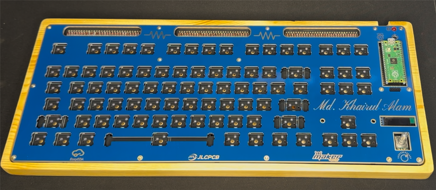

The following is the key switch plate PCB with an attractive blue color. This can be used as a middle layer if you want to use a top case layer, or it can be the top layer:

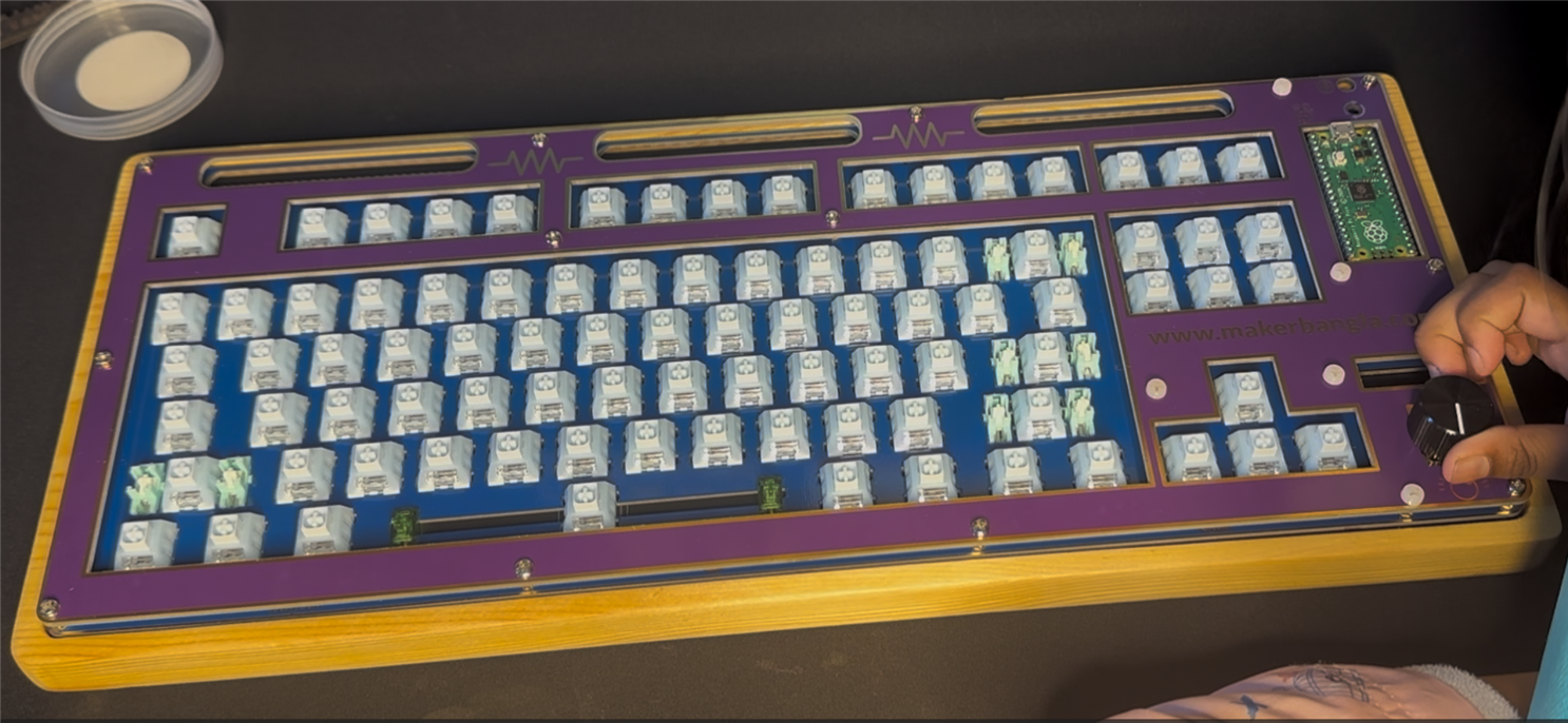

The following purple gold-plated PCB is the optional top case layer if you like a PCB case for your keyboard.

My base PCB came with all the components assembled without the Raspberry Pi PICO. So, I manually soldered the Raspberry Pi Pico with two 20-pin female headers.

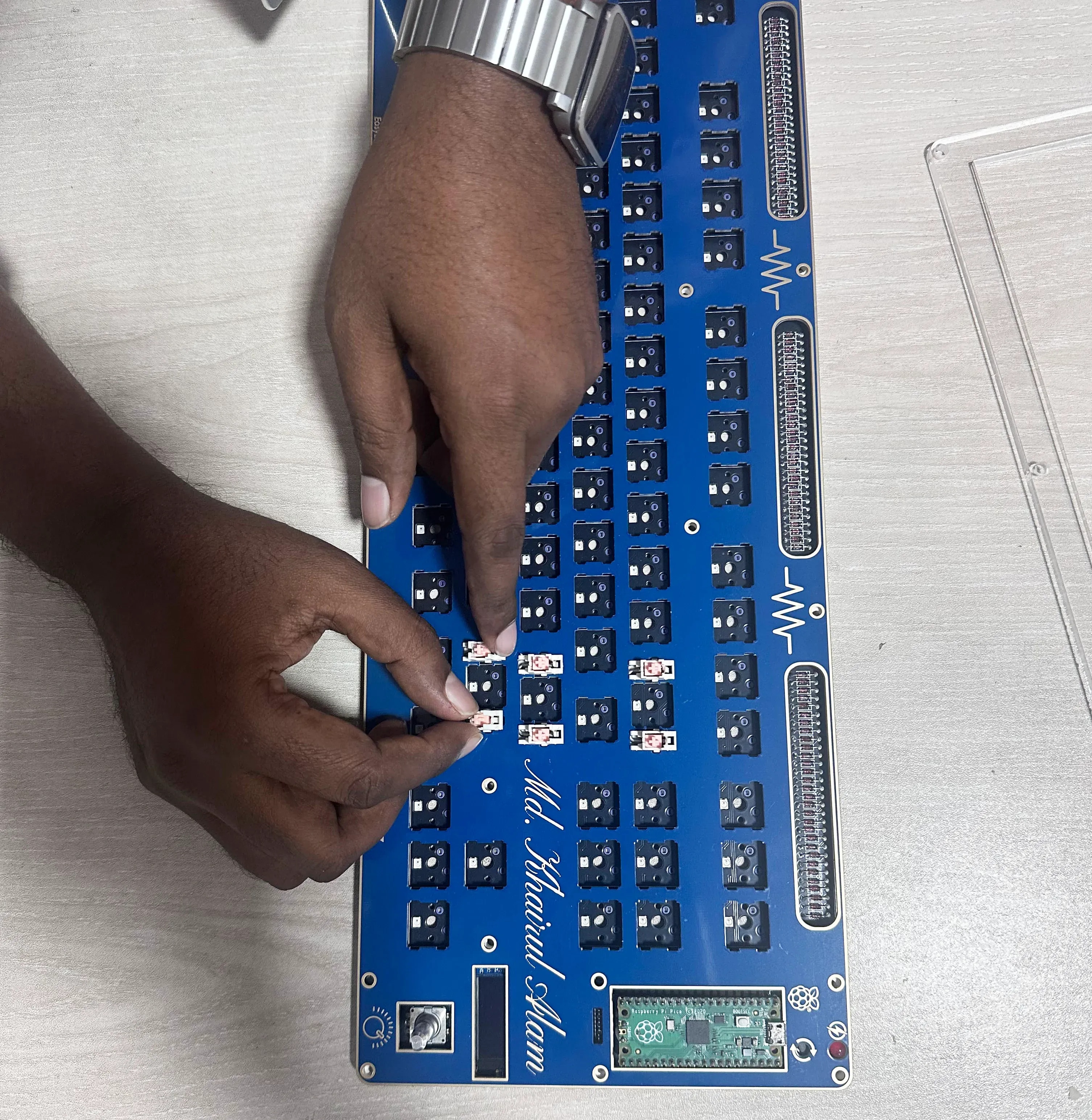

Then, I placed the plate PCB on top of the base PCB using 4mm long spacers as shown in the image below.
Then I installed the plate-mount stabilizers in the plate.
I placed the acrylic frame on top of the plate and fixed all the layers together using 15mm M3 screws and nuts.

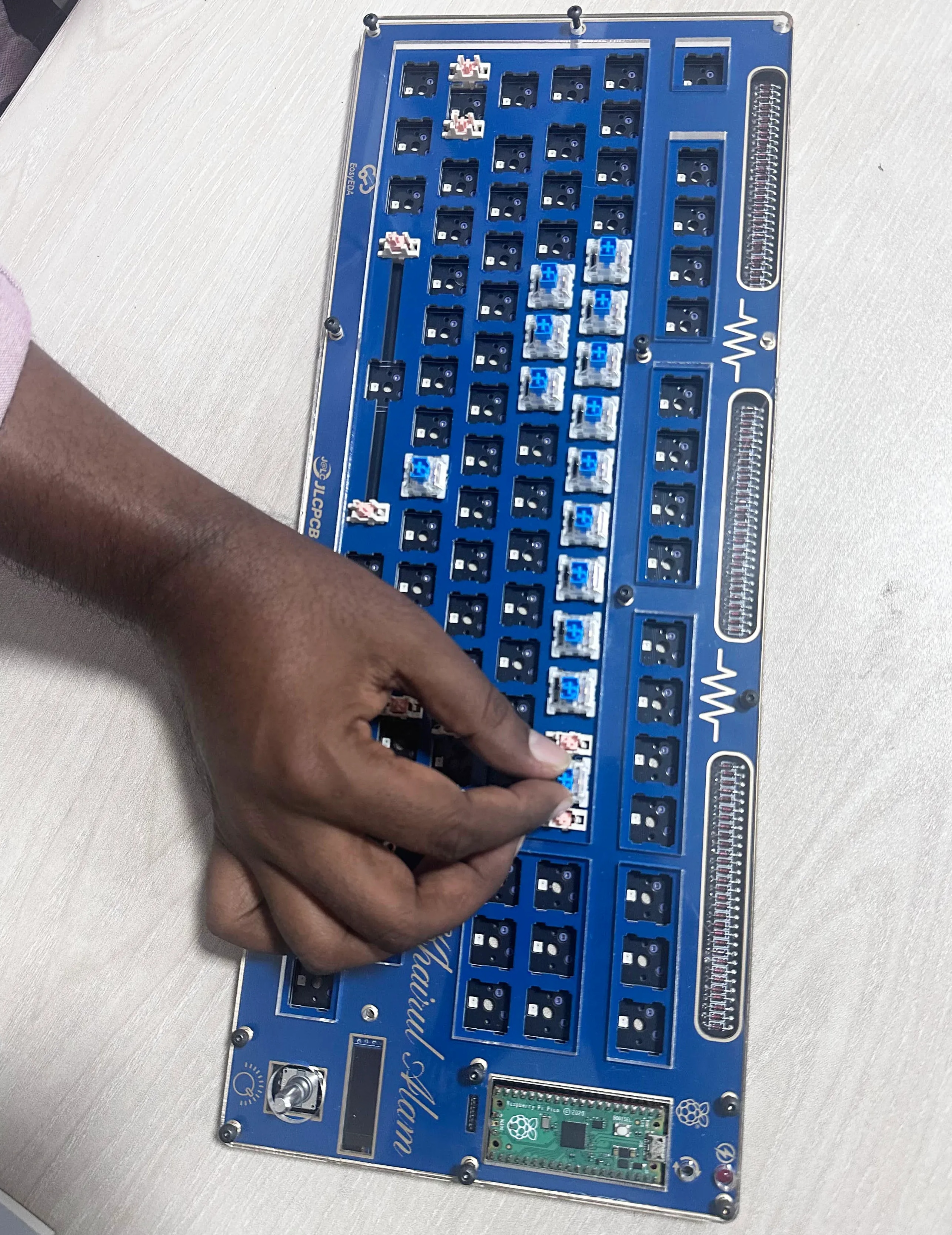

Then I installed the switches.

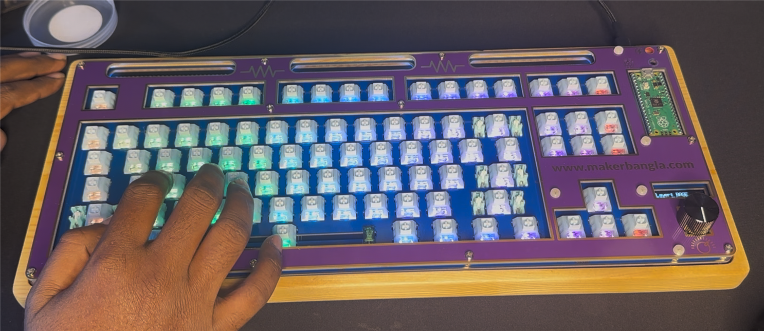

Version 1 Finished
In version one, there is no protective base on the bottom, and a transparent laser-cut acrylic sheet is used on top of the plate.

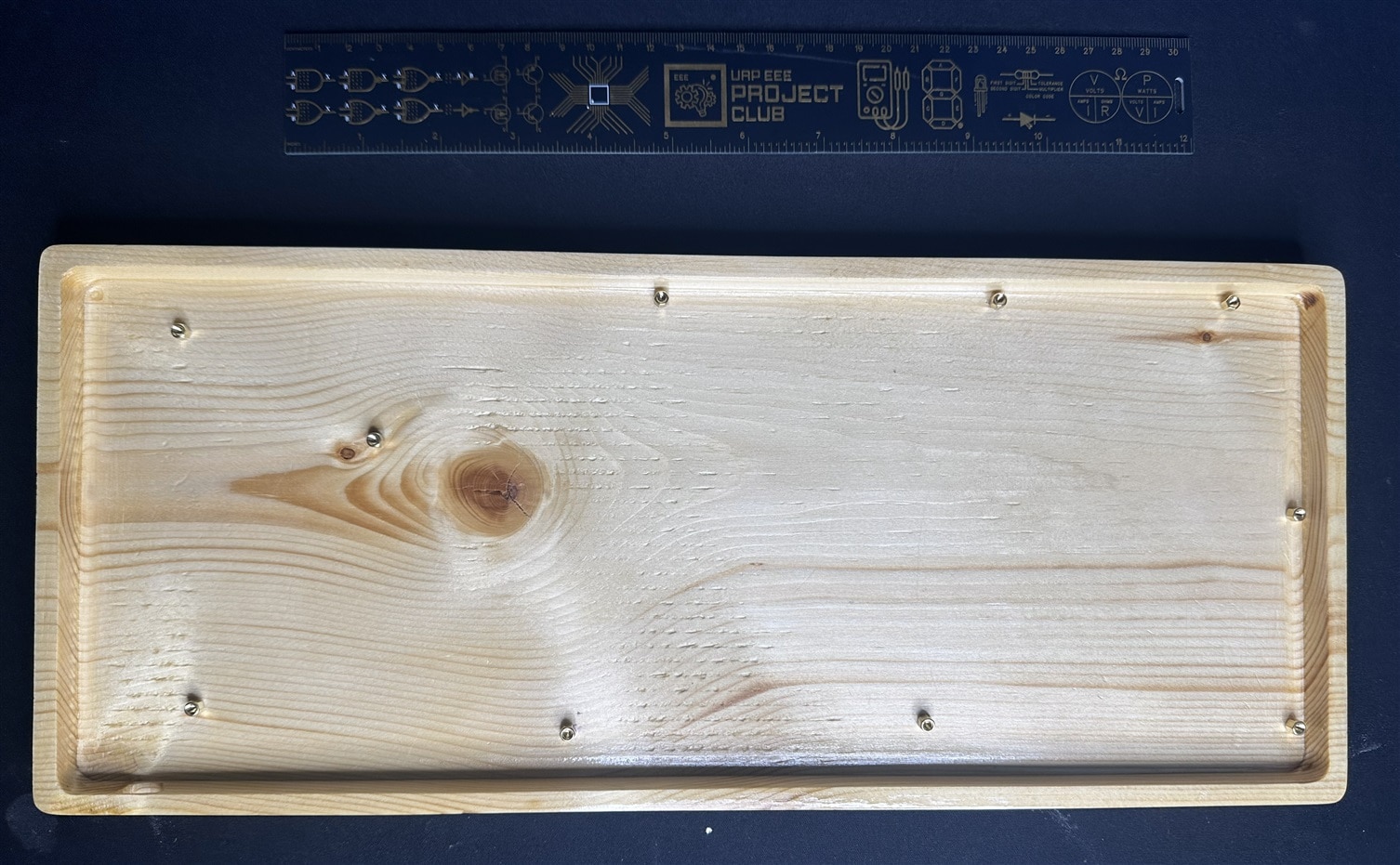

Version 2 (using wooden base)

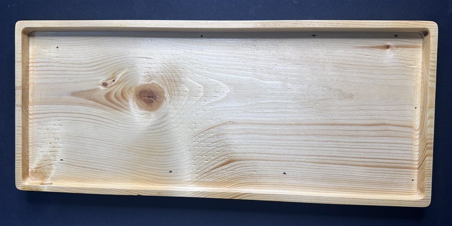

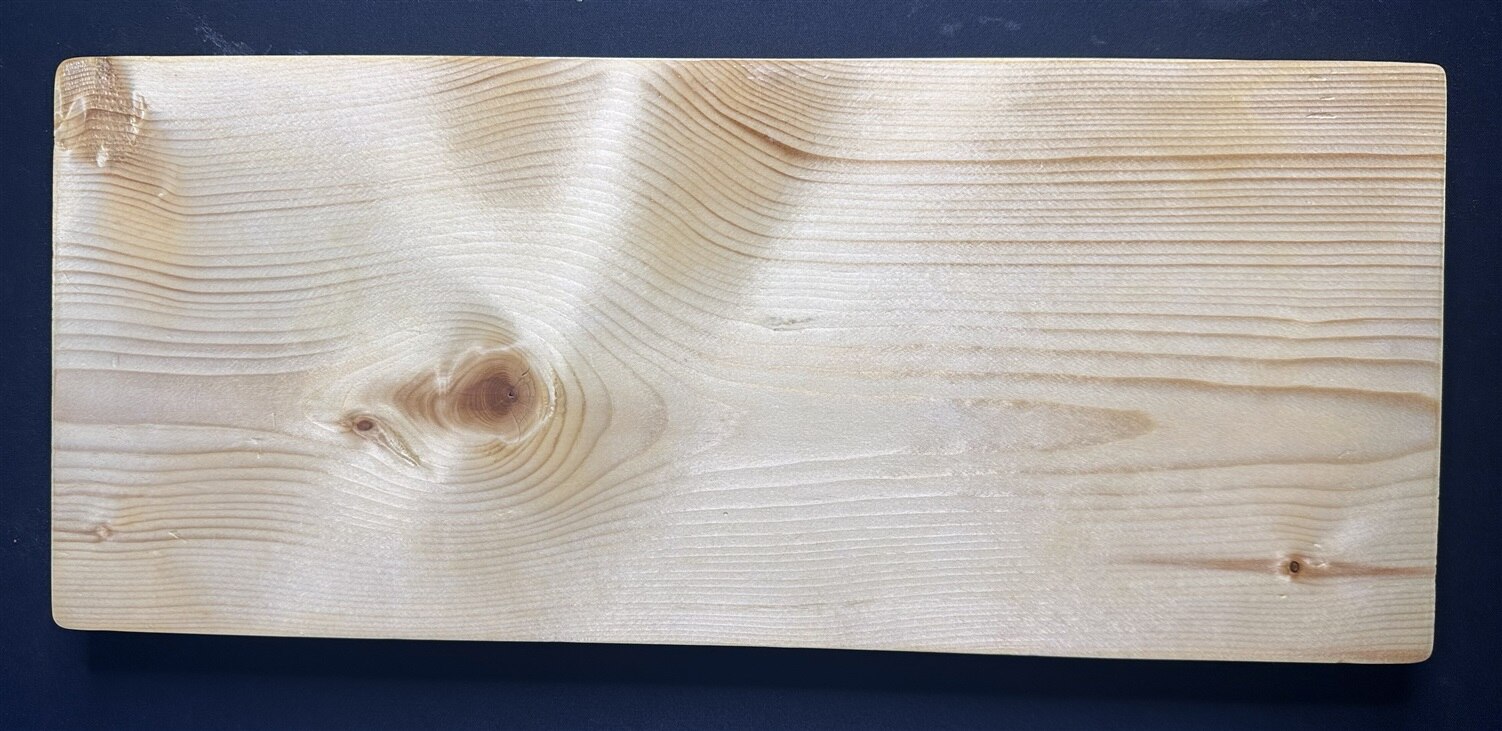

For version 2 of my keyboard, I selected pine wood base. According to the measurement of my PCB I cut and engraved the pine wood using CNC machine. I sanded the piece and applied wood preservative to protect it from the environment.
The following are the top and bottom view of the final pine base.
To mount the PCB onto the base, I drilled several holes using a 2 mm drill bit to insert the M3 hex spacers. Then I installed M3 3 mm × 3 mm female–male hex spacers into the holes and secured them using a hex driver.

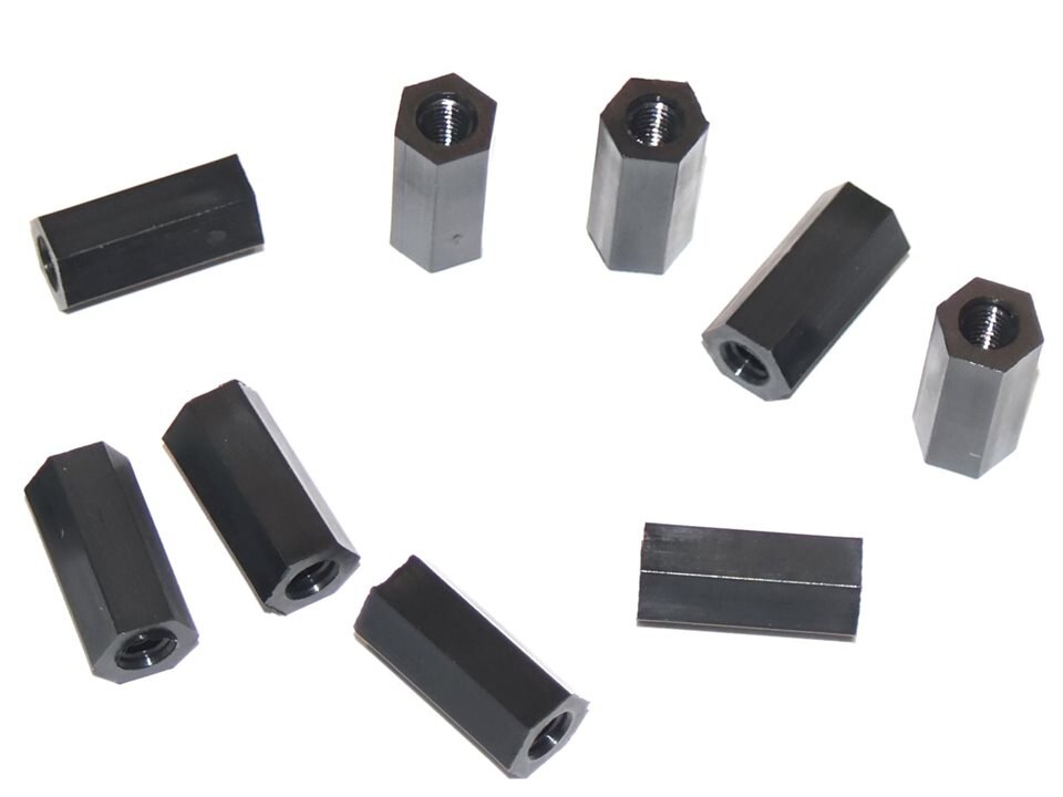

Then I inserted the M3 4 mm × 4 mm female–male hex spacers into the base PCB and fixed them with M3 nuts.
I placed the base PCB onto the wooden base and secured it using M3, 4mm screws.

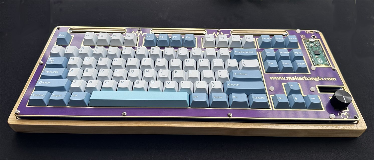

After fixing the base PCB on the pine base and inserting the Raspberry Pi Pico, I attached the plate and the top case.
Then I placed the stabilizers, switches, and the keycaps as like as version 1.
Before adding the keycap, I checked the keyboard using https://en.key-test.ru/ to confirm that every key is working.
I encountered an issue with a few of the switches where they were not seating properly. To resolve this, I carefully reopened the assembly and inspected the switches. I discovered that some of the pins had bent during insertion, preventing proper alignment with the hot-swap sockets. I straightened the pins, reinstalled the affected switches, and ensured each one was firmly and correctly positioned.

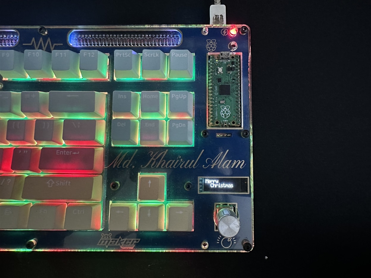

After confirming that all switches functioned perfectly and the keyboard worked as expected, I installed the keycaps.

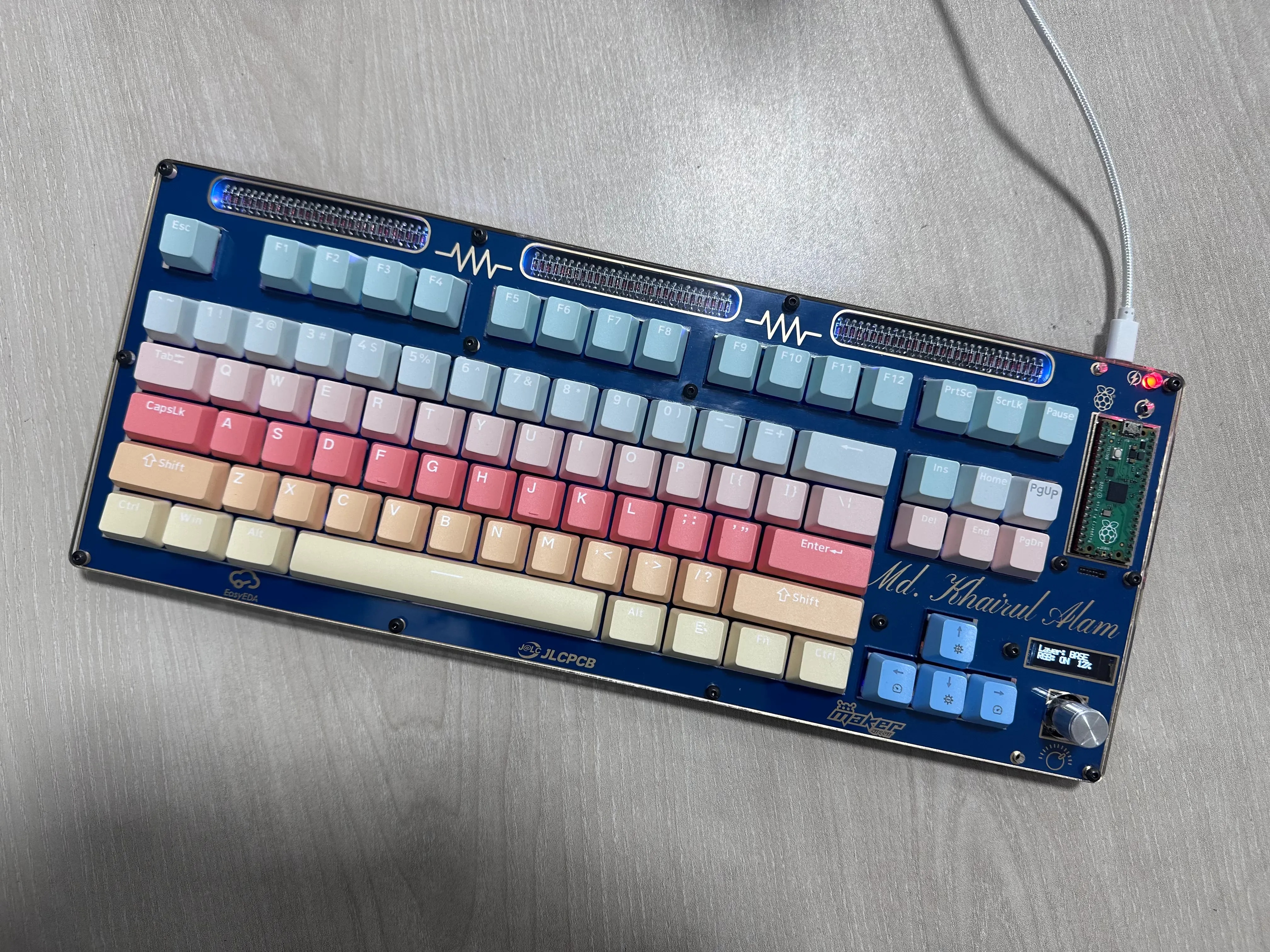

The final keyboard looks like this.

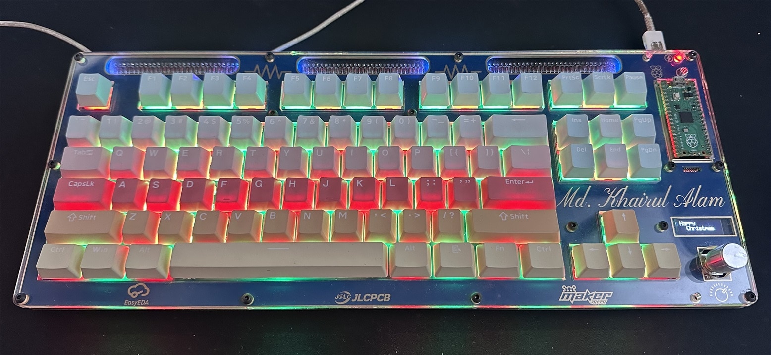

Holiday Effect
To bring a festive and celebratory mode to my keyboard, I created a custom RGB matrix user file and added a few holiday effects related to Christmas, Winter, and New Year. I also added holiday-specific greetings on the OLED display.

After enabling the Christmas wave effect, the keyboard looks very gorgeous. See the following image, though practically it looks more attractive than the photo:
I designed this holiday-themed keyboard to go beyond the traditional nature of an input device and transform it into an interactive, expressive platform that reflects seasonal joy and cultural celebrations. By integrating custom RGB matrix animations and contextual OLED messages for events such as Christmas, Winter season, and the New Year, the keyboard becomes a dynamic medium for storytelling and atmosphere. It allows users to visually celebrate holidays at their workspace, during live streams, exhibitions, or community events, making technology feel more personal and emotionally engaging.
I implemented 2 layers in my keyboard. Layer 1 is for general use, and Layer 2 is for some advanced options, like changing the RGB effect, adjusting brightness, increasing the audio level, etc. To enable or change the holiday effect, you have to go to layer 2 by using the rotary encoder and pressing the buttons from 1 to 8 to change the holiday effect. Different button has different effects. When a holiday effect is active, the related greeting is automatically displayed on the OLED display.
This keyboard can be a wonderful holiday gift for your friend and someone special, combining daily usability with a personal and festive touch.
