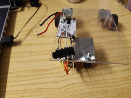

Building the cart
The TMC2300-IOT-REF evaluation kit will be roadtested while building a simple project: a dolly camera cart
The dolly cart is shown in pictures below. It has a three wheels configuration. The front wheel is the traction wheel. The base is made of plexiglass. On top of the base there is the TMC2300-IOT-REF board and the mobile phone holder, made of aluminum extruded bars.
Regarding the software, the application can be controlled using Blynk. The application for Android is available here. Installation and setup is very easy: there are just three steps to follow to activate your account and create your first Blynk application. To control the dolly camera cart, I create an application with the following widgets to control

Evaluating StealthChop2
StealthChop2 is supposed to autotune PWM signals to make microsteps that reduce noise and vibrations. To test this feature, I made a simple test: I drove the motor at different speed (ranging from 10 to 200 RPM) and measured the noise the motor makes. To make things more difficult for the controller, the motor has nothing connected to the shaft (and that may act as a flywheel)
In this video, I show the dB reads out by a sound meter application at different speeds.
You can not expect to have an extremely quiet motor in every working condition: for example, in this scenario you get the best results at 10 RPM and 130 RPM, so selecting the proper motor for the application is of paramount importance.
Testing the dolly cart
Here is a final video of the dolly cart. As a prototype, must thinks should be improved. The most important are
  • make a stiffer support for the camera
  • implement a linear ramp for the motor velocity to make smoother starts and stops
Conclusions
The TMC2300-IOT-REF is a very interesting board. It integrates the programmability of the ESP32 with the TCM2300 IC, which is designed to control motors in battery-powered applications.
