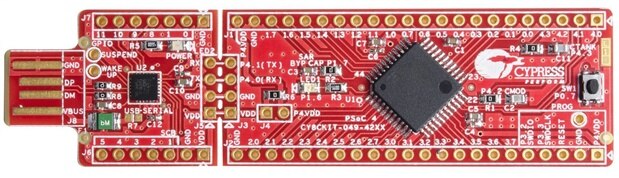

The PSoC 4 Architecture
After studying for a while the Cypress PSoC micro controler series I had the opportunity to appreciate some of the core features that are just what is needed as the base of this project:
  • Fast and full-featured processor.
  • Fast clock respect most of the other processors
  • Low power
  • Very cheap
  • Widely configurable I/O pins
  • Easy and hardware oriented programming
  • Stable and reliable
  • Very good development environment
  • Reasonable large amount of programming memory and data storage memory
All these features together demonstrated that PSoC 4 was the right choice: despite some controls and LEDs signals the external electronic parts to be added was just the power section. Thanks too to the inspiring article of cy.wbz PSoC 4 Pioneer Kit Community Project#045 – Stepper Motor Example

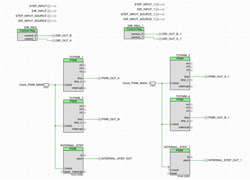

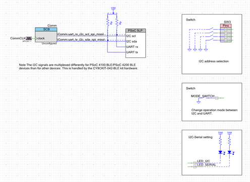

As one of the features I have most appreciated is the possibility to produce the base code designing the schematic template with the PSoC Creator the first prototype has been developed working with the development environment and designing the base schematic; as shown in the two images below it is divided in two parts: the power control (first image) and the control settings (second image)
Accordingly with the schematics below four pins are dedicated to the setting of the I2C physical address. A switch permits to set the interface to be used: I2C or TTL serial.

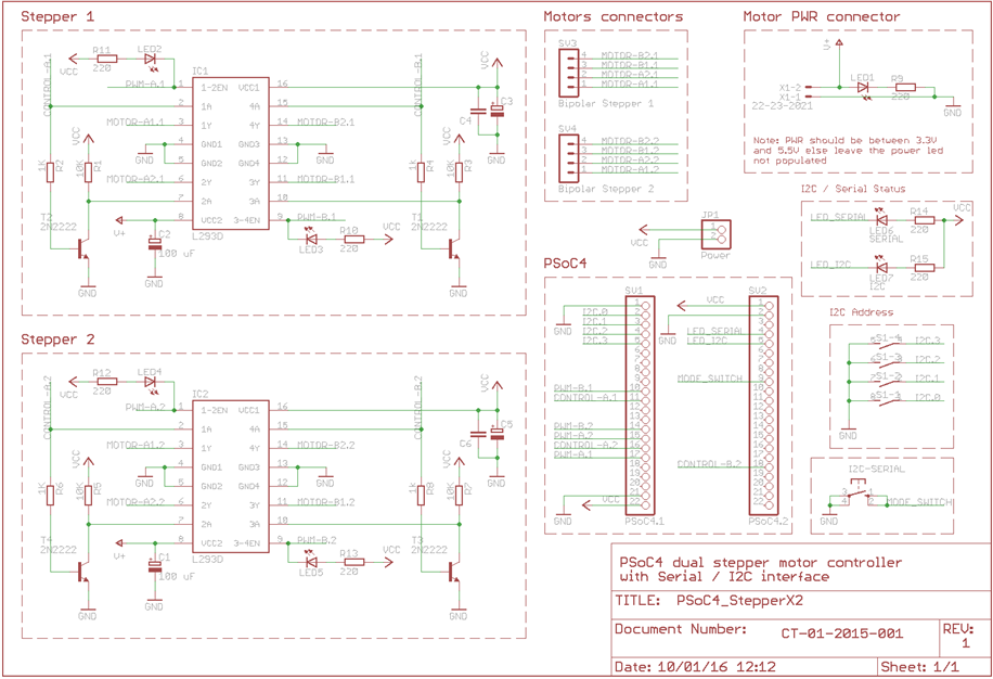

Controller design schematics and layout
The following image shows the controller design schematics
Due to the limits of the PSoC 4 only two motors can be managed by the board. The design is ready for use with a 1-1,5 A dual phase stepper motor powered by max 5V. Is a more powerful motor should be used the power LED should be removed or a bigger limiting resistor should be applied. Note that the L293 can support no more than 1,5 A but this chip can be piggybacked (up to three chip soldered one over the other) so that the controller can manage up to 5A stepper motors.

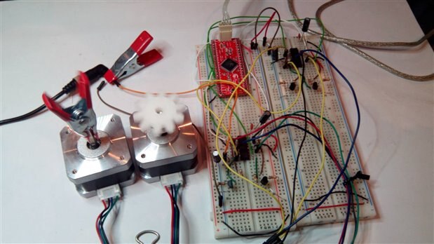

The video below shows the first test of the controller.

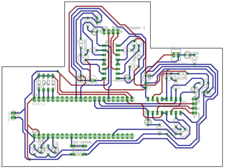

The following image shows the routed PCB based on the schematics above.
