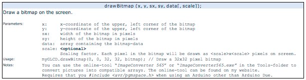

Can anyone provide me with some insight as to what I may be doing wrong?  I'm pretty sure that I followed the drawBitmap command format that is laid out in the UTFT manual, but it continues to have problems with the 5th variable in the command when I go to compile the code.  That 5th variable is the array variable name.  I'd love some guidance as to what I may be doing wrong.
The above image was from the UTFT manual located here: UTFT - Rinky-Dink Electronics
