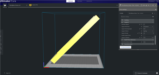

I needed to print a piece a bit longer for my bed size, but I knew that with a bit of an angle, it would be possible to print it.
I tried with Slic3r, but, the rotate function is not the best. You can't rotate while previewing the movement. You choose the axis and input the angle. I did put the piece at a 45º angle, but when previewing, it didn't show the supports, so I've decided I needed a new software.
After a bit of a search, I discover this forum post.
There's a package in Raspberry PI OS repositories for Cura. Just install it using
apt-get install cura
After install, you can execute it and it shows the splash screen (although is version 3.3.1 - a bit old)
It never executes. The crash reports appears almost immediately.
That was a bummer.
Reading more and more of the forum post, there's mention of an experimental AppImage of Cura for the Raspberrry PI 4.
We're instructed to go to a Github page for issues and to a Dropbox for the AppImage. The Dropbox has nothing. But in said Github page, there's the releases and our AppImage is there, for the Raspberry PI 4 - armhf file. At the time of this writing, Cura-mb-master-armhf-20210306.AppImage .
Just download it and give it execution permissions
chmod +x Cura-mb-master-armhf-20210306.AppImage
You need to install libgles-dev before executing it or it won't work
sudo apt-get install libgles-dev
And execute it
./Cura-mb-master-armhf-20210306.AppImage
and
And it's version 4.8.0
and here's the piece. It's from Adafruit's RGB Matrix Slot Machine.
