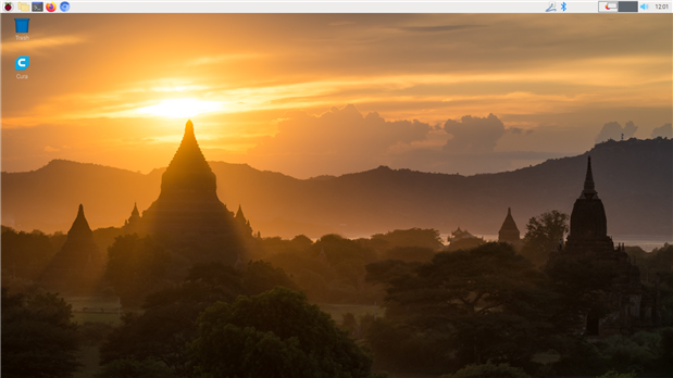

I have an annoyance that, every time I click on the desktop shortcut, a warning is displayed:
don't know how to solve it, yet. But will find out and write about it.
But, and if I want to have a icon in the menus ?
Well, all the applications on the menus have .desktop files in /usr/share/applications
Let's add a new item to the Cura.desktop file and copy it to the folder /usr/share/applications
Let's add the Category option. I'm going to put it in the same category as Slic3r .
Edit your Cura.desktop file and add the following at the end - after Comment (note: It could be placed anywhere in the file)
Categories=Development;Engineering
Now, copy the file to /usr/share/applications
sudo cp Cura.desktop /usr/share/applications
If you go to the menu, you should have a new Cura icon in Programming.

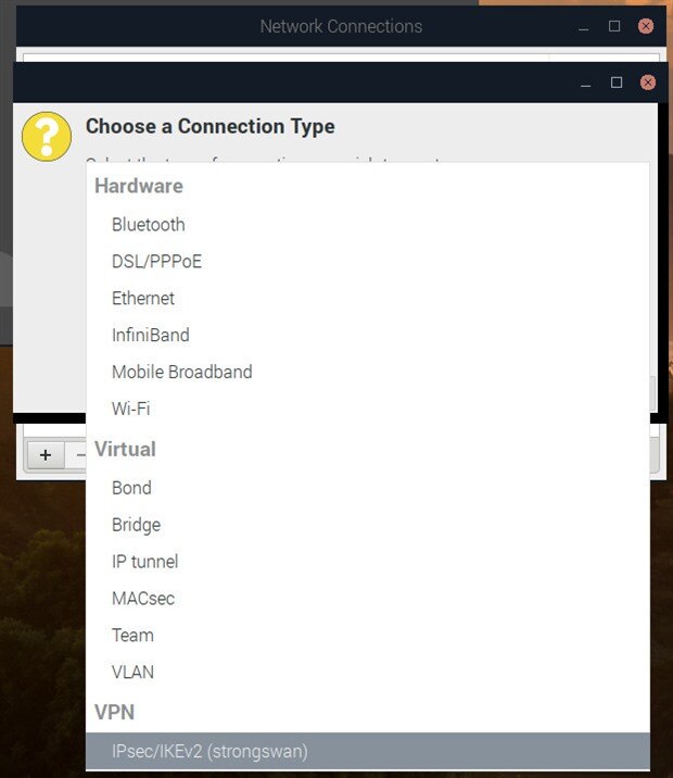

It did install, but, when creating a new VPN connection, I don't see L2TP option. Obviously I did something wrong and I'm guessing some location is wrong.
I did try another go with configure, but still the same outcome... What am I doing wrong ?

    --with-nm-ipsec-nss-dir=/usr/include/nss doesn't look right. It is supposed to be the location of libreswan's NSS directory where the machine certificates are stored. The default location of /var/lib/ipsec…
  • luigi2600
    luigi2600 over 5 years ago in reply to feiticeir0 +1
    For --libdir= configure switch, best to use whatever the other NetworkManager VPN plugins are using, like network-manager-pptp, e.g.: $ dpkg -L network-manager-pptp | grep libnm-vpn-plugin /usr/lib/x86_64…
  • feiticeir0
    feiticeir0 over 5 years ago in reply to luigi2600
    So on x86-64 it would be --libdir=/usr/lib/x86_64-linux-gnu . Sorry if I mislead you, I don't have a PI 400 in front of me, so not really sure which dir it uses.
    I'm not using a 64bit version. Although I know there's a 64bit version for RPI400, I'm not using it. That directory is non existent . The one you gave me works .
    Thank you
  • feiticeir0
    Hi !
    Following your advice, I've removed everything strongswan and installed freeswan.
    Using your configuration parameters, I've recompiled network-manager-l2tp and after a reboot, the L2TP plugin appeared on the VPN options.
    unfortunately, it didn't connect. No more complains about modp1024, I guess thats that.
    It did complain about GatewayID not being resolvable, but I was expecting something like that..
    will need to dig a bit further.  Still, thank you so much for your help
  • luigi2600
    /usr/lib/x86_64-linux-gnu/NetworkManager/libnm-vpn-plugin-pptp.so
    Sometimes you have to restart NetworkManager for it to pickup new NetworkManager VPN plugins
    If you are using libreswan < 3.30 which has modp1024 support as it is built with USE_DH2=true flag by default, then --enable-libreswan-dh2 NetworkManager-l2tp configure script should be all that is required for libreswan modp1024 support.
    If you are using libreswan >= 3.30 then it needs to be built with USE_DH2=true in order to enable DH2/modp1024 support.  If network-manager-l2tp is built with the --enable-libreswan-dh2 configure switch, then all it does is add modp1024 to its default set of Phase 1 algorithms. libreswan will spit the dummy with a modp1024 syntax error if you try to use modp1024 with a libreswan not built with USE_DH2=true. You could add USE_DH2=true to DEBIAN_LIBRESWAN_BUILD_FLAGS if you build a custom libreswan .deb package from the Debian source package:
    • https://salsa.debian.org/debian/libreswan/-/blob/debian/main/debian/rules#L32
    in some cases it might be easier to use strongswan which still has modp1024 support by default, instead of building a newer version of libreswan with USE_DH2=true.
  • feiticeir0
    Hi luigi2600 (Douglas) ! Thank you for the reply.
    I knew that the directory arm-linux-gnueabihf was important because I could see some plugins there. When installed the Network-Manager-L2TP it did place some files there. When compiling, nothing was placed there. I created some symlinks, but still didn't work.
    I will recompile the package and see if it helps.
    Thank you Douglas !
  • luigi2600
    --with-nm-ipsec-nss-dir=/usr/include/nss  doesn't look right. It is supposed to be the location of libreswan's NSS directory where the machine certificates are stored. The default location of /var/lib/ipsec/nss should be fine. The following command confirms /var/lib/ipsec/nss is part of the libreswan package.
    $ dpkg -S /var/lib/ipsec/nss
    libreswan: /var/lib/ipsec/nss
    I think you also need to use --libdir=/usr/lib/arm-linux-gnueabihf
