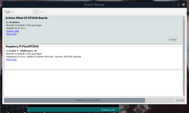

I've installed the Raspberry PI PICO support. Just search for PICO on the boards manager and you'll see it.
I'm doing a thing for my Pimoroni's PICADE - simulate the lights power on on the old arcades cabinets, the fluorescent lights tubes.
I wanted to try the blink sketch first and had a bit of problems loading the sketch. I know that I need to press BOOTSEL button, but still didn't work.
After a bit of googling, I finally found the solution. A udev rule (for Linux) is needed to be added so a normal user can upload sketches to PICO.
Search for post_install.sh or mbed . I found the script in:
/home/pi/.arduino15/packages/arduino/hardware/mbed_rp2040/2.0.0
Just execute the script post_install.sh as sudo
sudo ./post_install.sh
and a new udev rule will be added
