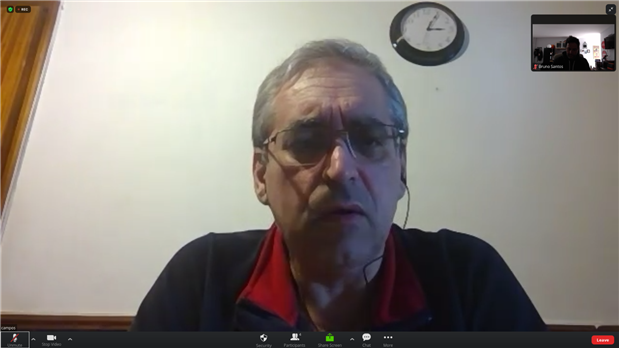

Like before, I knew that a Zoom APP doesn't exist for Raspberry PI arm. Chrome has an App, but I can't work with it, because it just stays there connecting and won't move forward. I have to use the browser instead.  Both chromium and Firefox work.
Like I had tested before, the USB camera doesn't work on Firefox, but this time, there was a part of the meeting I didn't needed it, so, Firefox could be an option for that part - but we will get there in a bit.
The meeting started fine, but along the way, it gets starting slow. The camera freezes - but not the sound. People complained that the camera freezes. Even in the preview, it skipped a lot, but a lot of frames. It was not good.
After a while, I needed to share my screen. Not Chromium nor Firefox were able to do it. Zoom says it's sharing the screen, but all the participants see is my name on a black background.
Amazingly, the sound never failed. image  The camera microphone worked flawlessly.
That's a pity. I thought that the Raspberry PI 400 could be used for remote work and meetings, but this problems make this unusable. I don't know if it was the camera .
NOTE: I realize now that I didn't have the camera (and never had it in previous uses) connected to a USB 3.0 port. Could this be the root of  the problem ? Will test this in future meetings. Although, even watching Netflix, the video freezes every time i move away from it.
