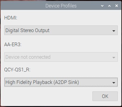

I'm now able to pair, trust and connect to the bluetooth headset - image - but still not much luck.
If I try to connect to the device from the bluetooth menu, I get this message
To connect to the device, right click on the volume ICON and select the device.
I was able to ear a bit of music from YouTube with Google Chrome, but after a while it just keeps disconnecting.

Today, I tested another bluetooth audio device, my QCY T1 earplugs that I have on my work. They worked like a charm.  I was able to pair them using the bluetooth applet - they did that thing of waiting for confirmation, but less than two seconds, I got the successful message.
That's why you're seeing 2 bluetooth devices on the screenshots above.  I will now enable the onboard bluetooth and remove the USB dongle and see if it works .
EDITED: It didn't work... For some reason, I'm unable to pair the device.

I'm having mixed results.
Will now try my external dongle again and see if something works.
With the external dongle, I'm able to connect to my headphones and earphones. My headphones keep connecting and disconnecting, but the earphones work fine.
I can't get sound on Firefox, but Chromium works fine. Apparently there's a problem with Firefox and the latest pulse audio update on Raspberry PI OS. This post is from December 2020.
03/04/2021
Updated Firefox don't playing sounds via bluetooth and pulseaudio is a known bug and still no solution for it. The funny thing is there's some videos it plays, but the majority it won't... Still fighting .
If one executes some commands, everything goes to proper state.
Will try this later.
I will keep the external dongle and use my QCY earphones.

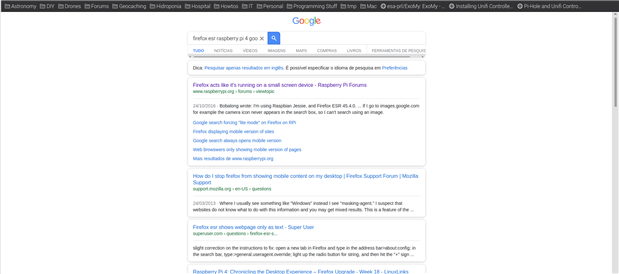

One thing that I'm finding weird is the google search page is half and not the all page. Is it showing like this because of the Firefox version ? Does it thinks it is on a mobile ?
Need to sort this out. I really really prefer Firefox.

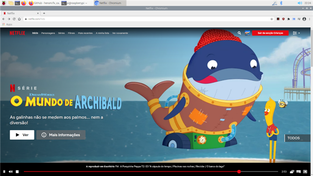

Netflix
Netflix is one site that I visit every day. Whether I'm just relaxing or doing something else and just for the noise - it helps me focus - this was one site that I really wanted to work.
I already knew that it was a possibility. After reading a blog post by VPetkov, I was able to have Chromium opening Netflix and playing. image
A new item was added to Internet Menu and after executing Chromium (Media Edition), here it is:

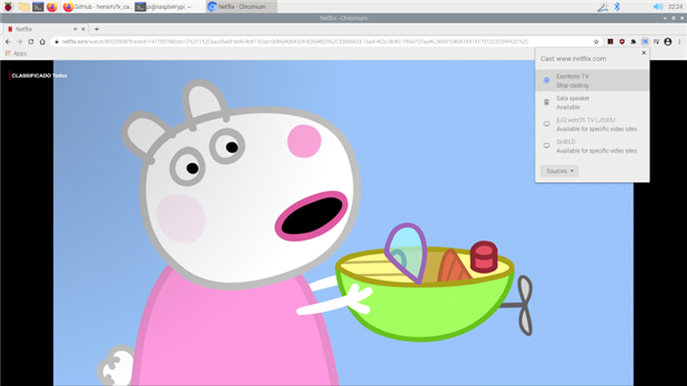

Casting to Google ChromeCast
One of the things I used to do a lot is casting Netflix to my ChromeCast connected to my office TV. My son (4 years old) loves to be with me watching it's cartoons. I use fx_cast on Firefox, but is necessary a companion app. The site does not support arm, but I will try to compile from source and see if I can use it.
Nonetheless, since Chrome can play Netflix and it has support for Casting. I did try it and it work out of the box.
Here's the ChromeCast showing on Chromium Cast Menu (In Portuguese)
I must say that I didn't notice no slowdown or less performance while Chromium was casting.
