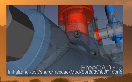

A new item on the menu is present:
Let's start FreeCAD and see.
Hurray, FreeCAD splash screen:
And FreeCAD main window:

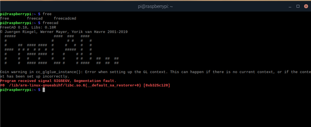

and it crashes when I try to create a new document... What????
And here's the cause (starting FreeCAD from CLI):
After some careful reading, there's a problem with FreeCAD 0.18 and libcoin.
You can see more information here, and here.
Fortunately, there's a solution: Install from source. image

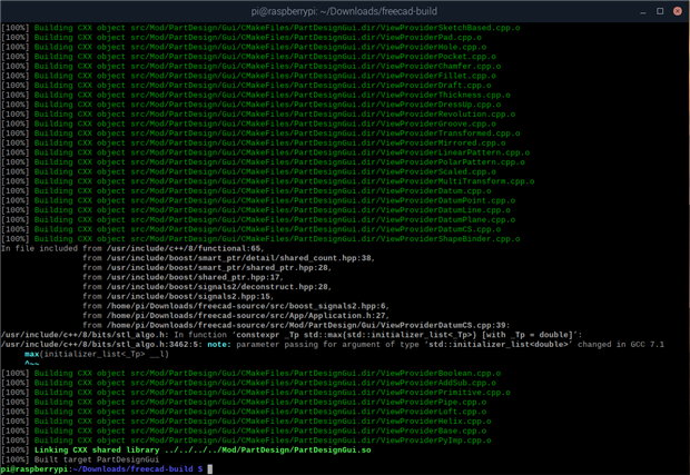

Build it and go to sleep
make -j2
GO TO SLEEP
08/04/2021

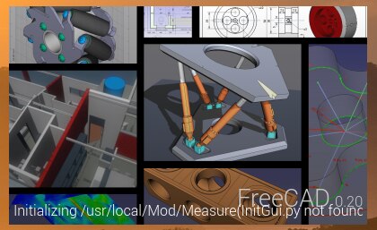

Good morning. Well, it did compile without any errors...
It's version 0.20
and still the same error. It's a freaking bug that is still not corrected.

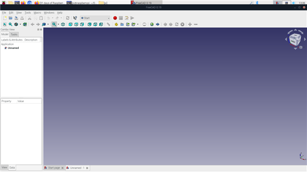

And is now 13:00 (1 PM) and the build is complete. Let's try it before installing it.
Running from the command line
Window open. Let's try and create a new document  - this was were it crashed
And success !
FreeCAD is running after almost 3h compiling

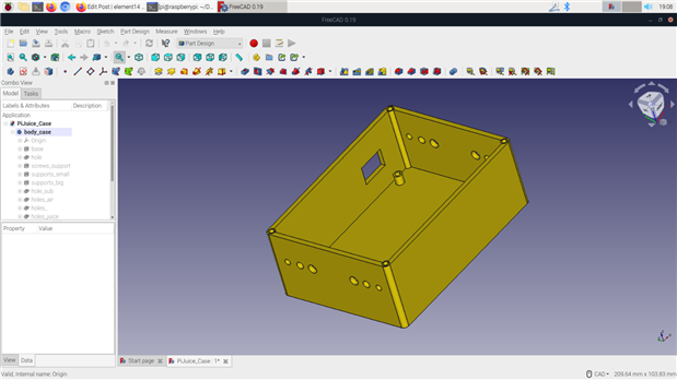

Let's create a piece.
FreeCAD for the Raspberry PI is not slow. It really moves well and it's smooth.
Granted, I didn't create any complicated piece and I know I've done some really complicated that in my desktop was slow. But still, for the first one, not bad.
Let's print it !
