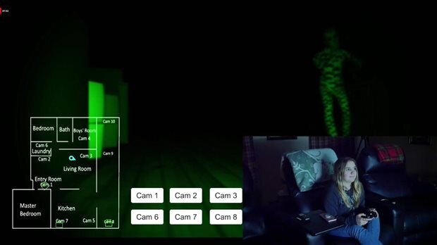

  • Fully Playable 3D Game - built from the ground up:  Son.Light.Sleepwalker
    • Inspired by Five Nights at Freddy's, it is a jump scare game based on a security camera system emulator.
    • The premise of the game is that a 9 year old boy sleep walks and it terrifies his father for some reason only to be understood at the end of the game.
    • If his son wakes while sleepwalking, a jump scare will occur.
    • To get the boy back to the bed, you turn on lights along the path back to his room from your PC or Tablet, but, you can't let him walk fully into any given light - or he'll wake up!!
    • The game is set over 6 nights, each with progressively harder scenarios to navigate him through to get back to the bed.
    • When the user hits Escape to pause the game, they then can hit the letter "m" on the keyboard to enable maker mode.  This allows the game to talk to a Microcontroller that will control the real, physical world around you.  For us, the microcontroller is the Arduino MKR1000.

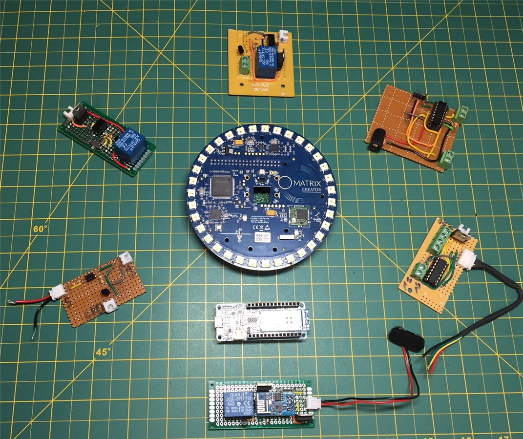

  • 5 Custom Built Circuit Boards
    • ESP8266 5V-24V, 3A IoT Device
    • Any MC 5V Powered, High Power Relay IoT Device
    • ESP8266 5V Powered, High Power Relay IoT Device
    • Two 5V Motor, Forward/Reverse Driver for Any 3.3 Microcontroller
    • Matrix Creator driven sounds and "Boss" jump scare for the finale

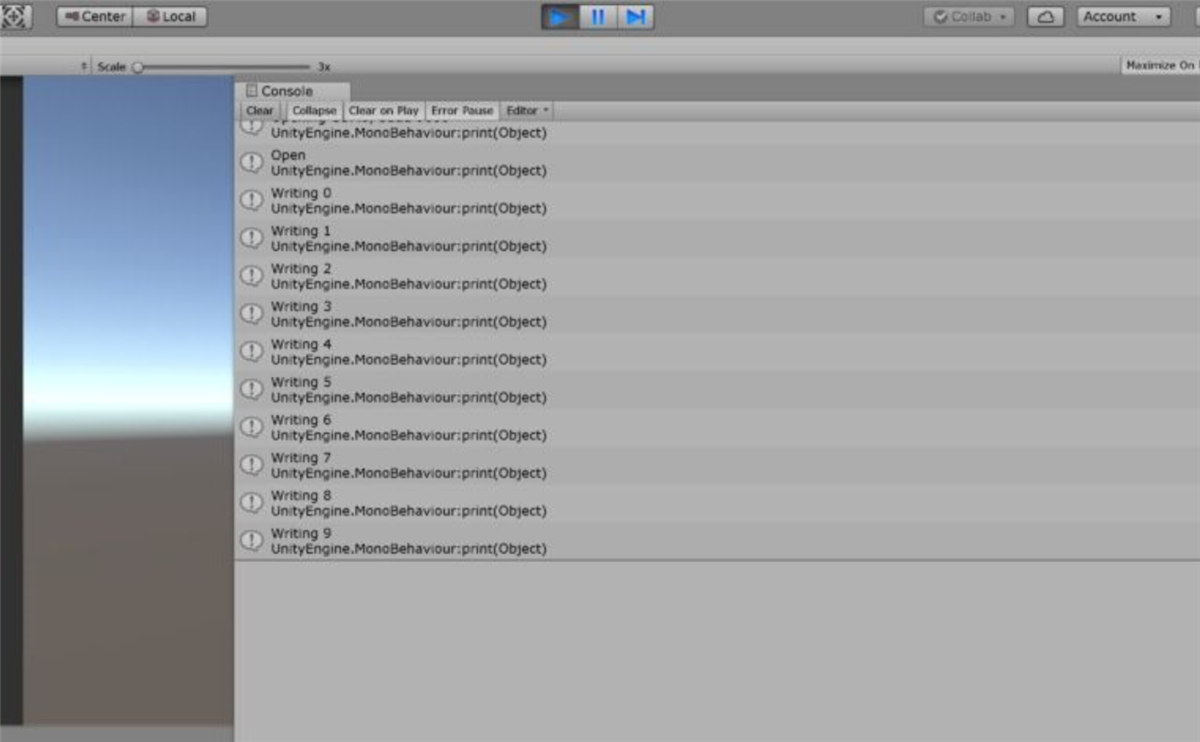

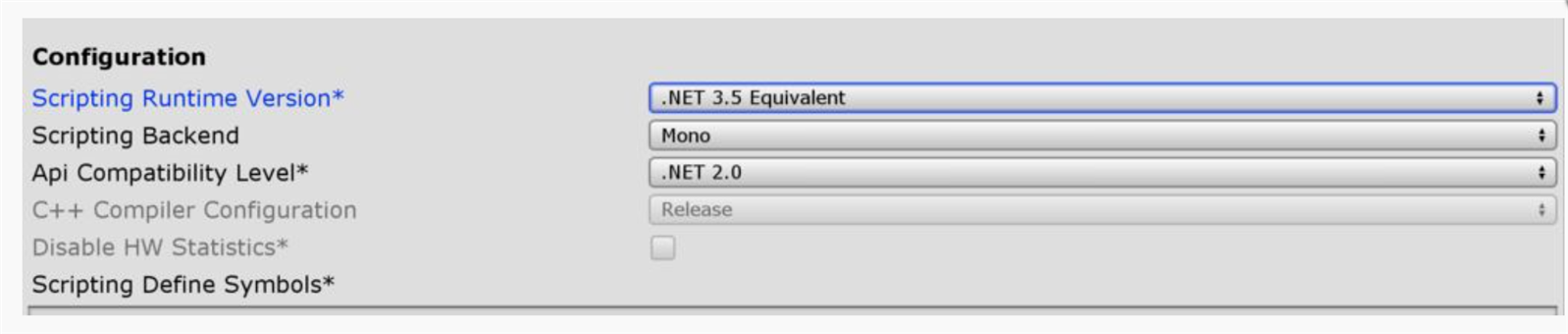

The first challenge was getting the 3D game to talk to the microcontroller.  The game was made in Unity, so the first thing to do was change the Unity game engine to not just use a subset of .Net.  This is done from the main screen of unity under the Configuration settings typically located on the right side of the screen.  Below is how the settings should look to enable COM port access:
Once you have done this, you can now access the COM port.  Here is example code that I attached to the default light source in the Scene that will attach to a com port and push out serial digits to an attached Microcontroller:

Hit play in Unity and you will see the code write to the debug console and your Arduino will blink its LED accordingly.  Once you can get an LED to blink, you can control the world!!! Or at least this game world.  image

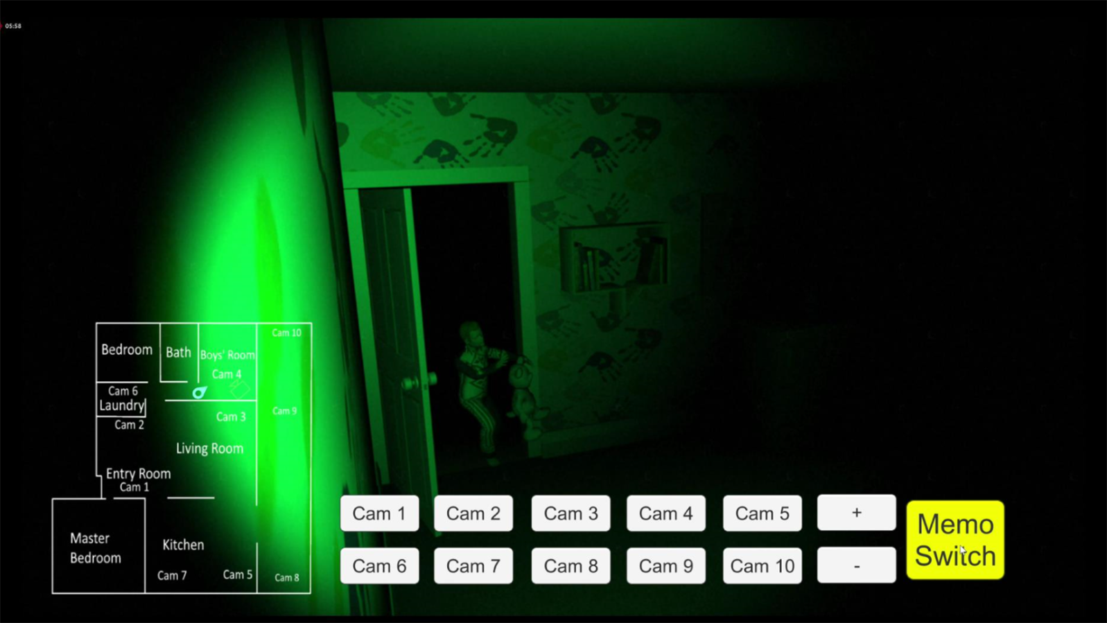

For example, when lightening strikes in the game, a value of 0 is sent over serial.  The Arduino MKR1000 hits the .8A circuit to run a routine that flickers GPIO0 to simulate lightening.  A string of LED strip lighting is used along the wall to give the illusion of lightening flashing outside.
Another example is when we click the "Memo Switch", it turns on a light in our house.

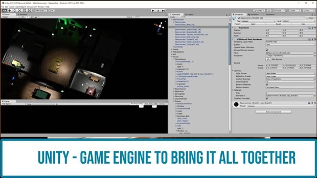

After a few hundred hours of game development using the applications listed above(3D Asset creation, voice acting, sound effect creation, and 2700+ lines of code), the triggering side of our 4D Game Engine was complete:
The 3D Game Making Software
Below are 5 of our top 10 software that one most teach their kids to be awesome!  They are what we used to build our game.

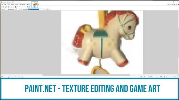

Paint.Net has been my go-to paint program for over a decade.  It has a home right on every task bar in the house.  It is freeware from a university that original was making it as a MSPaint replacement, but Microsoft went another direction.  The features are lean and intuitive - the direct opposite of GIMP, but not as powerful.  However, it does do layering and PNG's - just about everything you need for 3D game textures.

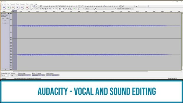

Audacity is another great free program.  It will even handle mp3's with a free addon.  It can handle everything you would ever need for sound effects for a 3D game.  We used it to put the dad's voice in the left ear and the mom's voice in the right ear to give an immersive experience with headphones.

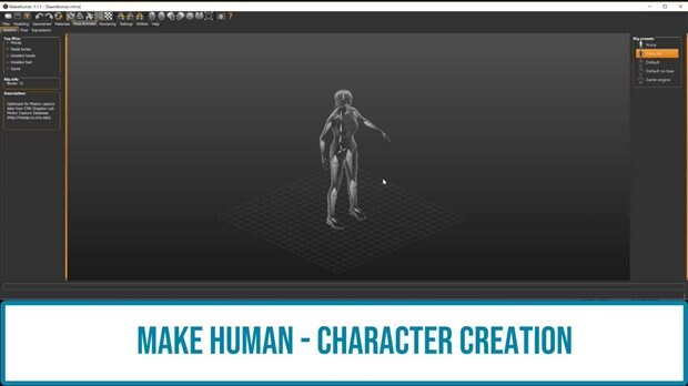

Make Human is a must if you want humans in your 3D game.  It has a full body, face, and hair editor to make fully rigged humoids.  It's also 100% free!  The exports will import into Blender perfectly.

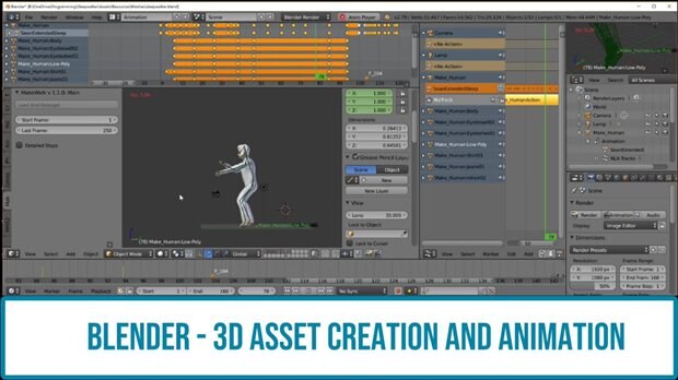

Blender is by far the most difficult software I've learned.  The payoff is huge though as it can be a 3D mesh builder, animator, video editor/compositor, and even a game engine itself.  It can make Toy Story quality animated movies from scratch and is used more and more in Hollywood.  Again, fully free.  We used it to animate the sleepwalker and the psychologist in Son.Light.Sleepwalker.
Unity has made many, many great games.  They have a collaborative business model that allows an ambitious indy developer to take something to market if they have the heart to do it.  If it hits big, Unity still doesn't want anything.  However, if you continue to develop with the tool after making at least $100K, you then have to pay.  It would be worth it.
If you think Unity games suck, it's not the engine, it's the developer.  It's all about the time they put into making good textures for realism.

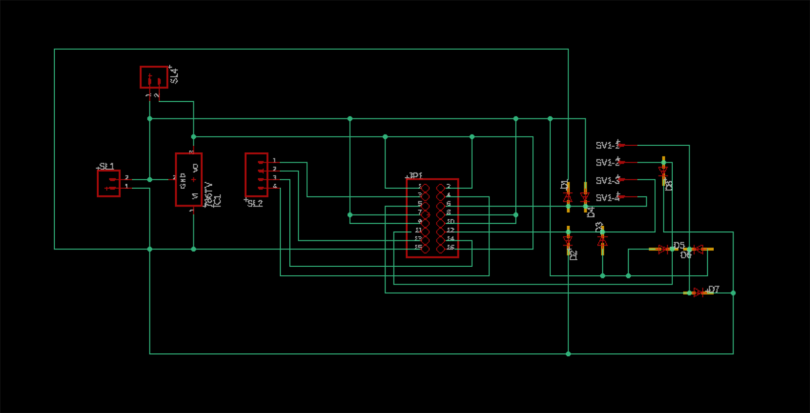

The Circuits

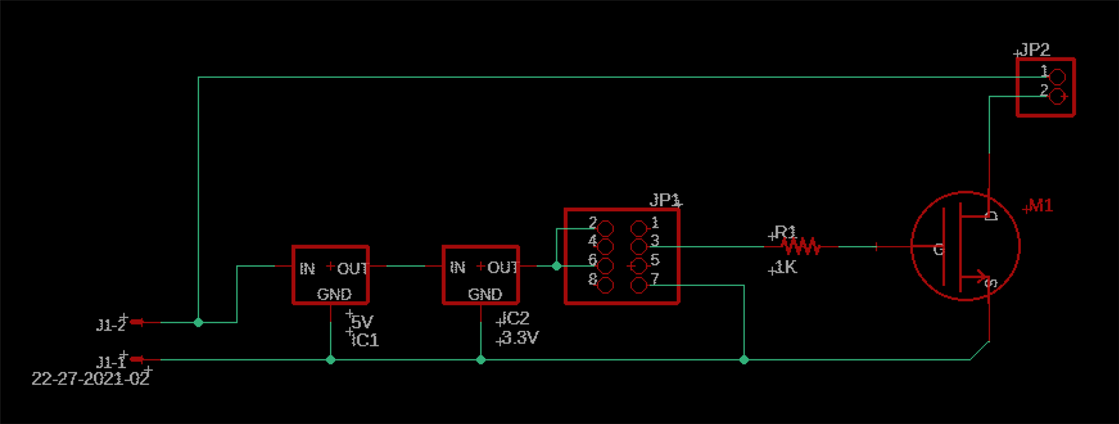

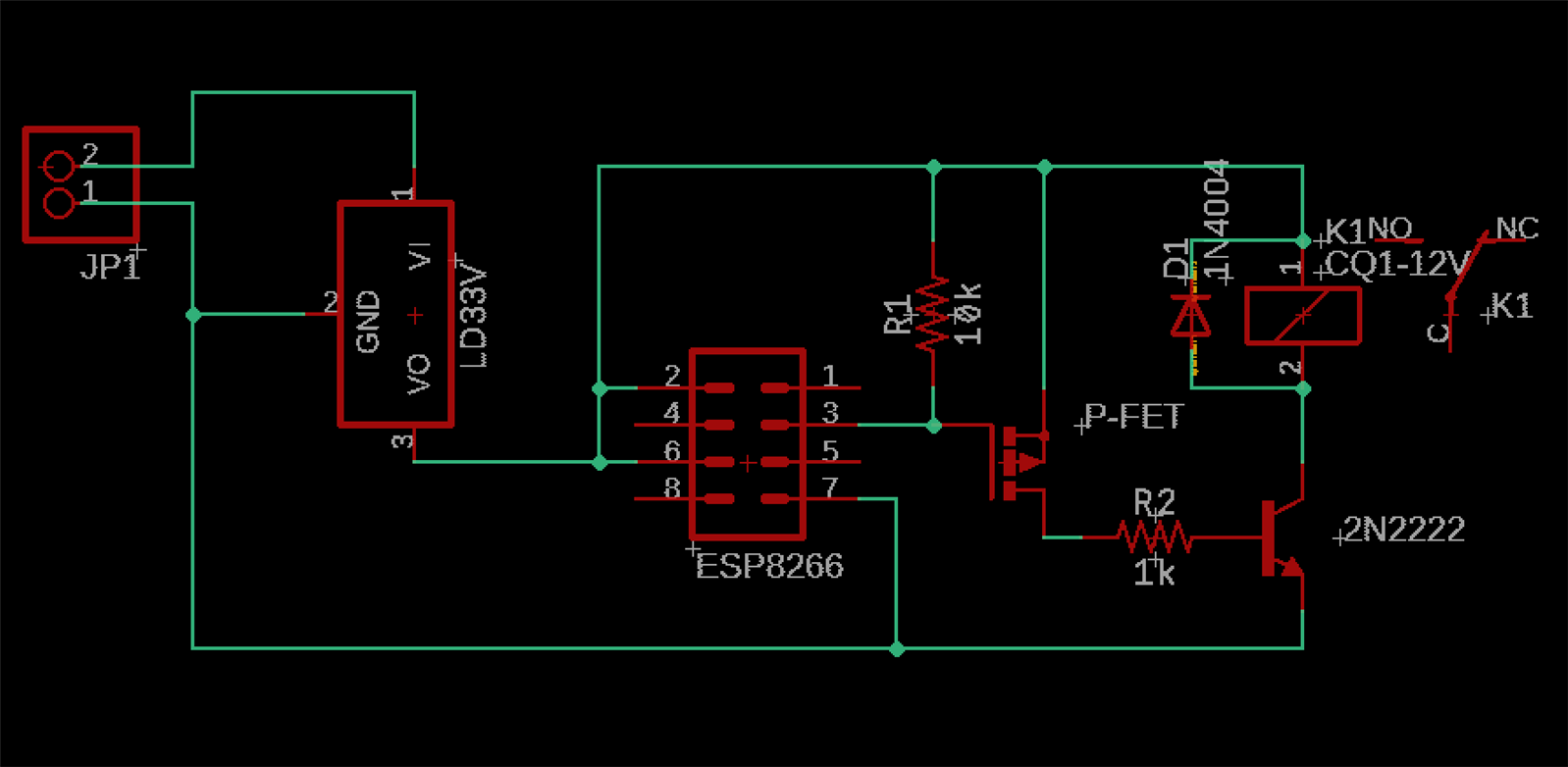

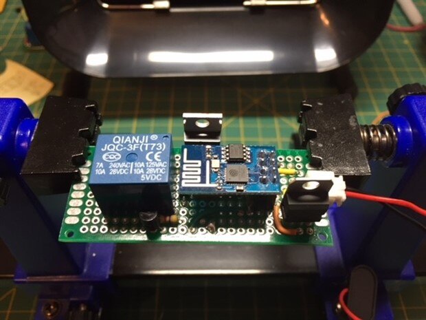

  • ESP8266 5V-24V, 3A, IoT Device
This circuit is designed to use a single large battery source to power some higher voltage DC motors and actuators.  Here are some key features:
    • Battery Source:  any battery from 5V to 24V
    • Power reduced to 3.3V to power the ESP8266
    • ESP8266 monitors its port 4000 for web requests and then triggers GPIO0 (pin 3) high when hit.
    • Can be used to turn on higher power DC motors and actuators via the web.
    • We will use it to rumble Connor's chair using a drill motor.

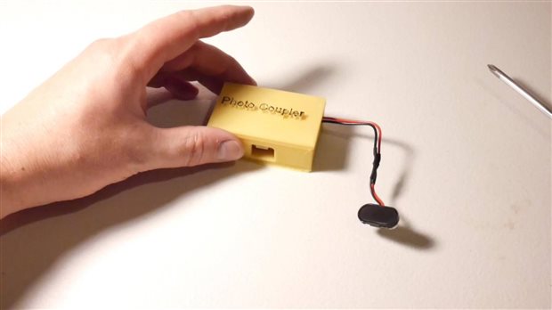

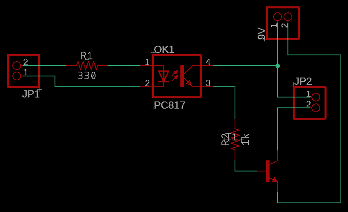

  • Any MC 5V Powered, Photocoupled High Voltage IoT Device
    • This circuit is designed to allow a high signal from any Microcontroller to trigger a 0.8A independent circuit up to a 40 Volt power supply.
    • An optocoupler is used to isolate the two circuits.
    • For the 4D Game Engine, it will be used by the MKR1000 to trigger 9Vs to flicker an LED light strip to simulate lightening in the room.
    • This circuit is designed to electrically isolate the ESP8266 from the high power source using a relay.
    • This allows to switch in AC driven appliances such as tape players and lights.
    • Note the diode to prevent the coil of the relay from generating >200V when the transistor switches off.
    • For our 4D game engine, it will turn on a fan.
  • Two Motor, Forward/Reverse Driver for Any Microcontroller
    • This circuit will allow to drive two motors simultaneously in either direction.
    • It utilizes an H-Bridge chip and is made to accept input from any microcontroller using a 4 pin header.  Note the diodes required to ensure the chip isn't damaged if there is a quick stop or reverse direction.This is only needed for the L493.  The L493D has them integrated into the chip.
    • For our 4D game engine, it will drive a linear actuator to open and close a closet door

Completed Circuit Boards
Making the boards was a great demonstration of practice make perfect.  With our projects, I make one circuit board every other month or so.  Typically, I start out okay, but then end with a rat nest, never really improving on my final presentation between projects.  With this project, I made six boards and the last one took three tries due to complications with how the ESP8266 goes into bootloader mode if a GPIO is pulled down.  Using a clockface for orientation in the picture below, 2:00 o'clock was my first for this project and 6:00 o'clock was my last.  Definitely an improvement!
Here are the board descriptions pictured below
Center: Matrix Creator/Raspberry PI (purchased, of course).  Under that is the Arduino MKR1000, also purchased.
12:00: Relay circuit Relay circuit for ESP8266 for switching AC or DC up to 10A
02:00: H-bridge to drive two motors from any microcontroller up to 1.5A at 5V
04:00: Another H-Bridge to drive two motors from any microcontroller up to 1.5A at 5V
06:00: Another relay circuit for ESP8266 for switching AC or DC up to 10A
08:00 Photocoupled circuit for switching up to .8A @ 40V DC
10:00 Another relay circuit for ESP8266 for switching AC or DC up to 10A
This is the close up of the last board made - much better than the first five:

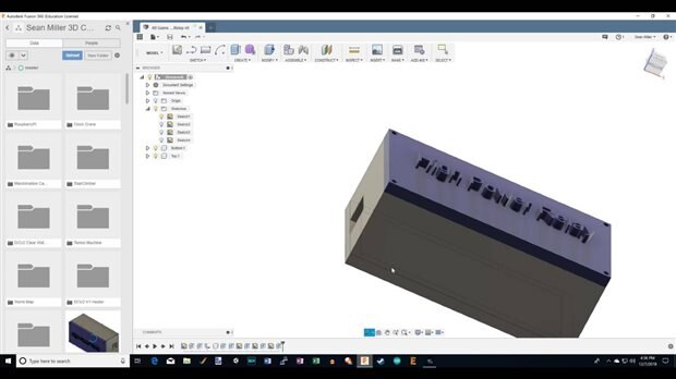

3D Printed Parts
          The prototyped board enclosures were designed using Autodesk Fusion 3D.  It is in our top 5 favorite software packages (if not the top).
Our printer is from XYZPrinting.  It is a DaVinci 1.0 Pro, which is much improved over the original Davinci 1.0.  It now allows for third party filament and has an aluminum bed.  No more glue stick and broken glass!
