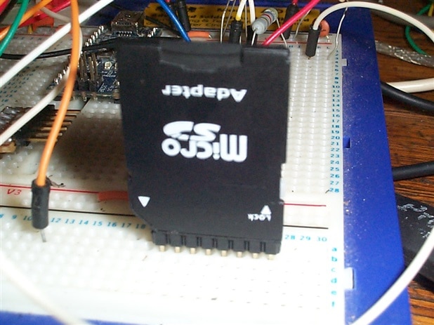

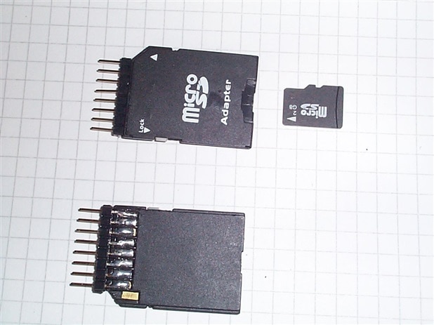

needing a memory card adapter so that I can continue experimenting with USB classes, I realised I hadn`t got any way of interfacing them to my circuit, so Last night I had an idea, and built a couple of them this morning.
I realise it`s so simple and inexpensive, But I thought I`d share it with you all anyway in case there`s someone else out there in the same position.
the pictures will explain it all:
and that`s it!

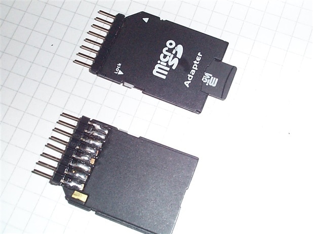

just leave the Micro SD card out of the adapter when soldering the pins on image
