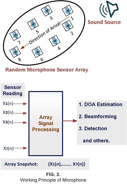

2.3. Working principles of Microphone Array
A microphone array is used to filter audio signals by spatially sampling of their wave-fronts, in a space-time domain. Each Microphone provides one spatial sample of the input sound pressure variations as its output. The Microphone Sensor Array can be regarded as a single device that assembles the individual spatial samples from its elements, i.e. Microphones and transforming them into the desired result, i.e. Vector of Spatial Samples or Signal Vector. Further,
  • Spatial Sample
The measurement of single Microphone at specific location
  • Array Snapshot:
A single observation, i.e. Signal vector or set of Microphone measurements at given temporal instant is called Array Snapshot
Microphone array system samples signals both in the time-domain, i.e. snapshots and also in spatial -domain, i.e. sensor observation at specific location. The Array snapshots i.e. Vectors of Spatial Measurement can be subject to further processing by using a suitable filtering algorithm. This filtering may be expressed in terms of dependence on following factors
  • Angle of Arrival
  • Wave-number, i.e. spatial frequency of a wave. It is also called as propagation number  and is defined as the number of wavelengths per unit distance, or in terms of wavelength
