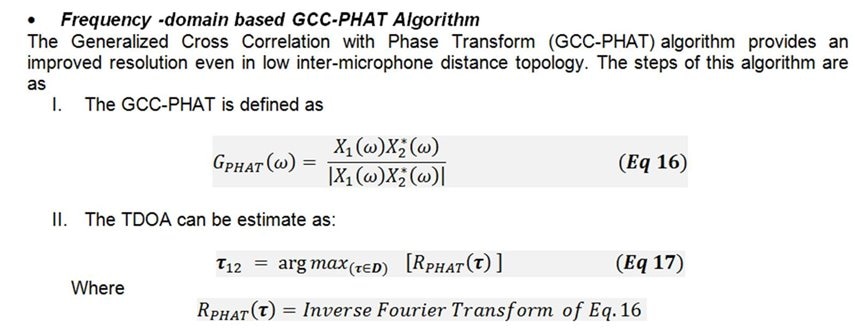

The Time Difference Of Arrival (TDOA) or Time-Delay-Estimation (TDE) is estimated by using following mathematical methods
  • Time-domain computation based Cross-correlation
  1. The microphones of an array  that has only two microphones, are expected to record two delayed copies of the source signal, along with some disturbs (environmental noise or reverberation)
  2. If the strength of the input signal is higher than noise magnitude, then TDOA can be estimate by cross-correlating the individual microphone signals. The cross-correlation of the microphone signals is given by the inverse Fourier Transform of the cross-spectrum:
III. The TDOA is estimated as the time-lag that maximizes the cross-correlation function, within a valid time interval:
The resolution of cross-correlation based method depends on both the sampling frequency and the distance between microphones.
