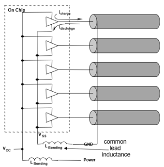

Figure 1: Shown are five I/O drivers within a package driving signal lines on a PC board
Figure 1 shows a few I/O drivers within an IC package (contained within dotted rectangle) feeding signals to some transmission lines on a PC board. The five I/O drivers shown share common Vcc and Vss rails on the die. As the drivers' signals go off chip, they'll traverse leads that reach from the die's bond pads to solder balls on the PC board and then to signal traces on the PCB. The common Vcc and Vss leads connect to solder balls on the PCB and connect to the PC board's ground and power planes.
As these I/O drivers push signals to various on-board destinations, suppose that the top four drivers in Figure 1 are switching, while we keep the bottom of the five drivers tied low, connecting its output to the Vss rail on the die. Say our four switching drivers make a transition from output high to output low, sending the charge stored on those transmission lines heading down the Vss rail into the board's return plane. That current will reach the ground plane, then travel underneath the signal lines. All of the switching current will have passed through the common lead inductance in the package.
When you have a transient current, a ΔI/Δt, traveling through the inductance of this common lead, a voltage results. Thus, the Vss rail on the IC package side of Lbonding in Figure 1 will have a higher potential than the Vss rail on the PCB ground-plane side of Lbonding. It's that connection between the package's solder ball to the PC board's ground plane that the current flows through to make its way under the signal line and continue its journey down the transmission line.
When that current gets to the solder ball, it encounters a low-impedance path in the ground plane. However, in leaving the package and passing through that solder ball, the current is constricted and forced through a narrow path in a common lead, which means there's a little more inductance in that path. So when we get the ΔI/Δt of the I/O drivers' switching, we'll have a voltage on one side relative to the other, and that voltage is connected to the fifth driver that's pegged low. We will see that voltage on the output of the low driver, and that little voltage bounce on the die side of Lbonding is going to propagate on the driver's associated transmission line and reach whatever that line is connected to as though it were a proper signal.
This quiet-low I/O driver is the key to diagnosing and evaluating ground bounce. By looking at this driver's output, we can deploy it as a sense line to tell us what the voltage is on the die's ground rail relative to the PC board's ground plane.
