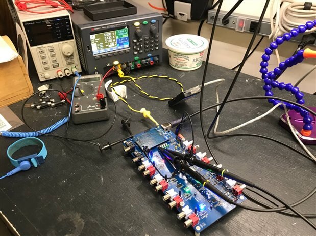

I'm currently working on bringing up a board for a piece of hardware I've been working on for a little over a year. You can read more about the history of the project on my project website if you're interested. This post is a work in progress; I hope to update it as I progress to a complete, fully functioning board.
This particular batch of PCBs is the second revision for this project, so hopefully I've managed to correct all the glaring errors from the first revision without making any new ones!
I started by making a detailed plan for the bring-up order, with the codec power supplies first, then the difficult-to-solder QFN codecs, then the rest of the board components. Things went extremely well for the first step of the plan, which may be some sort of record. I had very little trouble mounting the two LDOs and their support passives, and both supplies were easily verified.
Next up, the itsy-bitsy QFN-package codecs. What could possibly go wrong? A lot, it turns out. First, I applied too much heat to the PCB attempting to prep the exposed ground pad in the center, peeling up a signal trace from the analog input section. I started over with a fresh PCB (AllPCB's minimum order is five pieces, and they frequently send more than that; I got seven pieces with this order), and this time I went straight to working on installing a codec. I used lots of flux, but I also attempted to fasten just two pins of the codec before going to work on the exposed pad. Unfortunately, this resulted in the part sliding slightly off-center.
After chatting with the senior engineer at work, I started again a third time, with a new strategy. Per his suggestion, I applied solder to the exposed pad on the part then removed it with solder wick to prepare the pad. I then soldered all the outer pins using my 70W Weller iron, a magnifier, and a lot of patience. I inspected the joints using a USB microscope, and re-worked the pins that needed attention. Afterwards, I tried applying solder to the back side of the PCB to fasten the exposed pad, but my first attempt appears to have been unsuccessful; I installed the bias and reference capacitors and applied power, but the part doesn't power up. It's sinking about 25uA of current from the +3.3V rail, but nothing from the +1.8V rail. My plan for the next step is to take the board in to work and try to attach the exposed pad with the Metcal iron I have there.

    I know two good ways of attaching QFNs (short of spending loads of money). If you are going to use a prototype technique it is a good plan to have a hole (or holes) in the big centre pad - this gives the…
  • michaelkellett
    michaelkellett over 8 years ago
    If you are going to use a prototype technique it is a good plan to have a hole (or holes) in the big centre pad - this gives the solder somewhere to go and allows you to inspect the soldering.
    The pcb should be (ideally) immersion silver or ENIG finish (not HASL - it's too lumpy).
    Apply solder paste (preferably tin lead for the forgiving wetting and melting point characteristics).
    If you have a silk screen machine or jig then that's by far the best way to do it, but if not, use a compressed air type syringe dispenser and if you haven't got that apply it carefully with a pin. It doesn't matter if the paste bridges the pins but try not to bridge the pins to the centre pad. Use decent solder paste if you can afford it.
    To reflow the solder use a hotplate (at 215C for leaded solder)  - if you have access to a reflow oven then use that of course. Just plonk the board (gently) on the hotplate and wait until the solder paste melts all round the QFNs, then give it another 20 seconds or so.
    Remove from hotplate.
    Once the  board is cool you'll see lots of shorts between pins (the more so if you didn't use a solder stencil) but you can clear these with a pointy soldering iron and a watery consistency flux (not the junk that comes in little tubes for hobby stuff). I use Warton Metals Future 315.
    I really, really do NOT advocate removing pins from a chip - you'll almost certainly screw up the seating plane by making lumps on the bottom of the chip. Excess heat should not be a problem - just don't use excess heat. Your hotplate or reflow oven should be at save temperatures and a needle point soldering iron at 360C can't get stuff very hot.
    In the past I've used hot air (from above and/or below the pcb but it's much harder to control than the hotplate. My hotplate came from China (via Amazon) and cost about £140. The solder dispenser thing came from China as well (direct) and was cheap (£100) but is pretty rough. You need a compressor as well to drive it.

  • rusgray
    rusgray over 8 years ago in reply to michaelkellett
    I think I may have been unclear about the pad removal. I'm talking about the tiny rectangular copper pads on the PCB that are associated with the thirteen floated pins from the codec. They're not attached to traces or pours of any sort, so they can peel up if too much heat is present (this happened on the board that I worked on with the senior engineer, which I think is why he made the suggestions he did.)
    I'm still not sure if I want to do it (because obviously there is the risk of slipping and damaging adjacent pads.) I have enough boards and codecs that I can afford to try the hand-soldering method I just learned and still have enough left to try other approaches, so that's the current plan. I'll definitely look into the equipment and methods you've suggested. I already have a hot plate, but not any of the rest of it.
  • michaelkellett
    michaelkellett over 8 years ago in reply to rusgray
    Ah, taking the pad of the board makes more sense, but I wouldn't if I was re-flowing with paste. If you are pure hand soldering it might not matter.
    One good thing about paste and re-flow is that the component will self centre when all the solder melts.
    If, as I suspect, the holes in your centre pad are connected to the ground plane then my experience is that it will be very hard to get it hot enough to reflow solder on the chip.
    The only way I've ever had any success doing this (when having to change a chip on a completed board) is by using a Metcal temperature controlled air blower from the under side of the board to get the whole board (around the chip) up to about 100- 120C (checked by IR thermometer) and then applying top heat with an air gun while watching for solder melting.
    Good luck - I'll be interested to hear how you get on.

  • rusgray
    I've managed to get one codec attached to the board rather nicely with hand soldering, and no pads peeled up. After reading through the codec data sheet again, I discovered that the exposed pad is for thermal dissipation only, and does not have any electrical connection. Since I'm not using any of the built-in amplifiers and the total power consumption of the part is very small (<25mW), I've elected to try to turn on the codec part before attaching the exposed pad, a process that's been significantly slowed by the untimely demise of my codec dev board. If I can get the codec to wake up and operate at/near ambient temperature without the exposed pad connected, I may skip the exposed pad connections for all the codecs on this project.
    In future projects, I'm definitely going to design the EP mounting areas differently; I'll make a smaller number of larger vias (ideally big enough to get the finest tip of my iron all the way through to touch the pad on the part itself) and use thermals on the EP vias to make it easier to get the pad hot enough.
