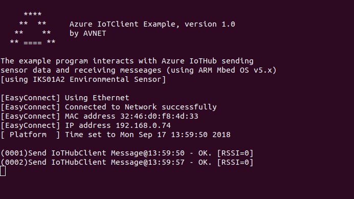

Now, you have a program that works using a cellular connection, but the beauty of ARM Mbed OS, is that once that is done, it is trivial to switch it to other transport methods. For example, when I was starting to work on this project, I implemented it using an NXP K64F board with its integrated Ethernet interface. This allowed me to get all the mechanics of building the SDK, the OS, and integration while using Ethernet and once I was satisfied with that, I switched over and and used the BG96 Interface.  It is always good to minimize the number of variables when working with new hardware or technology and because I didn't know what issues I would find with a cellular interface, I chose to start with a known, mature, and stabled Ethernet Interface.  So to make it easy, the first port will be to convert the current project back to an Ethernet transport.
Ethernet with the NXP  FRDM-K64FFRDM-K64F Board
I used the following hardware to run on Ethernet:
  • NXP FRDM-K64FNXP FRDM-K64F
  • X-NUCLEO-IKS01A2X-NUCLEO-IKS01A2
After mounting the IKS01A2 on the K64F and connected the Ethernet, I modified the mbed_app.json file by changing the network-interface from its original configuration:
        "network-interface":{
            "help": "Options are ETHERNET, CELLULAR_WNC14A2A, CELLULAR_BG96",
            "value": "CELLULAR_BG96"
To the new interface:
            "value": "ETHERNET"
You would normally have to also modify the User Button active state from Low to High(the K64f is active low vs the NUCLEOL496ZG which is active high but I have already included this is the mbedapp.json file at line#43 After the mbedapp.json file changes remember that for the NXP  FRDM-K64FFRDM-K64F board the target of our project is K64F rather than NUCLEOL496ZG so compile the project
mbed compile -m K64F -t GCC_ARM --profile toolchain_debug.json
Then copy the executable image to your K64F board to run it.  When it starts up the startup display now says:
Now when EasyConnect makes the connection to Azure, it uses Ethernet instead of BG96 and all message traffic will utilize a wired Ethernet connection.  Beyond the change in transport, the operation of the program is the same.  You may notice that now the RSSI is reported as 0 and this is because I have specifically set it to zero if you have not selected BG96 as the network-interface.

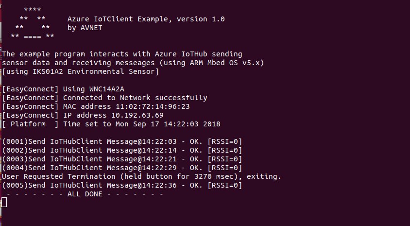

Because I had an AT&T Starter Kit (Available from AT&T IoT Starter Kit by Avnet), I decided to also port this project over to it.  Essentially, this kit does the same thing that the current example project does, only it uses a LTE-M cellular modem instead of a NBIoT cellular modem (https://www.iot-now.com/2016/06/21/48833-cat-m1-vs-nb-iot-examining-the-real-differences/ Like when using Ethernet this Kit uses the NXP  FRDM-K64FFRDM-K64F board so the target of our project is again K64F the other differences between the original and this version is that now our network-interface is set to CELLULAR_WNC14A2A rather than the original CELLULAR_BG96.
            "value": "CELLULAR_WNC14A2A"
Again, compile the program:
Then program it into the K64F board configured with the WNC14A2A Cellular Shield, again, the program operates exactly as it did in the original project, only now, the program is running on an AT&T Starter Kit
