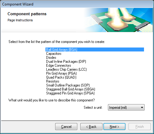

But then, this morning, I saw a forum post associated with an Australian EE Blog where someone "found" the component wizard in CS. Here is how to access it in CS version 1.3. I always used the IPC one in AD, so this seems a bit hobbled, but it is quicker than putting down each pad and component feature individually. The hardest part is finding it.
The quickest way to find it is to enter "Component Wizard"  in the search bar. You'll see this below. You can click on the "Component Wizard" but the IPC one does not seem to do anything.
The forum post I read showed a more indirect way to find it. With a PcbLib file open, click the PCB Library tab at the bottom left of the screen. then right click on the components pane title bar (Look for: "Components"). this will give you the dialog box shown. Note the component wizard is the second entry.

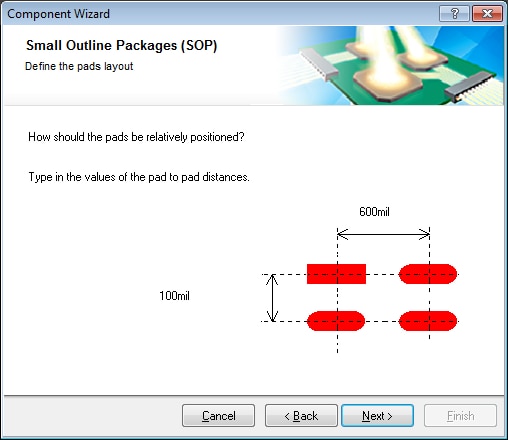

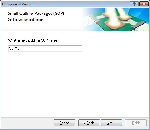

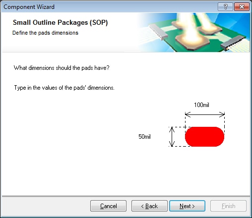

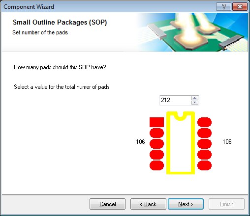

So, what is in the Component Wizard? Take a look at the screen shots showing the interesting steps:
I selected SOP to give a better idea of how this differs from the IPC wizard in AD.

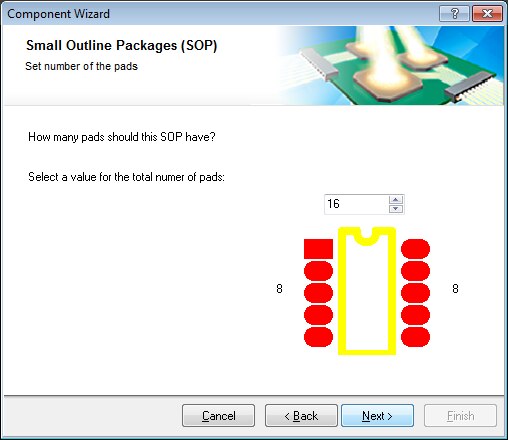

Above, I just wanted to see if there was an upper limit on the number of pins. I stopped at 212, but it would have kept going...

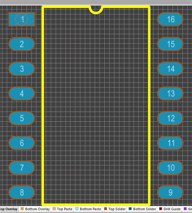

Then it finishes the Wizard to produce this:
