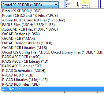

    antosh over 9 years ago in reply to otto-shop
    Andy,
         Here is a screenshot that shows the file types and formats CS will import. I have not tested any of these.
         Hopefully this is helpful.
         Cory
    Andy,
    CS does install on your computer and you do need to be connected to the Internet to install the software. It took about 6 minutes to download on my machine. I have confirmed that after it is installed, it will run without Internet connectivity. I have the licensed version on my laptop and did some of the roadtest while on an airplane w/o Internet service. While it did run, a non-surprising result was that datasheet links didn't work.
    I have not yet tried import / export, but it does have support for Eagle, Protel99SE, Orcad, PADS, and Autocad PCB. I was also happy to see an announcement for support of Altium SchLib and PcbLib files, in addition to IntLib files. I will try importing some of those files. As for export, I will dig around some more, but all I see is the option to save files in the Altium formats (SchDoc, SchDot, and a new format for the PCB files: CSPcbDoc). Projects are saved as PrjPCB files.
    I will also say Gerber and NC Drill files generation is super easy with a "Generate Outputs" button right on the ribbon interface.
    Keep in mind you can obtain a free 30 day license. That is what I have running on my desktop machine for now.
    Cory
