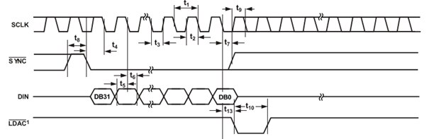

The SCLK is the SPI clock, LDAC is a signal that allows the newly programmed configuration to become active, when LDAC=’0’, SYNC acts as SPI slave enable and Din is the input for the data. In this IP the LDAC is permanently set to ‘0’, so the DAC configuration is enabled as soon as the programming operation is completed. The SPI functionality is quite simple – The SPI takes transmission composed of 32-bit packages, each beginning by pulling the SYNC signal low. In the same time the data is being sent by starting with the MSB. The SCLK is used to synchronize the SYNC and the DIN signal.
AD5065 SPI timing diagram
The 32-bit word that is sent to the SPI has the following structure:
Figure 3 SPI data structure

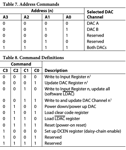

  • Bits 31 to 28 are not unused.
  • Bits 27 to 24 are used to store the command tha the user wants to execute.
  • Bits 23 to 20 are used to select the DAC that the use wants to configure.
  • Bits 19 to 4 are used to store the DAC value that the user want to write to the DAC.
  • Bits 3 to 0 are not used.
AD5065 command and address bits definition

In this code it can be seen that there is a offset of 66060288. This value equals to 11111100000000000000000000, which is the binary equivalent of the command that is writing and updating both DACs. The data is multiplied by 16 because the 4 LSBs of the SPI are not used, hence the value has to be bit shifted to left, which in this case is implemented as multiplication. One last thing - because the 4 MSB and 4 LBs of the SPI are Don’t care bits, even if the user writes something to these bits, the SPI will sent out 0’s.
