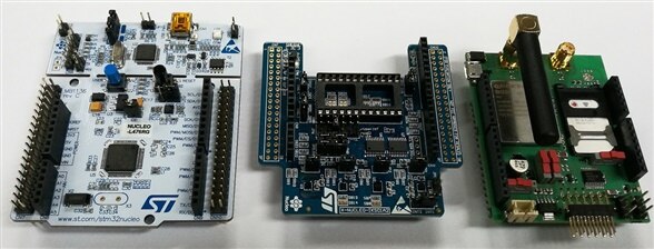

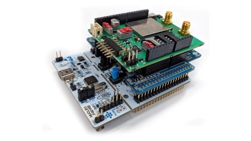

I used this MQTT implementation with the Avnet NB-IoT Sensor Shield (Available from https://www.avnet.com/wps/portal/silica/products/new-products/npi/avnet-nb-iot-shield-sensor) sensor board in combination with a X_NUCLEO_L476RG SBC and X_NUCLEO_IKS01A2 sensors expansion board.
