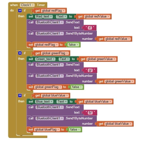

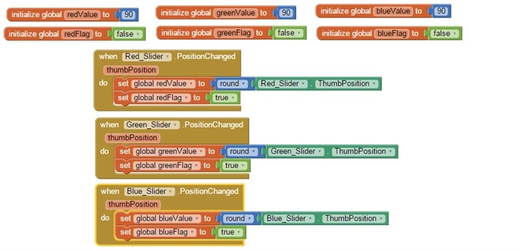

    Well done! You are nearly there image  The trick is to add an identifier to the data sent from the Android and then to detect that identifier in the Arduino sketch.
    Here is my solution for controlling a tri-colour LED. You'll notice that I don't send out the slider reading as soon as it's moved, but send out 1,2 or 3 readngs at regular intervals controlled by a clock
    First the set up and slider blocks:
    Next the data transmission blocks:
    As you can see, each slider value is preceded by an identifier - "r/", "g/" or "b/"
    Here is the business section of the Arduino sketch:

    This did work when I created it over a year ago; I confess I haven't tested it again before posting it for you.
    I hope it gets you on the right track.
    Best wishes
    Neil

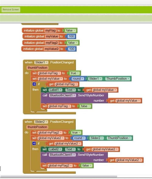

    Hi Neil
    as a follow on to  previous query, worked on your slider  blog (3 ) all worked  but I need to control 3 sliders to control in Arduino.
    have tried extending your initial guide but failing ... basic help / guidance be appreciated. Iread in your blog about 3 slider control for a RGB led but could not locate.
    problem with this set up trying to control 2 led's but no  matter which lider I move  just controls one LED !
    enclosed  following  mit api2  blocks and Arduino basic sketch
