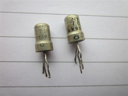

Quite a few months ago when i was building the silicon Fuzz Face pedal Jon Clift sent me 2 old germanium transistors. These transistors are from the 60's I believe and it's thought by Jon that these transistors would be good built into a Fuzz Face pedal. A while ago I built a silicon transistor based Fuzz Face pedal, and said that in the future I would make a germanium based fuzz, well this seems like an opportune moment to build a germanium fuzz and try the transistors Jon sent me. The transistors are old Sony transistors, one has a gain of about 30 and the other about 50. They're both NPN. The only information Jon could find about the transistors on-line says that they are germanium. It looks like that's right - the base-emitter voltage using the meter's diode test is 490mV in one case and 530mV in the other, which is lower than you'd see with a silicon device.

For this build I'll be using the same schematic and possibly PCB layout I used for the silicon Fuzz Face. I'll also wire it as per the silicon, as these germanium transistors Jon sent me are NPN, not PNP as most germanium transistors are that are used in fuzz pedals. i'm really interested to hear how this will sound once finished. Depending on the pin outs of the transistors will dictate what board I use, I don't want to do too much twisting of legs so will use the board layout that will suit the transistors. The issue 1 board was created for the early germanium transistor Fuzz Faces, the issue 2 board was developed for the later silicon fuzz Faces. You can see that the base and collector are swapped around on the 2 boards, so the transistors likely will suit one of these boards. Either way I'll follow the schematic for the silicon transistor Fuzz Face as the transistors are NPN the polarised capacitors will be correctly orientated on the silicon schematic. If the transistors were PNP the polarised capacitors would have to be turned around on the issue 2 board.
Once again, as before I'll etch my own board. I've found it easy etching small boards, but when you get into the realms of boards around the 3" x 3" size and larger distributing the heat across the board evenly is a lot harder. I generally end up with some tracks missing, etc which require a bit of precision Sharpie work. Looking at the paperwork that Jon thoughtfully sent with the transistors he's advise me that the pin outs are CBE so I'll use the Issue 1 board, as there'll be no leg twisting involved. On with the etching.
