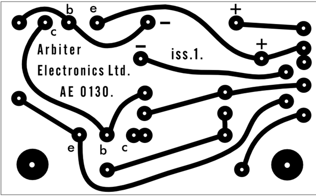

here is the schematic and PCB layout that I'll be using for the build

The PCB layout above which i'm using for this build is actually the issue 1 layout for the germanium Fuzz Face which was positive ground, therefore I'll have to remember to change a few components to ensure they work in a negative ground build. Notably the 2 polarised capacitors the 20uf and the 2.2uf will need to be turned around or it won't work. the transistors i'm going for are BC183L in Q1 and a BC183LC in Q2. This is a recommendation as they're exactly the same as what are in Eric Johnsons Fuzz Face, also the  hfe of each transistor has been matched to be the same as Erics fuzz Face.

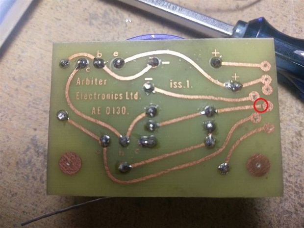

so, here is my etched board ready populated.... you can see I had to twist the legs of the transistors slightly as the pin outs are different for this board. I've also used period correct parts, not that they sound any different from modern components but they just look "right", and as usual for my own builds I'll try and keep the components as authentic as possible. Hence the carbon comp resistors, and the flat polyester cap. The only brand new part is the 22uf polarised cap, that's a modern Vishay cap I had left from the Power Boost build. The 2.2uf cap is a NOS philips.
PCB Board
Component side
You'll notice that comparing the photos of my board and the original some of the components are in a different place. When I populated my board I followed the schematic and not the photo, transistor Q2 (The bottom one in the photos) is in a different position on this board to the original. I can only assume that in 1968 when they first brought out the silicon versions of this pedal they changed the board layout to compensate for the changes etc. however, nowadays it's standard practice in the pedal building fraternity to use the same board for both and just make the adjustments with components placement and orientation during soldering. Also I'm using a 22uf capacitor instead of a 20uf... This is purely down to availability, I also don't think it'll make much difference to the end result as I've seen Fuzz Faces with 22uf caps in as well as 20uf. I also had 22uf caps left over from the Power Boost builds.
The wiring diagram for the various parts of the PCB are as shown in this diagram here.... Obviously I'll be using the NPN Silicon diagram on the right. Here you can also see that my component placement is as shown in this diagram. (This diagram was supplied to me by the guy that created the PCB layout... PigeonFX)

I did have one issue with the build however and that was after wiring it, i had no sound..... not a peep, so triple checked the wiring to ensure it was correct, and also rechecked the placement of the components. I then got my multimeter, and started checking continuity across the board. that's when I saw this............ A small break in the track for the positive battery lead. i simply re-soldered a bridge across from the pad to the track and it burst into life. i'll post the video in a few days once the tripod adaptor has arrived.
