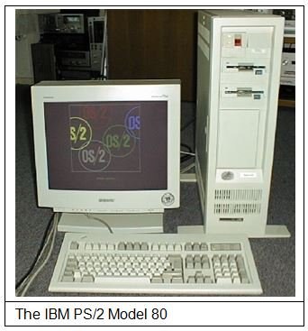

In 1987 IBM introduced a new standard for personal computers. While the ISA standard remained standard on most of the PC sold at that time, IBM introduced its line IBM PS/2 computer, boasting a new bus architecture known as Micro Channel Architecture, or MCA. MCA improved several aspects of configuration that was somewhat tedious before MCA came along. These included sharing interrupt lines and easier configuration of the adapters by using configuration files.

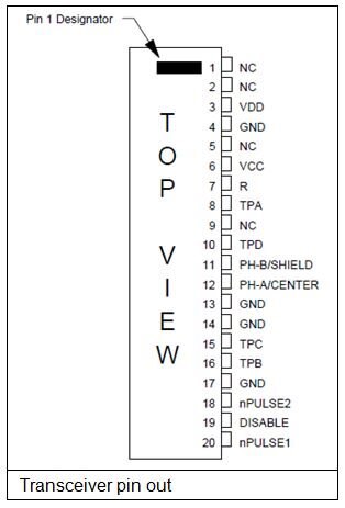

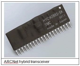

The ARCNet HIT (High Impedance Transceiver) had to be placed as close to the media as possible to minimize crosstalk from the other control and data signals. The PCB layout engineer found that component placing was also critical. The HIT had to be as close as possible to the rear bracket while components that were connected directly to the MCA slot had to be as close as possible to the slot.
The HIT was a modular component responsible for placing the data signals directly on the cable, or in other words, the implementation of the Physical layer of the OSI Model. The theoretical concept of the HIT was its support for different media types, depending on the vendor and model of this component. The pin out was standardized so that the designer could use any of the available HITs available using the same PCB layout.

This is where the greatest flaw was discovered. For some reason the pin out of the HIT was reversed! The executives were not happy. We had limited time to have the prototypes corrected and the PCBs redone. We started an emergency investigation to determine what went wrong. This did not take long. The pin out information on the datasheet was wrong. Although the development team explained the findings to the executives (CEO and CTO), they did not find this flaw excusable. They mentioned that it was not possible for such a basic error to have happened when the company was already producing a fully functional ISA ARCNet adapter; however, there was one aspect that had not been taken into consideration.
While the company had been producing an ARCNet adapter, the original design and PCB trace routing had been done by a third party. When the company decided to do it in-house, the layout engineer received the necessary file to import into the CAD software. He had basically redesigned the PCB, but using previously existing “net” information that contained all the connections for the adapter. On the other hand, the ARCNet adapter for MCA had been designed from scratch. The most basic information that the development team had for the design was the datasheets.
The Workaround
While the executives were not happy, there was a simple workaround to the problem. The HIT could simply be installed on the solder side of the adapter. While this was an ugly solution, it allowed the project to continue and not be bogged down another 2 to 4 weeks waiting for another batch of PCBs to be made. No one was happy with this solution because the company wanted the prototypes to be as presentable as possible for the NetWorld ’87 event that was coming up in a few weeks.

CODENOLL’s product at least addressed the speed limitation. They were at the show promoting and lending out samples of their fiber optic HIT module; however, it was not possible for the other vendors to swap out the HIT already in place. But, with the presence of the electronics design engineer at the show, he said that he could indeed swap out the coax HIT and replace it with CODENOLL’s product. As he installed the HIT he noticed that it was at least double the height of the coax HIT. As he popped the adapter back into the computer everyone noticed something incredible.
The additional height of the CODENOLL HIT did not allow the adapter to be installed back in the PC if the pin out had not been reversed. The only way that the adapter could be installed was if the CODENOLL product was on the solder side of the board, which it was!
