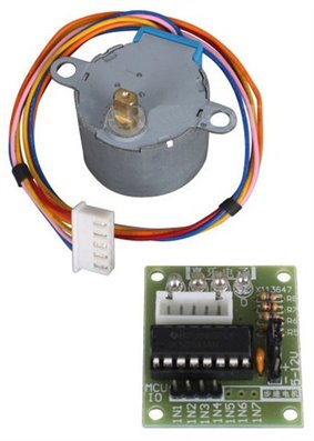

The 28BYJ-48 stepper motor with a ULN2003 driver board is readily and cheaply available on eBay. With nothing special in mind, other than curiosity,  I bought one and had a quick play with it, using the standard Arduino Stepper library.
I managed to do little more than demonstrate that I could make the motor rotate, before I had to put it on one side because of other demands on my time..
Moving on several months to Christmas, my wife bought me a Lego Technic kit  as a joke present - she may come to regret that joke ! As an ex-Meccano builder I was fascinated by the different approach needed for Lego Technic and soon became interested in motorising the kit. and possibly having Arduino control. Lego motors seemed a bit pricey so I thought about using the 28BYJ-48. A quick Google search brought up a number of postings showing how various motors had been "legoised", so I "legoised" my 28BYJ-48 - it's quite easy!
When I started to play with some of the example sketches from the standard Stepper library, I soon realised that they didn't drive the 28BYJ-48 properly, so I Googled again and came up with several links, including this excellent posting:
    http://42bots.com/tutorials/28byj-48-stepper-motor-with-uln2003-driver-and-arduino-uno/
The author - Stan - has written a brilliant article, which explains everything perfectly and also provides the link to the AccelStepper library, developed and supported by Mike McCauley :
      http://www.airspayce.com/mikem/arduino/AccelStepper/
The crucial things I learned from Stan's posting were:
  1. The 28BYJ-48 needs to be operated in half-step mode, ie an 8 pulse sequence - the standard Arduino Stepper library can't do this.
  2. The 28BYJ-48 coils need to be energised in the pin sequence 1,3,2,4, rather than the standard 1,2,3,4 sequence
Below is a simple sketch, based on one of the examples provided by Mike Mcauley and adapted by Stan and then by me, for the 28BYJ-48, to demonstrate some of the features of the AccelStepper library.
During Setup, the initial parameters of the motor (maximum speed, acceleration and (final)speed) are set up, together with an instruction to move the number of steps defined by integer variable endpoint ie 1024 or approximately 1/4 revolution, in a clockwise direction, because endpoint is positive.
(see Stan's article for further information about the 28BYJ-48 step angle and gearing, which results in 4076 steps for a full revolution, instead of the expected 4096 steps.)
