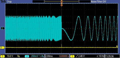

Here's what I see at the input to the filter:
The trigger point in the centre is at the transition from 20kHz back to 20Hz. The waveform to the left

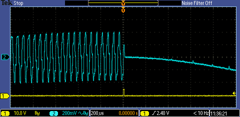

of that point looks really ragged, but it's [mostly] what it should be. If I go in closer we see this:
The raggedness is down to the steps from the 100ksps sampling and is the reason why we need the filtering. The
good news is that the amplitude is maintained to 20kHz, so the falloff I was seeing in the previous
blog is coming from the filter and not the initial gain [really, attenuation] stage.

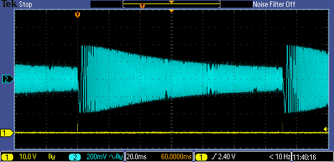

Here's the output from the filter:
here we can see that the response is rolling off from a couple of kilohertz and not the 20kHz
that it was meant to be. That might be me getting component values wrong or it could be the very
limited open loop gain that is available from the LM324 at those frequencies (as Gene usefully
pointed out in the comments to the previous blog).

    jc2048 over 8 years ago in reply to genebren +2
    The filter circuit was in this blog: Arduino: R-2R: Buffer, Attenuate, and Filter I can see a mistake in my build. I didn't have a 820p capacitor so decided to make it from a 1.5n and 1.8n in series, both…
    I can see a mistake in my build. I didn't have a 820p capacitor so decided to make it from a 1.5n and 1.8n in series, both of which I did have. Fairly predictably, by the time I came to build it I misremembered and put them in parallel, so I've got 3.3n in there. That will be some or all of the problem - I'll rectify that and see what happens.
    genebren over 8 years ago
    Jon,
    That is really rolling off soon (<1KHz).  So how is that final stage wired?
    Gene
