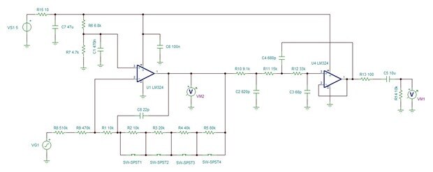

Here's the circuit as I have it at the moment (the voltage generator on the left is the output of the DAC):
The first bad decision I made was to keep it as simple as possible and use the Arduino +5V for the
supply and to use a very cheap op-amp, the LM324 for the circuit. There's nothing essentially wrong
with the LM324, but the inputs and outputs don't operate up to the rail so that immediately stops me
from buffering the output of the R-2R DAC with a follower. So, instead, the buffer became an inverting
amplifier with fractional gain. That compromises the input resistance a bit, but it's still high
enough that it doesn't load the DAC and affect the resolution. Originally, I was going to have the
variable attenuation after the filter, but realised that I could change the gain of this amplifier
instead and came up with the circuit above where gain resistors are selectively shorted by analogue
switches (the switches on the circuit diagram are really CD4066 analogue switches controlled by A0 to
A3 used as digital outputs).

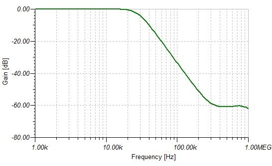

The righthand side is a low-pass filter with the cut-off point somewhere around 20kHz. It's a third-
order low-pass Butterworth filter. The response looks like this in the simulator.

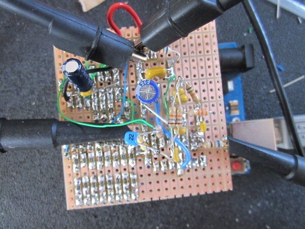

Here's how the circuit board looks at the moment - the chips are underneath and the passives on top. A
bit unconventional but it's quite easy to work with, changing and adding bits. (The R-2R DAC is the neat array
at bottom left, the analogue switches are top left, and the op-amps are bottom right).
Unfortunately, when I came to test it, I discovered that the first op-amp was more than happy to
oscillate. I think the reasons for that are twofold - firstly that it was impossible to get the
feedback path compact because of it straggling all around the analogue switch chip and secondly
because the analogue switches add parasitic capacitance (which I'm obviously not modelling in the
simulation). I managed to quieten it down by adding the 22p; that adds to the internal compensation,
but it's still a bit on edge.

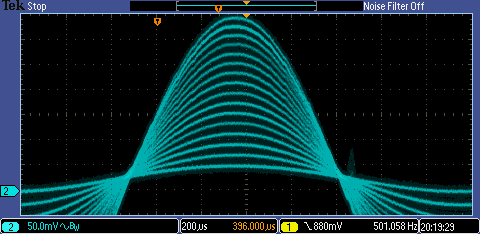

Here's an accumulated scope trace that shows the sixteen different gain levels. This is with the
scope's 20MHz filter on (there's quite a lot of high-frequency noise that the output filter doesn't
stop). It works, but if you look just after the point where the traces come together, there's evidence
that the op-amp is on edge and only just holding it.

    How did you make the scope trace? looping fast trhrough the 16 levels?

    jc2048 over 8 years ago in reply to Jan Cumps
    No, looping slowly. The processor does 100 cycles and then steps to the next level. The scope has the persistance set to ten seconds, or something like that.
    I like it as a display - it makes me think of some fabulous monster from an uncharted ocean.
    One other thing it tells me, aside from the question mark over the stability, is that the sine wave is distorting. The traces are taken from the ac coupled output so should average to zero yet you can see that the crossing point is above zero.
