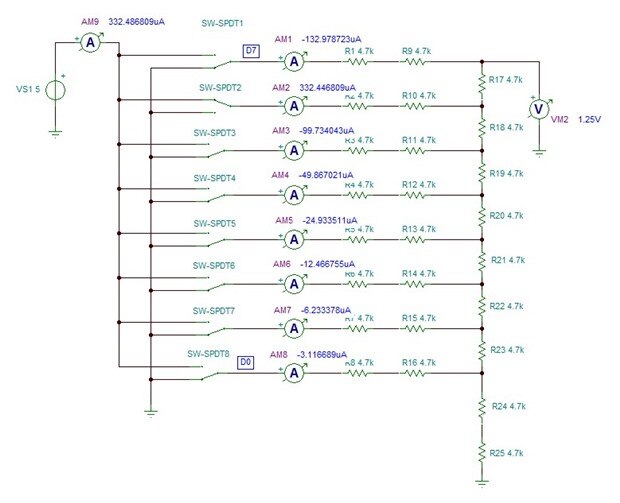

The network looks like this. This is from the simulator and shows the results of the DC
analysis (the MOSFETs in the processor are replaced with switches - I did that just to get
a feel for what it was doing - the switch settings here are for an output of 0x40).

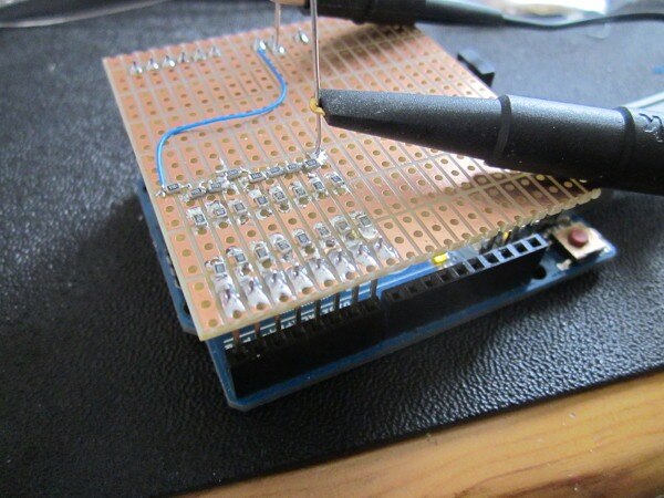

I built it on a piece of tri-pad board (it's like stripboard, but the strips are cut every
3 holes). I used 4.7k 0805 surface-mount resistors. They were 1% resistors, but they came
from the same reel and matched each other better than that (I made the 2R resistors from
two in series so that the close matching would apply between the R and 2R ones as well).
Here's a photo of the board plugged into a Uno.

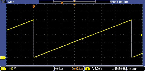

The initial sketch I used is very simple. It just increments a value that gets written to
the output port and produces a ramp from 0V to 5V. [This DAC doesn't have a reference;
instead it's ratiometric and gives us a proportion of the supply voltage. That can be a
good thing or a bad thing, depending on what we want to do with it.]
/* AD Test
unsigned char outputValue = 0;             // output value
const long interval = 4;           // interval at which to step (milliseconds)
void setup() {
  // set the digital pin as output:
  pinMode(0, OUTPUT);
  pinMode(1, OUTPUT);
  pinMode(2, OUTPUT);
  pinMode(3, OUTPUT);
  pinMode(4, OUTPUT);
  pinMode(5, OUTPUT);
  pinMode(6, OUTPUT);
  pinMode(7, OUTPUT);
void loop() {
    outputValue = outputValue + 1;
    PORTD = outputValue;

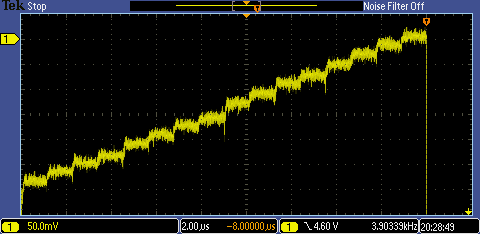

Here it is on the scope. The only load here is the input impedance of the x10 probe (10M
and about 12pF). We'll come back to the issue of the load in a moment.
It's looking promising - that's quite a reasonable ramp.

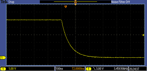

Next is the fall from 5V to 0V at the end of the ramp. It's almost a pure CR
characteristic, with the resistance from the ladder and the capacitance from the probe:

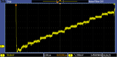

This next one shows the steps at the bottom end. They are a bit uneven, but it's not bad
for 1% resistors.

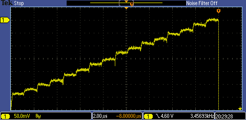

Here's the top end (there's a 5V offset on the trace, so the marker is at 5V, not 0V):
and here it is again with the scope's 20MHz bandwidth filter on:

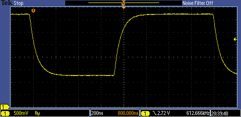

I then adapted the sketch to step up and down between 0x40 and 0xBF. That's a quarter to
threequarters of fullscale, with every bit in the word changing. The incrementing variable
that you can see in the sketch is just to waste a little time and roughly balance the time
spent doing the loop (I had to mark it as being volatile to stop the compiler 'helpfully'
removing it). That looks good. It's a bit better than you could do by filtering
PWM - it settles in about 500nS!
