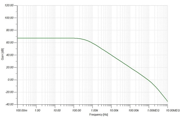

    The problem with the frequency roll off at 20Khz may be more a question of your op-amp as opposed to your filter.  The LM324 has a gain bandwidth of 1.3Mz and the gain rolls off to ~30% of the total gain at 20KHz.
    Gene
  • jc2048
    jc2048 over 8 years ago in reply to genebren
    Thanks for the comment. It may be worse than that - the simulation model gives this curve for the open-loop gain on +5V.
    So it looks like they think that the worst case for the GBP is 900kHz and the gain at 20kHz could be as little as 48 (33.6dB).
    I probably shouldn't have used the LM324, but I didn't want to get diverted into generating supply rails and I wanted to try and make something work using parts that were very cheap and readily available.
    I still think that the problem is mainly with the first stage, though. The chain of analog switches in the feedback path, the messy layout, and the fact that I had to slug the amplifier with an external capacitor to keep it quiet have probably done for the high end response.
    It is an interesting question with blogs like this. Do I have a responsibility to show good design practice or can I just mess about slapping things together, like I have here, and exploring what happens?

    The TI datasheet is interesting.
    The table for +5V supply implies that the dc gain is 100dB but the simulation model shows that it isn't by a wide margin. They've carefully annotated the gain as being for a test voltage of +15V, so strictly the datasheet is true, but I'd say it's a bit sneaky. Caveat emptor! as the old Roman analogue design engineers used to say.
