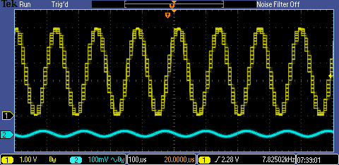

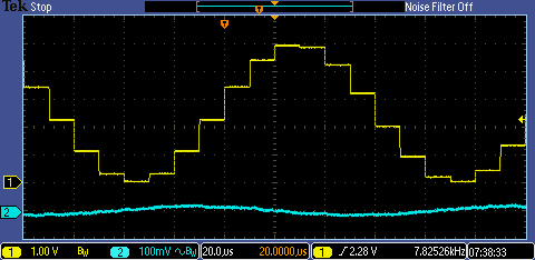

Here's the DAC output on the 'scope. You can see the samples coming out at 10uS intervals, so I must have got the timer
set-up code right.
Below is another view where you can see several cycles - because the step value in this case doesn't have a simple
relationship to the cycle, the samples are different for each cycle, but when filtered they'll give the frequency that we
want.

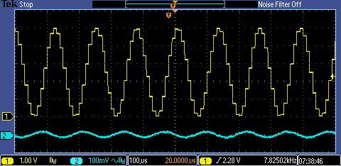

Finally, here's an interesting trace - this is the previous one accumulated. This one shows that, though the step isn't a
simple divion of the table size, it does repeat after a few cycles. (The filtered waveform is blurred because the trigger
is on the 10uS steps of the yellow trace which don't have a simple relationship to the frequency generated.)
