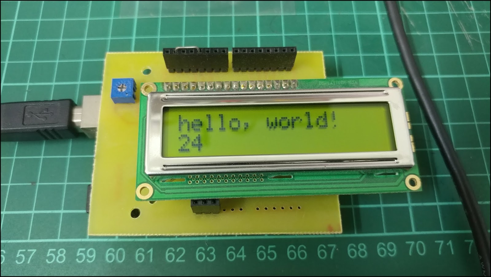

The front view of the board
The rear view of the board
Next, we shall see the shield in action.

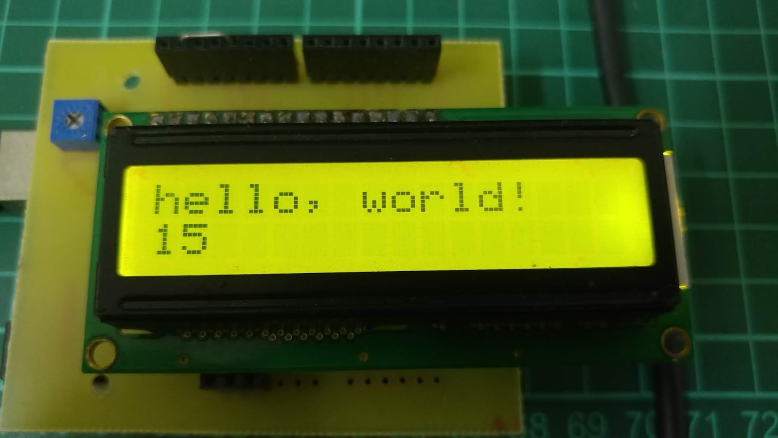

The image below shows the LCD 16x2 testing

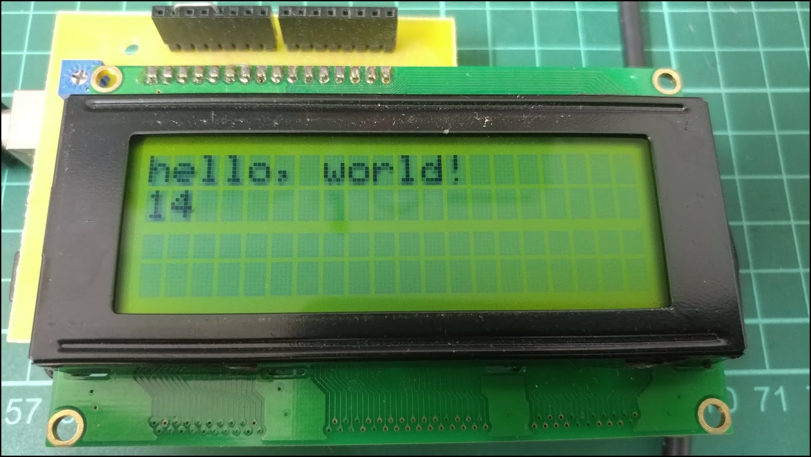

And below is the test which I conducted using LCD 20x4.
Both of the test was successful.
