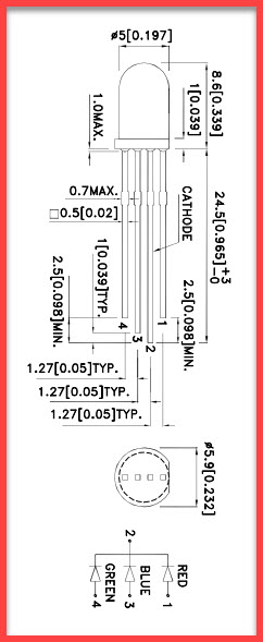

Basically, an RGB LED is no difference from the normal LED, except that it has an addition of two more pins. And obviously, the internal structure is of difference from the common LED. Below is the image of the RGB LED.
RGB LED
Image extracted from Kingbright Datasheet. Credit to Kingbright.
Referring to the image above. we can see that there are 4 pins. Pin no 2 is the common cathode pin, Pin no 4 is for the GREEN, Pin 3 for BLUE and Pin 1 is for RED. These are the 3 main colours available from the RGB LED. We achieve or get other different colours by combining these 3 colours. The diagram below the colour combination.
