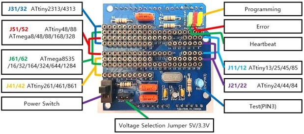

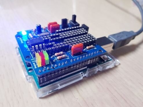

I’m back with my “ATmega/ATtiny Microcontroller Programming Shield for Arduino As ISP R2”.
This is a slightly enhanced version of R1 which I’ve been using for programming microcontrollers for long time.
I’m now able to program most of all major DIP type ATmega/ATtiny microcontrollers with it.
As I’ve mentioned on my previous posting about R1, I’ll share its details.

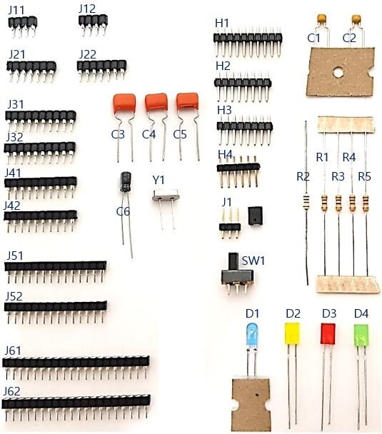

Please find the BOM here first. I’ll also post the schematic, PCB design, usage & so on next.

PCB
R2
Custom
1
NA
Please see my other postings for more information.
