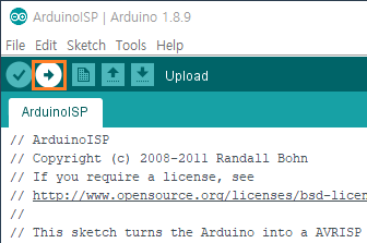

1) Arduino as ISP:
  • If you have an Arduino compatible board, you can simply turn the board into a programmer just by loading a sketch ‘ArduinoISP’.
  • To do so, get your Arduino connected to your PC using its USB cable first.

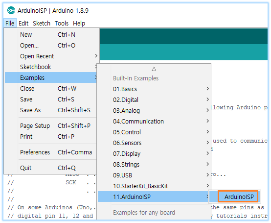

  • Run Arduino IDE on your PC and open the sketch under File > Examples > 11. ArduinoISP > ArduinoISP.
  • Click on 'Upload' button to get the sketch compilied and uploaded to your Arduino.

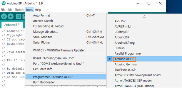

  • If the sketch is loaded with no error, your Arduino is now a programmer ‘Arduino As ISP’!
  • To be able to program your microcontrollers using it, choose the programmer under Tools > Programmer: > Arduino as ISP. Do Not Choose ‘ArduinoISP’.

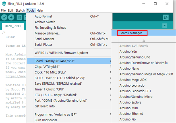

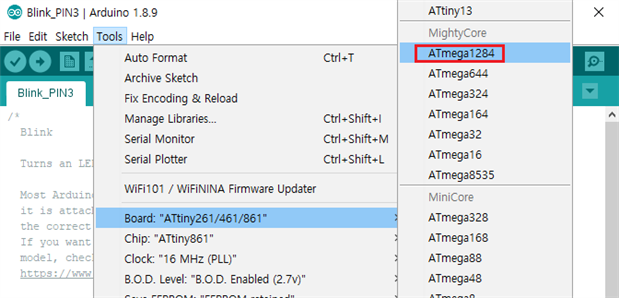

  • If you can’t find your target microcontroller from the list under Tools > Board:, You need to install some Boards Managers to your Arduino IDE.

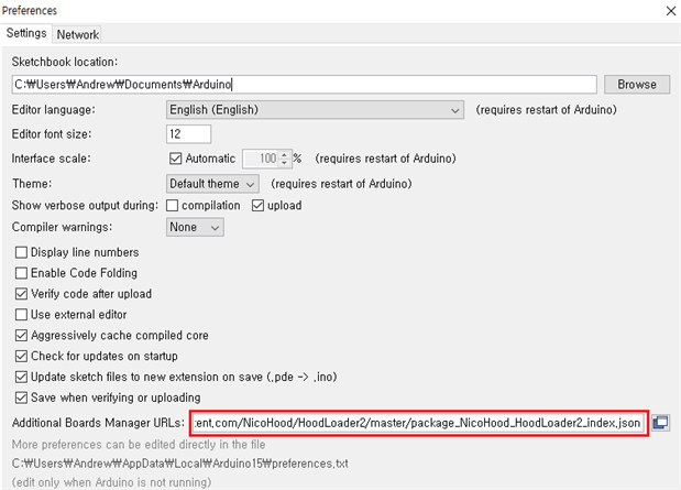

  • To install them, go to Files > Preferences and copy following URLs.
MicroCore : https://mcudude.github.io/MicroCore/package_MCUdude_MicroCore_index.json
MiniCore : https://mcudude.github.io/MiniCore/package_MCUdude_MiniCore_index.json
MightyCore : https://mcudude.github.io/MightyCore/package_MCUdude_MightyCore_index.json
ATTinyCore: http://drazzy.com/package_drazzy.com_index.json
  • Paste them in Additional Boards Manager URLs: and click 'OK'. You can add more than 2 URLs bt using ','.

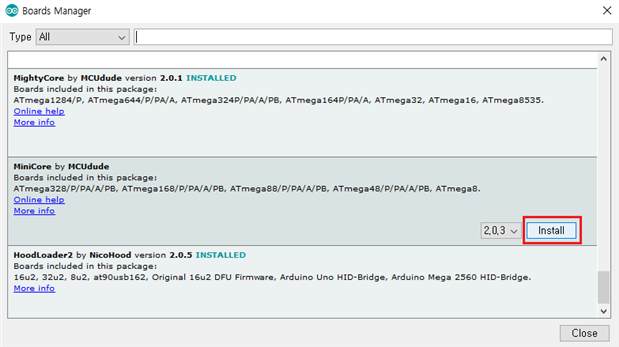

  • Go to Tools > Board: > Boards Managers.
  • Wait a moment to get the list of Boards Managers loaded, find a Boards Manager to install and click 'Install' to get it installed. After installing all Boards Managers required, click 'Close'.
  • You should now be able to find your microcontrollers from Tools > Board:.

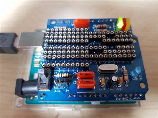

3) Hardware
  • This is the easiest part of the preparation.
  • Turn the R2’s power off before placing it on your Arduino.
  • Gently plug the R2’s male header pins in the Arduino’s female headers.
  • If nothing goes wrong, Heartbeat(Green) will slowly blink even if the R2 is still powered off.
You are now ready to start programming!!
