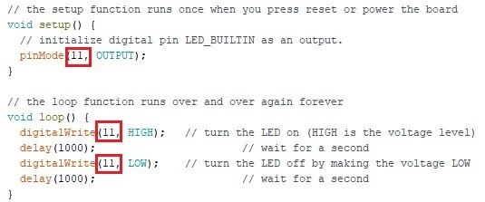

You may just modify the source code of Blink sketch to test the alternative pinouts as shown below.
- ATtiny24/44/84
This microcontroller’s default pinout is Clockwise but you may also choose Counterclockwise when you burn bootloader.
In this case, you should change the pin numbers in the sketch from 3 to 7.
- ATmega8535/16/32/164/324/644/1284
You can choose other pinouts than Standard pinout for this microcontroller. Standard pinout’s and Sanguino pinout’s D03 are mapped to the same physical pin #4 of the microcontroller but Bobuino pinout’s D03 is mapped to pin #17 where D11 of other pinouts are mapped to.
You should change the pin numbers in the sketch to 11 In this case.
