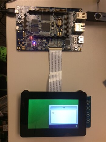

Here's what it looks like:
The image that I used was the "atmel-qt4e-demo-image" that i built earlier.

    What is the display you used?
    Clem

  • pettitda
    pettitda over 10 years ago in reply to clem57
    It's a PDA TM4301.
